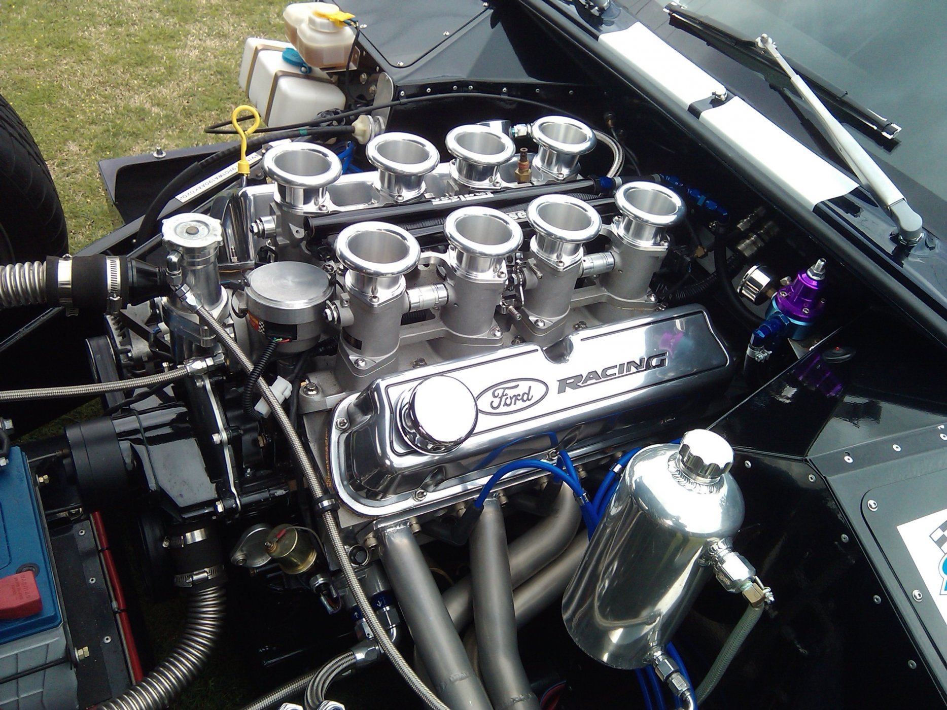

I have successfully used a couple of the Speed Master systems on a couple of customers Cobras. These are a Chinese manufactured knock off of the Inglese / Borla inside mounted fuel rail systems. They work OK but quality can vary batch to batch so you have to be careful.
I had an Inglese / Borla system on my old Daytona coupe and to be honest it was not a huge amount better than the Speed Master unit. Particularly given the significant $$ difference.

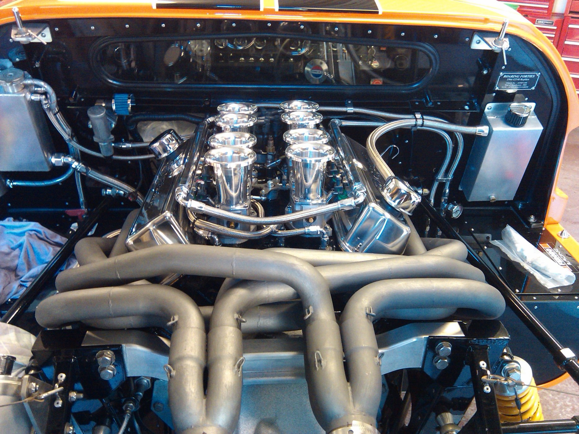

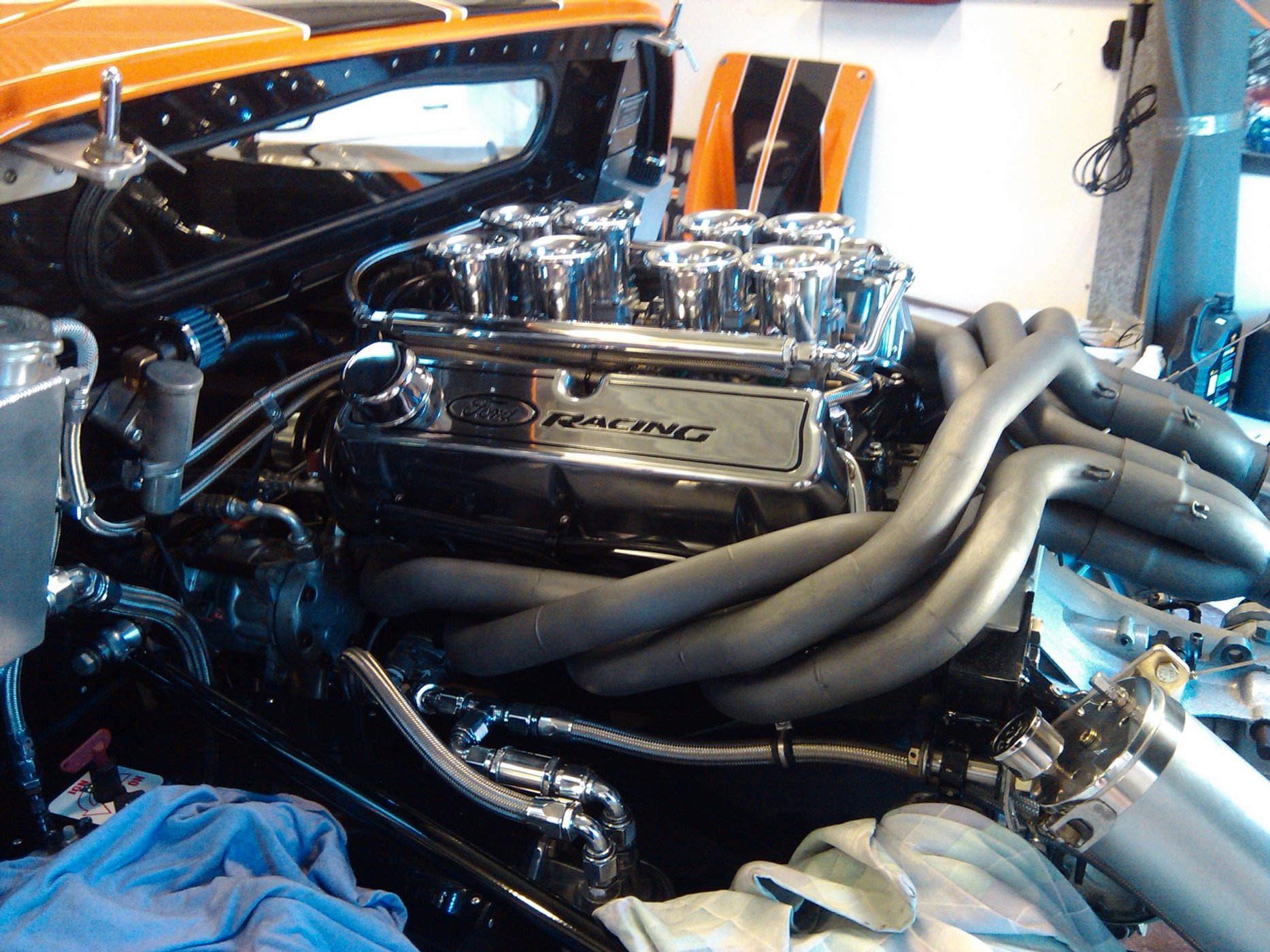

My GT40 has a DC&O unit and has been faultless since i installed 14 odd years ago. Inside mounted rails weren't available way back when I set it up and it is not as nice from an emissions point of view, but it has served really well and is sure as heck heaps easier to work on without the rails obstructing the cable pulley and linkages, etc, when it comes to balancing the system.

Looks awesome!

Looks awesome!

The DC&O trumpets seem to fit really low compared to the speedmaster/borla in the cobra. What are the two engines? Both 302 based?

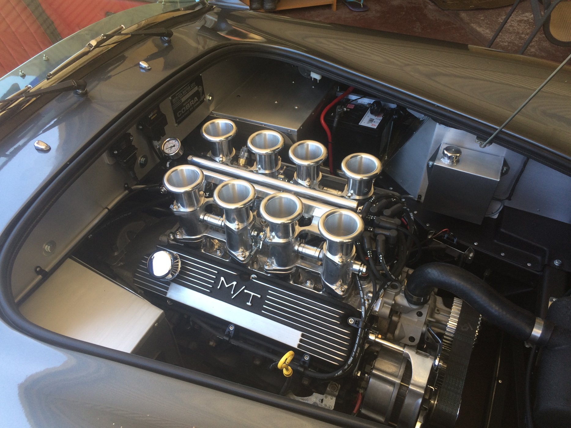

All motors are 302 based. The Cobra photo is the speed master, the attached here is the Inglese / Borla unit

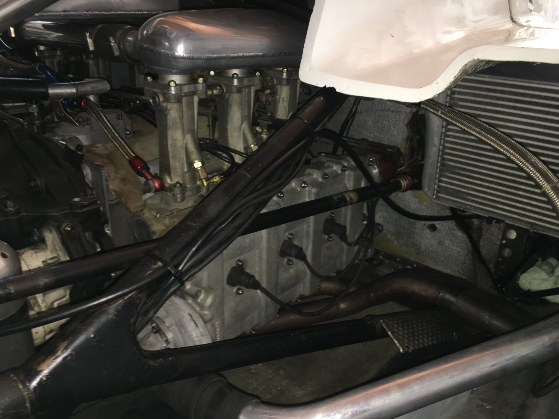

Peter, It almost looks like that intake can be mounted up the other way so the injection is down flow (IE injecting above and into the butterfly) my supervee kugelfischer mechanical injection is similar with injectors before butterfly (pointing in flow direction)
