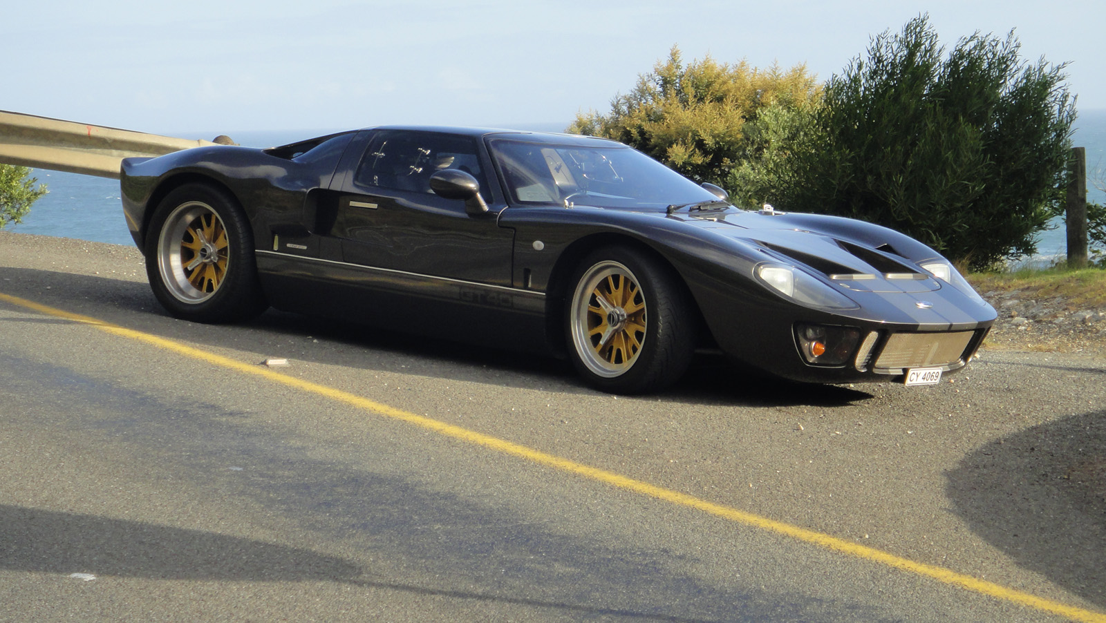

Hi George
I hope it is my CAV you are talking about!:uneasy: When I started my build I wanted a car that kept the nostalgics of the original GT40 but had some modern finishes. That is why I bonded all my windows, installed modern mirrors, modern stearing wheel, made the instrument faces white and put some chrome finishes to the car. I always said that it must never look like a "kit car" and I think I kinda suceeded in doing that. I will not go bigger than 17" though...but if you do, then go chrome with spinners!:laugh:

Thats the car Johan! It is your car that inspired me to make the 40 look exotic. I still think the other wheels you had worked better. There is nothing yellow on your car except these new wheels, kinda odd. What size wheels/tires you running rear/front? 17x? If I do go 18 or 19 I will make sure to get the nice flat chrome dishes that have plenty BLING. :lol:

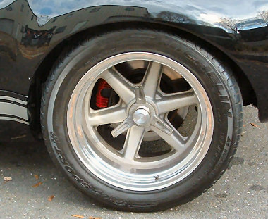

Here is a pretty good pic of the RF I mentioned...

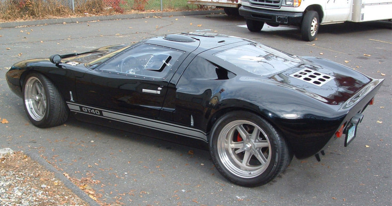

i have 17" wheels 335/35r17 on the rear 245/35 r17 front. I like the look

Thanks Troy for the picture. A side angle would help more!
Chris, thanks for that :laugh:. Seems the 18" wheels troy posted look too big on the GT40. The 17s seem to fit a lot better for that profile of car.
Thanks Loyd, looks good.

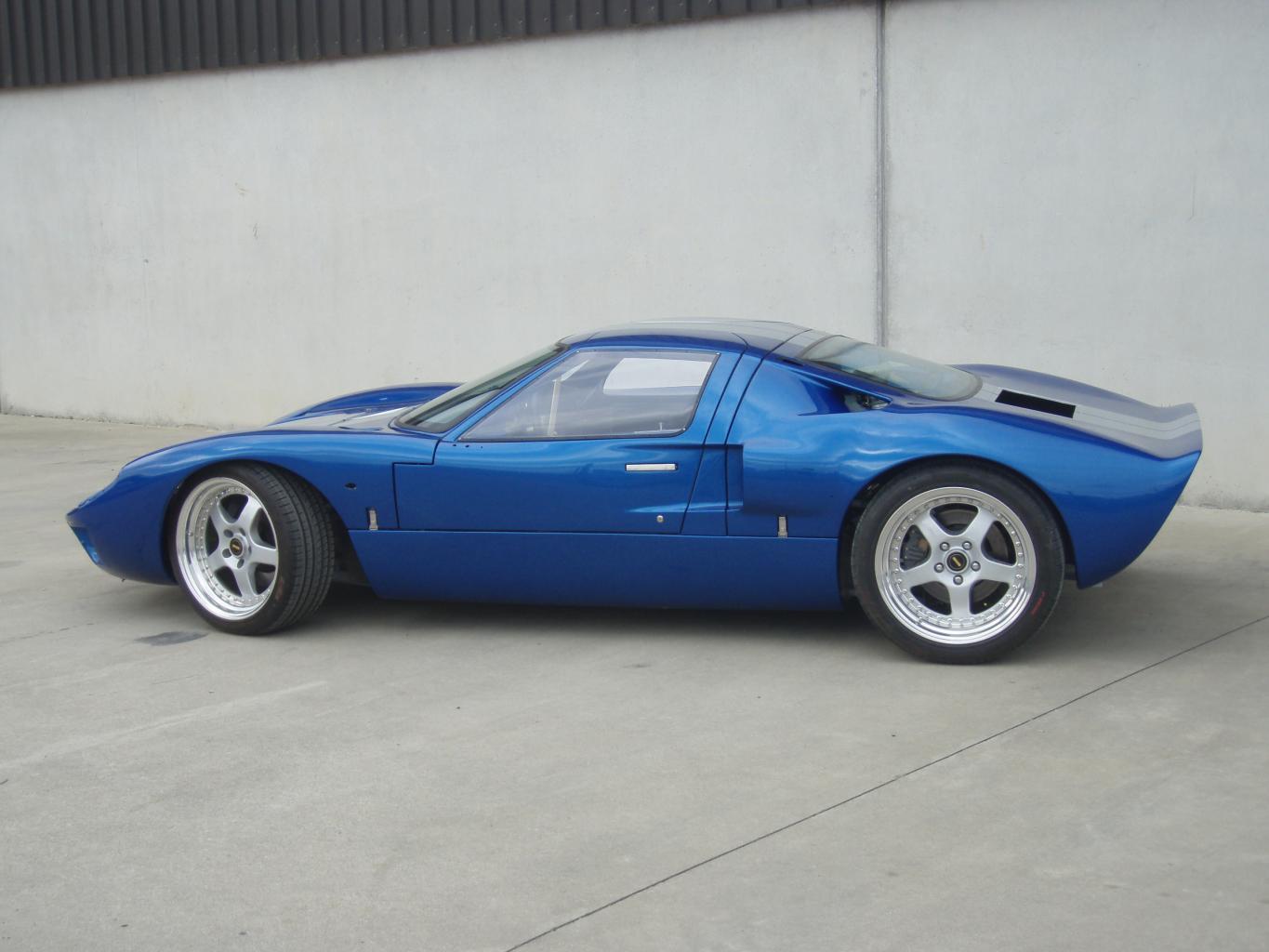

here is my car on 18"' wheels 295/35/18 rears and 225/40/18 fronts.hope this is of some
use,Simmonds by the way
cheers Ali

Thanks. 18s seem to look a little too large up front, not bad in the rear though.Very nice blue you got there Ali.
Seems 19" will look out of whack.
