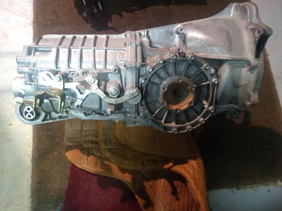

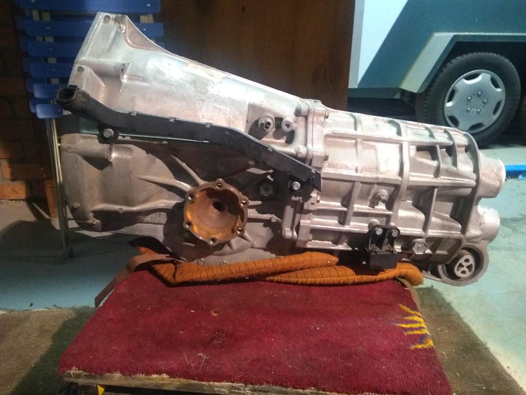

I've bought a g97 porsche box, and radiator.

P.S: does anyone no the bolt pattern of the g97 box???

I've spoken to Chris. Unfortunately he doesn't have the patterns for the g97 so I'm working on that at the moment, and I'll get onto determine the patterns soon.

Ultima Sports do an adaptor for that configuration.
Starter is on engine side, Porsche bell housing is smaller than the LS so there is a bit involved.

Yeah there's a fair bit involved as I've realised, started getting ready to start making the adapter, but if Ultima do the job, might save me a few head aches:shy::shy::shy:

I would check to see how different it is from the other Porsche and Audi boxes. you may find that something else fits 90% of the bolt holes and you only need to drill and tap a few extra.

G'day Ryan,
I know it's different to the audi boxes,
how ever I was gonna see if the four bolt holes on the g50 box coincide with any four on my g97 box. Wish me luck!!!

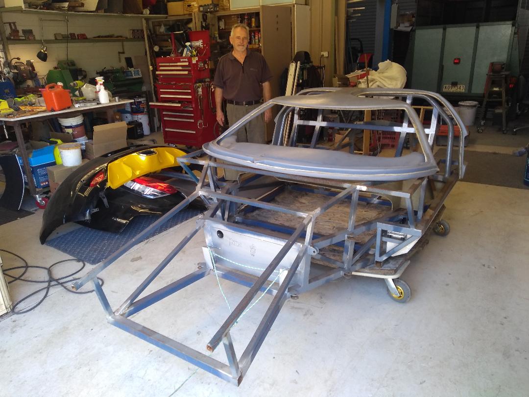

What kind of gt40 are you going to build tube frame , mono ?
What kind of gt40?

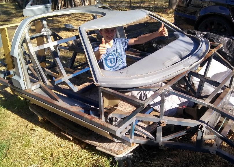

At the moment it's in my head (it's not a kit or brand).The chassis and bodies were built by a group of 10 guys.
I'm aiming for it to look (exterior) as period correct as possible, while underneath it's going to include some pretty modern tech. I'm really interested in suspension design, and that's what I like, so one of the unchangeable credentials of this car is that it is going to have completely new suspension design (push-rod suspension and other goodies)
Definitely tube frame.
It's just not cost effective enough to build a tub and I've gotta few trick things in mind for the suspension which are not easily possible/effective with a tub.
I'll chuck up some pictures when I figure out how......

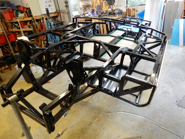

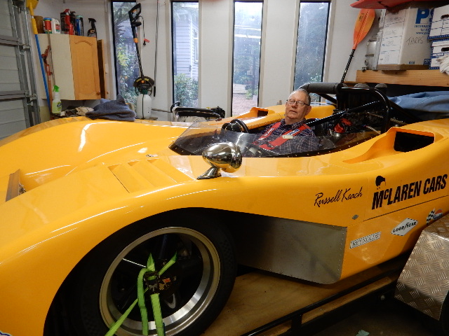

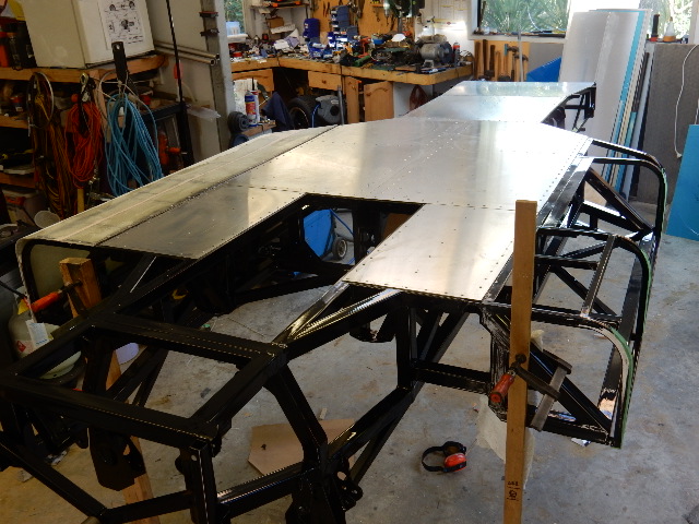

I used that same / similar chassis design in the road going Mclaren M8B that I am building, (my 3rd Mclaren). I had to make some changes around the front due to the larger air exhaust from the radiator and the overall chassis width. This car is running a Toyota 1UZ on an Audi 012 transaxel. Great to see you taking on such a project.

Geez that looks stunning Russel!!!
Always been a huge fan of the McLaren Can-Am cars, let me know if you got any left over parts you want to sell, as I'm trying to stock pile parts in the next month or two to help get this build underway.
Is it going to be a track beast or a road car?
