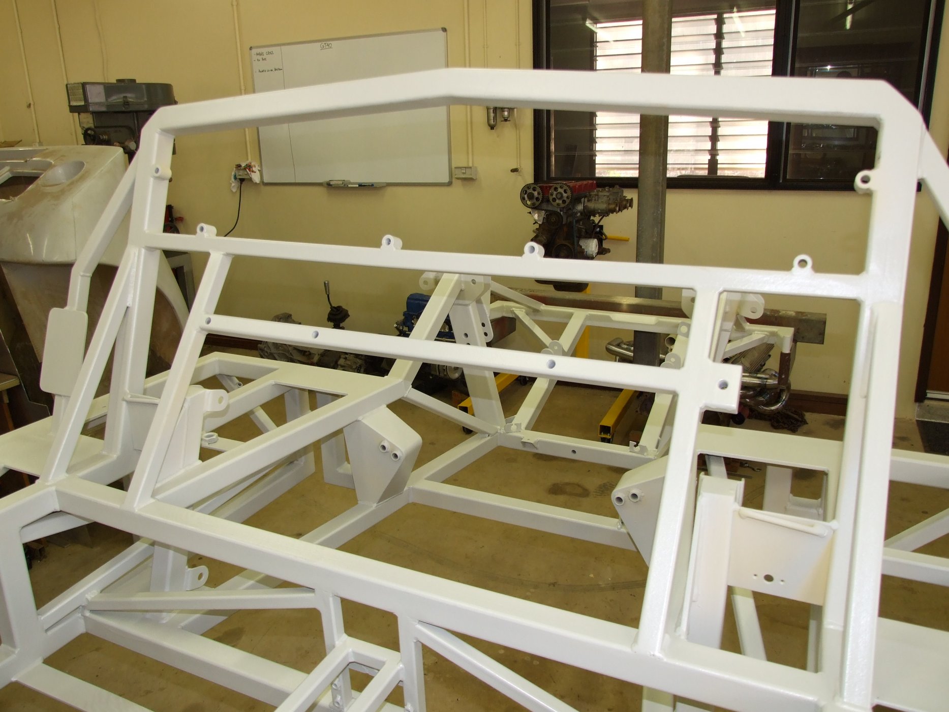

I’m having trouble finding suitable Australian compliant seatbelts for my DRB, although I assume the problem applies to all GT40s here.
The ones I have require mounting vertically, which makes them stick out from the bulkhead way too far and look ridiculous. Securon 264 are suggested, as they have adjustable angle fitting and will lay flat on the bulkhead, however, they don’t have Australian compliance. Klippan don’t seem to offer a suitable alternative either. I’m not wanting to use harnesses at this stage.

I ended up cutting the angled bracket out and welding in a vertical plate to suit the Klippan units.
Not sure if your chassis will accept that change.

Have a look at the seat belt in the rear seat of a commodore wagon around 2000 to 2009 ish. The seat lays back at about the same angle as the DRB mounts, I fitted these to my DRB then just had to buy some longer stalks for them to click into.

Not sure why Lance's is having issues, my chassis was the second last made & has a recess for the belt reel & all the mounting points threaded.
DRB also supplied as part of the chassis a fiberglass cover panel
Although my chassis did not come with the 4/5 harness mount points as fitted to the earlier models I've seen.
