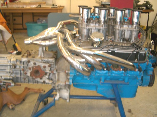

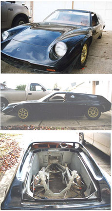

Okay. It's a 47GT which originally had the 2Liter Lucas fuel injected twincam. The current engine/transaxle are from a Lotus 30 and identical to the early GT40s. The swap was made in '69 by an Englishman who wanted to emulate Carroll Shelby.

That's what I like about this site..every once in awhile somebody like you comes along with a real neat project. That is a very rare lotus I believe. It sure looks to be in exellent condition.

That is a very nice engine transaxle combination. Looks to be -1 ZF box with the aluminum GT40 side covers and correct top cover. Its hard to tell from the picture but the bell housing looks to be from a GT40 as well.
Chris Kouba

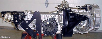

If that pic comes from where I think it does, he seems to be one talented bastard. Just went and scratch-built himself some 962's, apparently with dimensionally interchangeable parts with the originals as well.
Click HERE for his web page.
Chris

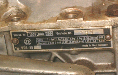

Yes, it is a –1 and the bellhousing has the letters “GT 40” cast inside. The intake is a FoMoCo. I don’t know if you can trace it’s origin from the serial numbers, but I’ll post a pic of the tag. The engine block is not the original.
That is an awesome mod on the ZF, Scott —I’ll try to get in touch! Thanks for the links.
