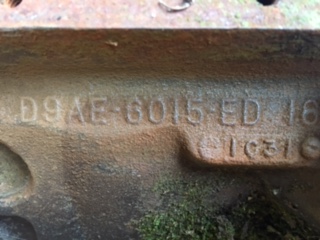

He were getting there with it ,there is 351 in the lifter gallery, only problem is it's been outside left with plugs out ,it's on a standard bore as well ,gutted,never mind a trip to the scrap yard tomorrow unless someone wants a coffee table

Why, 351w blocks are safe to 4.060"" bore, of greater concern would be condition of main bearing bores and camshaft tunnel- both should be OK if it still had crank and bearings installed. The 351w IMHO ( backed up with working on this stuff for 52 years now ) is the single best candidate for a GT40 replica where you simply want an engine that looks right. Only note of caution is avoid the later roller cam blocks, in other words anything with an E--- cast # as the bean counters got to the casting cores. Some of the crap my previous employer imported from USA in 70's had been left outside with heads off and were not pretty, the sort of stuff that still had water marks in bore after bore and hone... trick with them was to do final assy & startup as quickly as possible. Most of the folk on here would be horrified to have a look inside the cylinders of their engines with the amount of time their cars spend sitting idle while they complete the builds, and then many do a delayed first start without pre prime of oil system and shortly after you see a thread ....why did my brand new cam lose a lobe.
