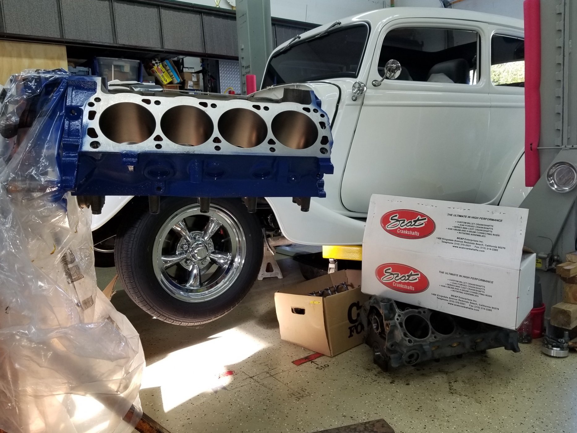

Good machine shops are getting harder to find as the old school machinists you trust with your block age and retire or close up shop. Prices are going to be greatly influenced by location and the amount of work the shop has. It is not uncommon for some shops to increase their hourly rate not only to cover their costs but the act as a hand-on-the-throttle of incoming business. Some will give repeat customers better pricing as well.
I recently had a stock 302 block done and it was just over $600 US.
Operations were -
* Hot Tank to clean it
* Magnaflux the main bearing webs and cylinders
* Sonic test the cylinders for thickness
* Align hone the crank bores
* Deck the block to ensure parallel to crank and at a perfect 90°
* Bore to .030” over size
* Hone to fit the forged pistons I chose after Temperature normalizing. Was done with deck plates.
* Chase all threads to clean
* Rod out all oil galleys
* Debur block edges and bores
* Hone lifter bores
* Hot tank again to remove machine swarf
* Install cam bearings
* Install brass frost plugs
* Oil down machined surfaces
* Bag & Tag
The $600 was a bargain and I gave him a nice tip as well
