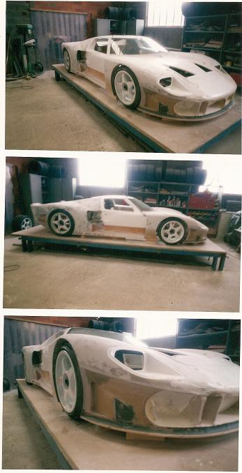

Car one was tubular chassis , fiberglass bodies made on specific mold I did on a Gt 40 intensivly modified ( In 1995 I owned a GT !!)

If you enjoy I can may be find more pics of how I did the master from an GT 40 body?

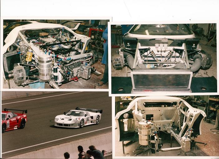

The green metallic on that pic is1995 chassis n°1 rebuilt as "road version" after 3 seasons races in GT French championship and sitting now on the owner driver museum.
These are someold pics of how I started the built of this nice story !!
On the last pics you can see that chassis N° 1 at Le mans 95 prequalification we miss due to a pressure failure on KKK turbo hoses !!!
Thanks for watching !
