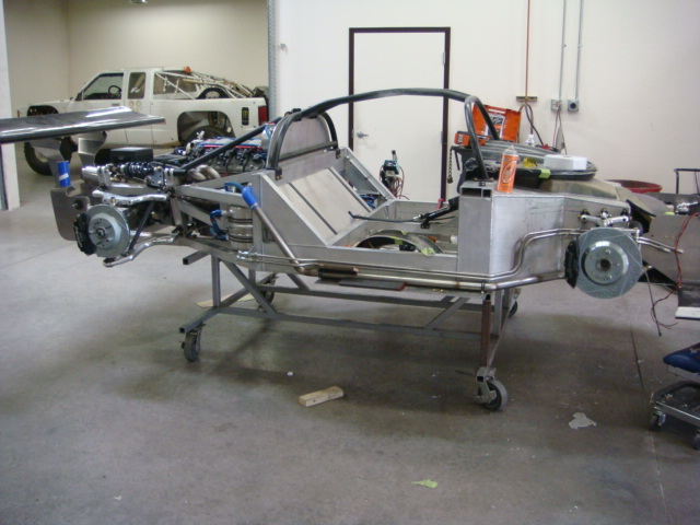

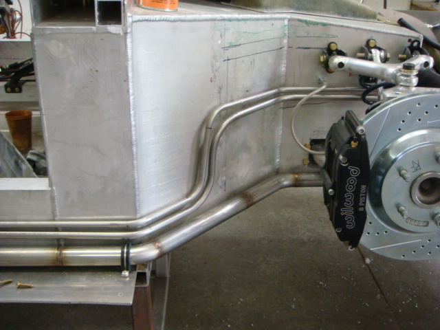

You could try and shim the pads to make up the difference but IMHO you should change to a 1.25 thick two piece quality rotor for track use. See my build thread as it relates to brakes. Lots to consider there.
