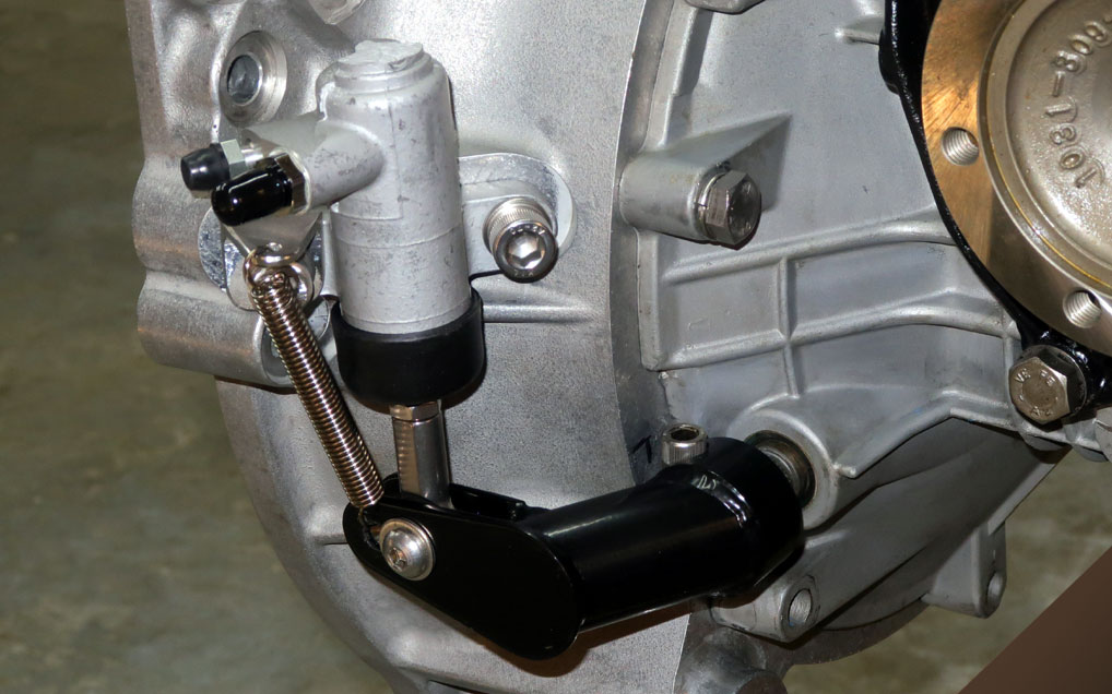

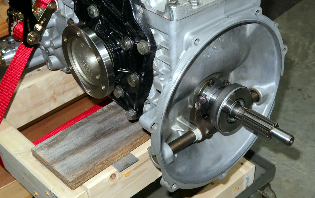

Here's how I set up my clutch release.
Fork and shaft are ZF parts from RBT.
McLeod 16525 Pantera adjustable release bearing and collar.
Girling 64673467 slave cylinder.
Lever arm from Bob Wood at Safir.
Quaife E62G1121 bellhousing.
Bryan, was the Bracket & Return Spring on the Clutch Actuating Arm something you added on your own, or was it purchased from somewhere? I have that same Slave & Arm from Safir but not the Spring & Bracket.
