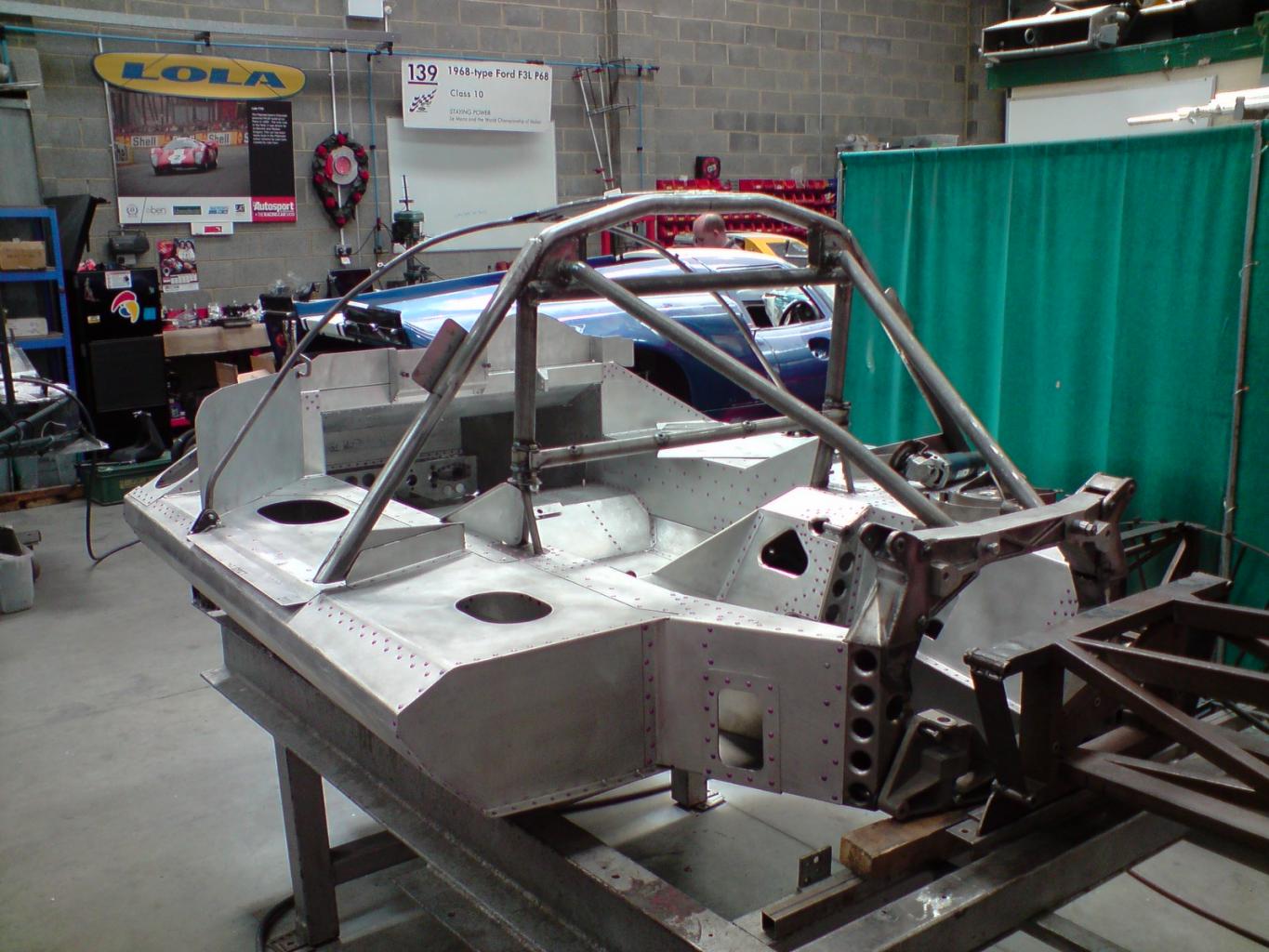

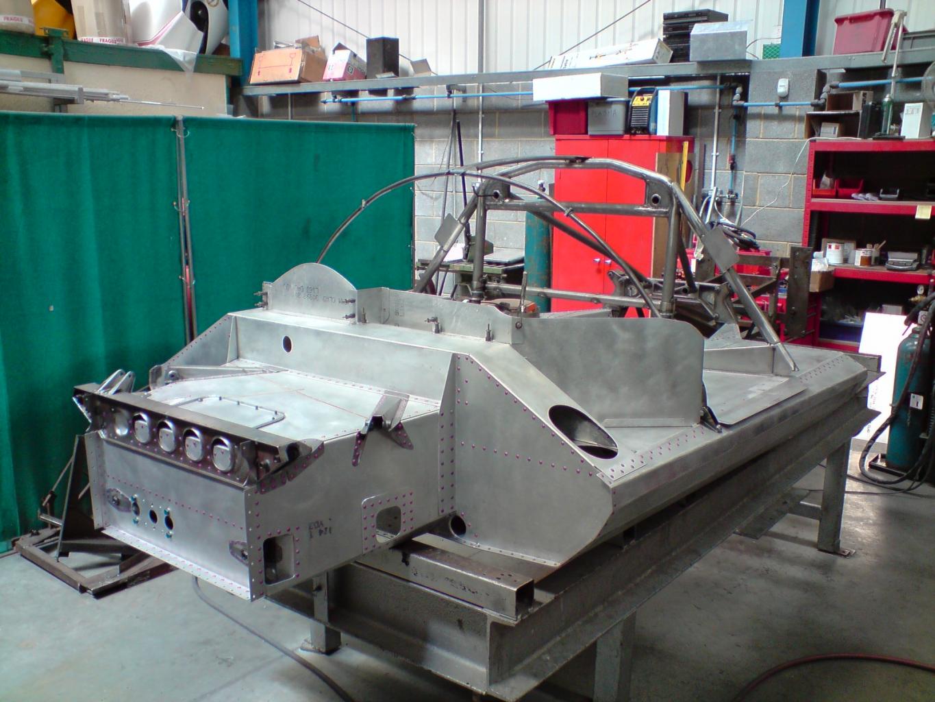

Just for starters, here is a continuation car roll cage "naked" so to speak. I'll have to trawl through my folders to see if I have any close-ups of the various points. The main hoop locates into cups on the radius rod towers and is clamped in by the seat belt bar and radius rod through bolt.The forward part of the cage is just to give stability to the centre section molding and for the door hinges to pick up on.The main cage is bonded into the centre section, then the 2 rear drag links fitted after final assembly. Hope these help.
Darren

Johan & Darren,
Thanks so much again for helping me out. Those pix are a huge help Darren, I couldn't have visualized that quite that way.
