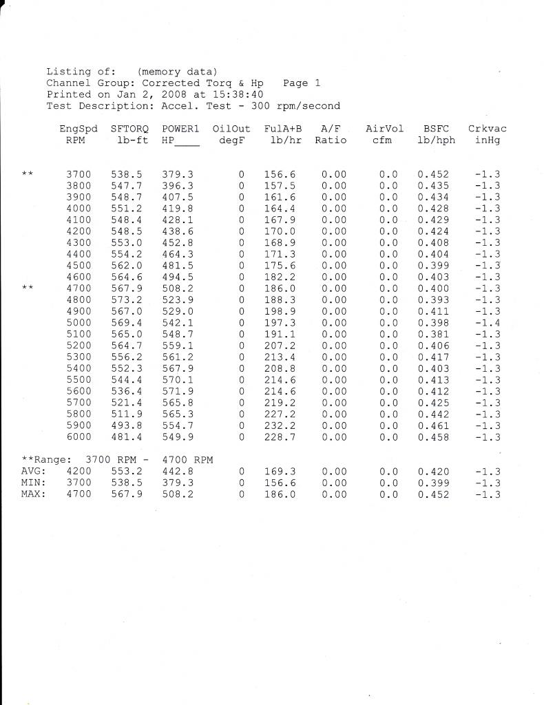

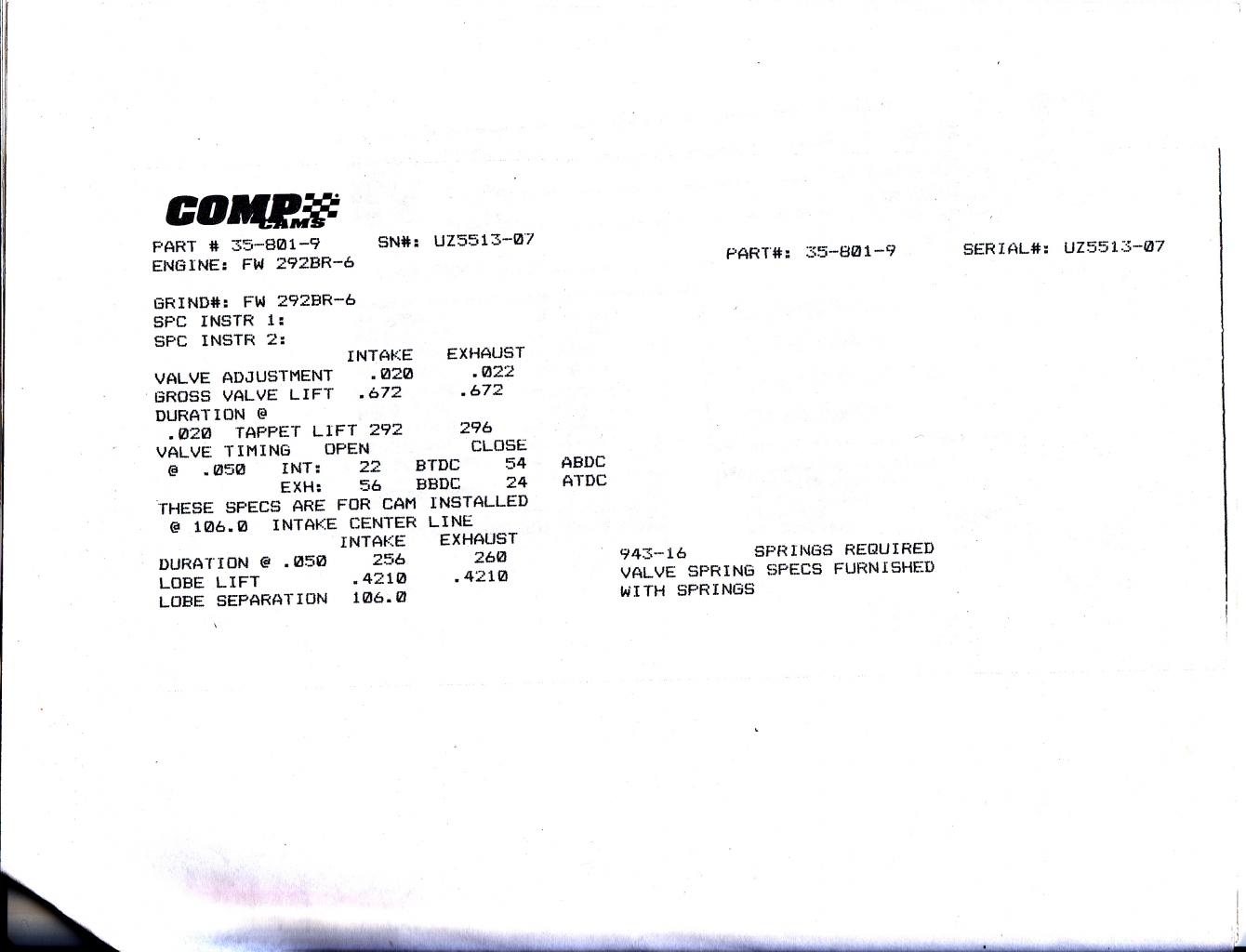

For some time I've griped about having two much HP, this summer I plan on going over the car in preparation for the up coming 50th anniversary event and plan on a cam swap, not to make more HP but decrease it, I've ridden in many GT40s but really enjoyed riding in Richards car which I think is 450 HP and very manageable. Here is the dyno specs on my engine when new with weber carbs, now has 4 TWM throttle bodies with EFI, I would like to see somewhere in the 400-450 HP range at the crank. Its a solid rocker roller motor with the rev limit set at 6500 now so hydraulic rollers is not a problem for me. The car and engine have 13k miles. Here are a few pictures with carbs and then throttle bodies.
This is a person preference, I'm to old for surprises.
Please post your ideas and comments.

Wow, that's a big freakin' cam. I'm surprised a cam was spec'd with lobe separation that low for a Weber setup. Webers usually need 110 degrees at least. Did it spit like crazy? That cam is actually for oval course 1/2 mile racing with an RPM range of 5800-7800. If you're rev limiting at 6500 you're barely getting into the area where this cam works. Since your power is dropping off at 6k I will bet the heads aren't built for high flow at high rpm but rather more for torque (you have a broad torque curve that comes in very low). This probably means your heads and cam are a poor match. I think you're right that you can do far better with just a cam change. It might be worth talking with a comp cams camshaft specialist to spec a cam for exactly what you're looking for. When I spec'd mine they requested gearing, weight, use (some road course but still streetable for me), as well as all of the details about the engine. You should be able to knock 100hp and nearly that much torque off, keep a broad torque range as long as your valves/runners aren't too big. Based on the fact your power drops off before the cam gets into it's power range I'd bet your heads aren't too big and this can be accomplished along with improved idle and streetability.
If that doesn't work, next up would be the gearing...

I agree Rich, changing the Cam the most affordable solution for this engine, I'm running really fat on the top end now just for protection, AFR 11, I might go full sequential with this mod or swap, I'm running an old TEC2 unit now which is only batch fired, but have a motec in the box here in my office which will really smooth out the low end. :) Did you tell me your running FAST system or is my dementia kicking in?
Steve I have AFR 225 heads, and I'm looking for for a smother torque curve, more than likely when the time comes I will be calling up comp cams, I really don't have a clue to what it should be, I'm more of a electronic tech than engine builder, most the engines I mess with came from Italy.

For what it is worth with the cubic inches you have. I think you would be very happy with a gearing change. With a 4.22 you are really mulitplying the heck out of the torque your producing. Had a 455 Pontiac GTO years ago. It had 3.08 gears with 301/313 duration cam with Rhodes lifters very drivable. Your cam specs are not that far from what I had in it. After blowing the rear diff I put 3.70 gears and it was unbelievable. Could not imagine a 4.22 gear
