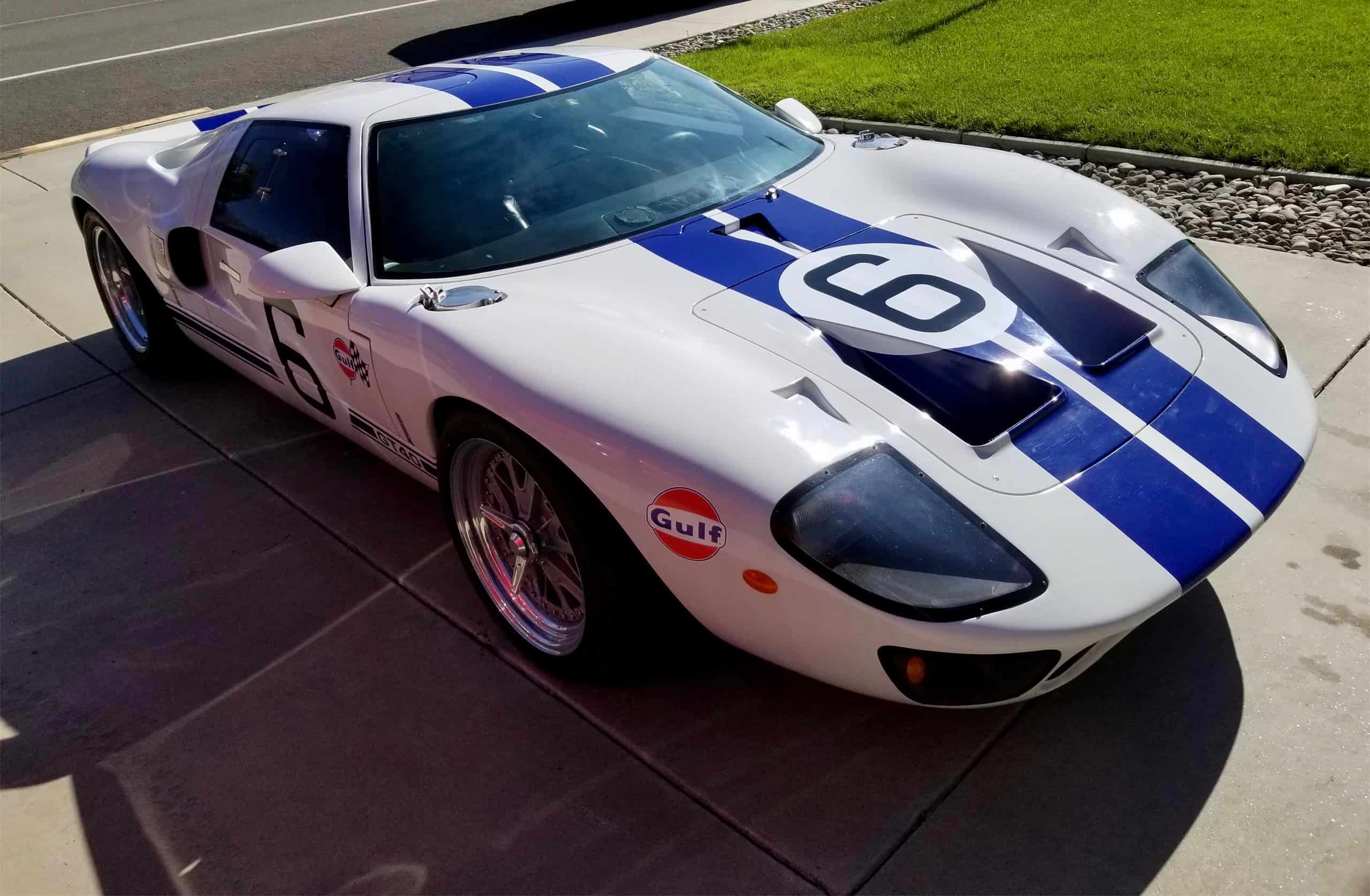

Greetings, i am looking at a gt40. Purportedly made by Andrew Broadley of lola fame, gt40 north america? Seller says body is all carbon fiber. They only built 12? Did they make such a thing? Gorgeous car, although a few details stand out to me. Just looking for some feedback on gt 40 north america's builds.

Thats the car. Going to Mag auctions on the 25th. Looking closer at the clamshells, they look like fiberglass instead of carbon fiber.

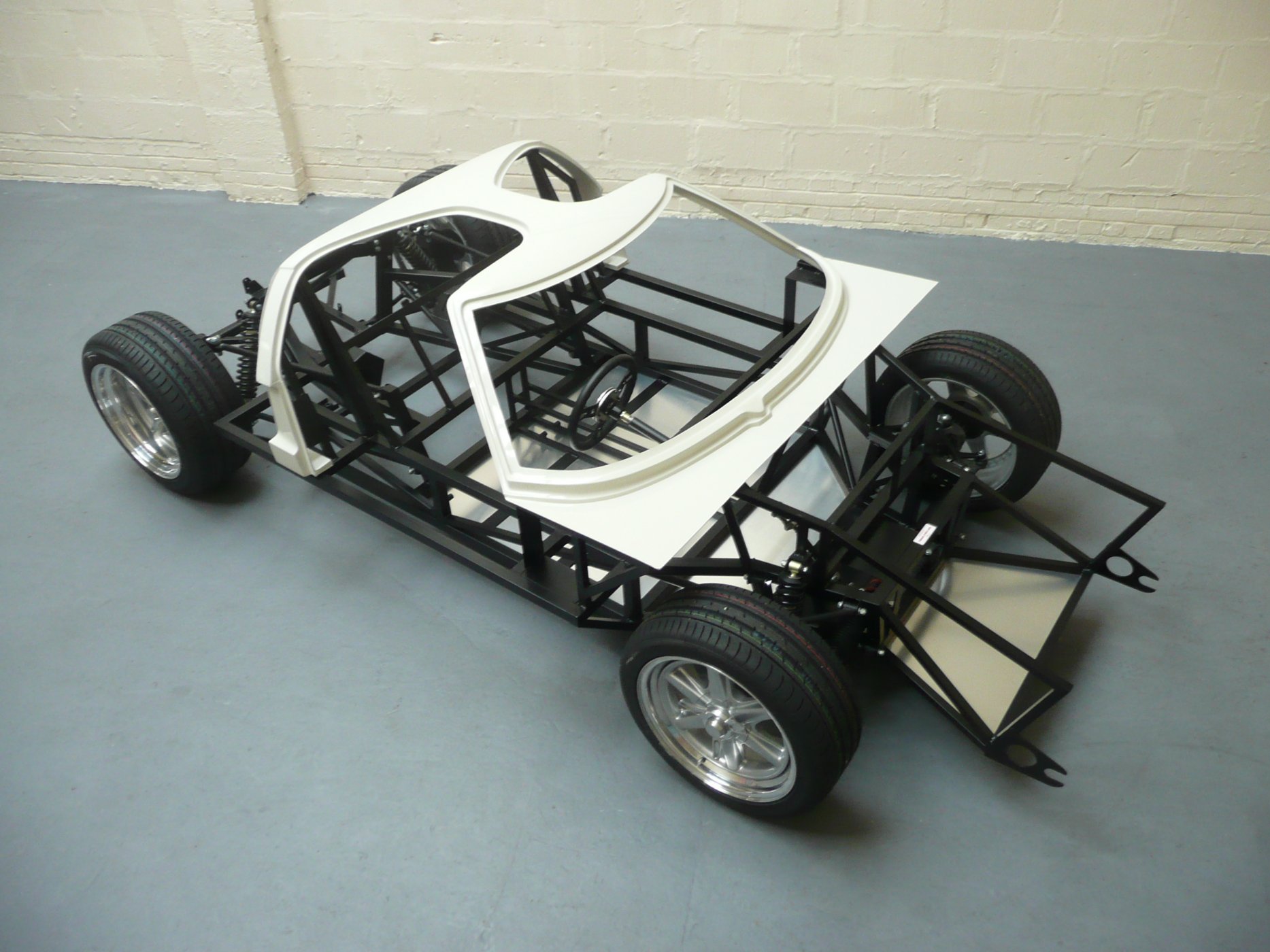

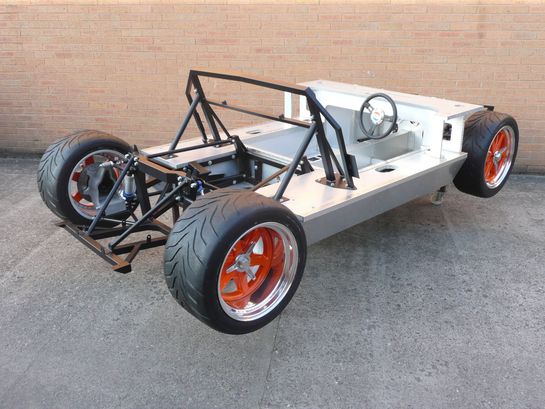

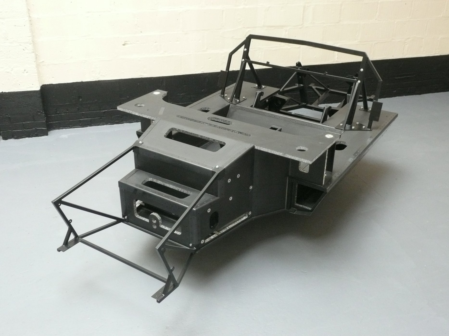

There are other photos online, the panels are definitely CF. The chassis is space frame with CF panels rivetted and glued on AFAIK.

Can Tornado still make the carbon tub ? One would have to make all most everything on the car from carbon to get under # 2000. I think quite a stretch !!!!
