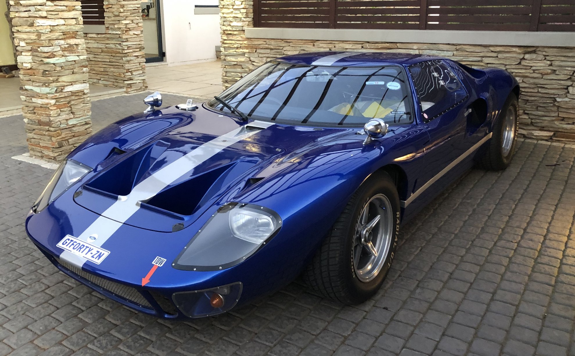

A couple of months ago, I introduced myself when I bought a 2003 CAV GT, which I was planning to freshen up.
I thought it was time to share some of the progress, since it is moving very very rapidly.

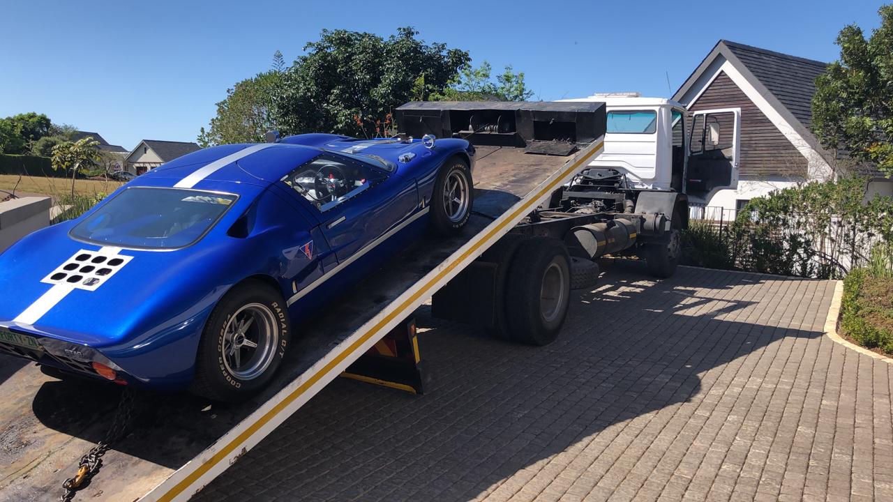

I decided (since I live in South Africa) it is very convenient to ship it to the OEM (CAV in Cape Town) and have them help with the modifications.
First a few pictures of the car as I bought it. Nothing wrong with it, just old-ish paint job, not perfect panel gaps anymore, and tattered seats.

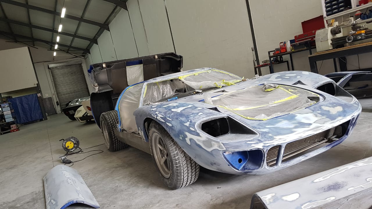

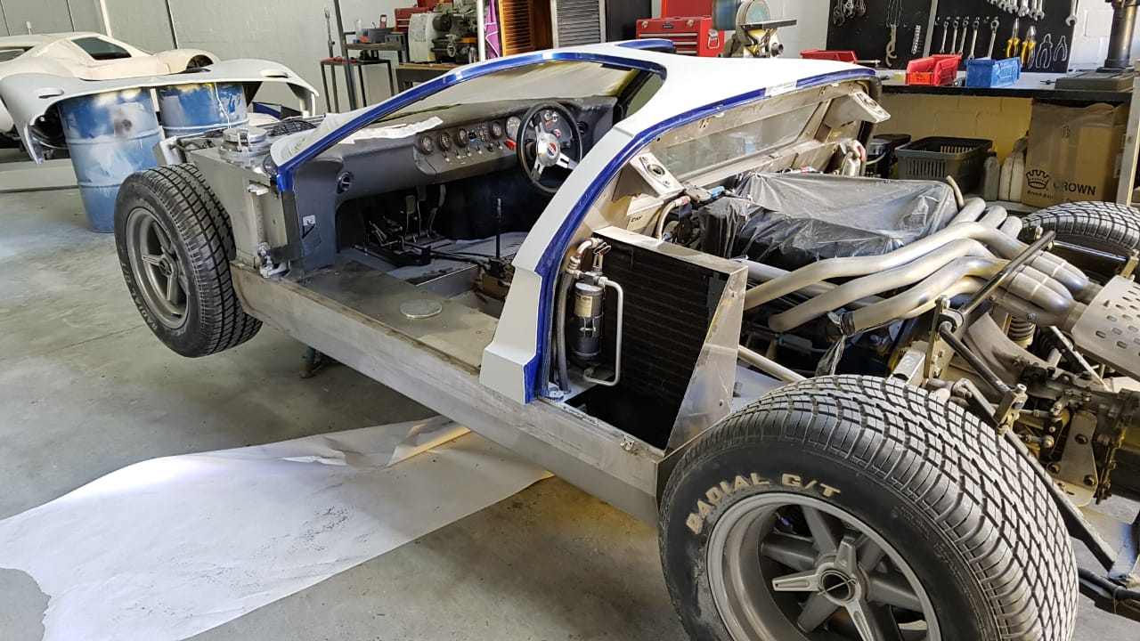

The plan for the car is to:
- Redo some of the body work: scratches, cracks, misalignment, chips, there was a lot to improve on.

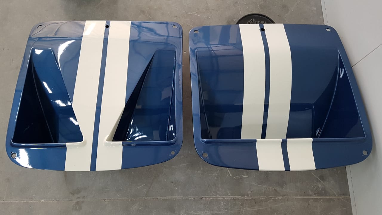

- Change color scheme (not a fan of the 'modern' blue, going guardsman blue and wimbledon white stripes)
- Upgrade carbed 302W to EFI 302W, but keeping carb-look.
- Upgrade interior, with new seats and new upholstery.

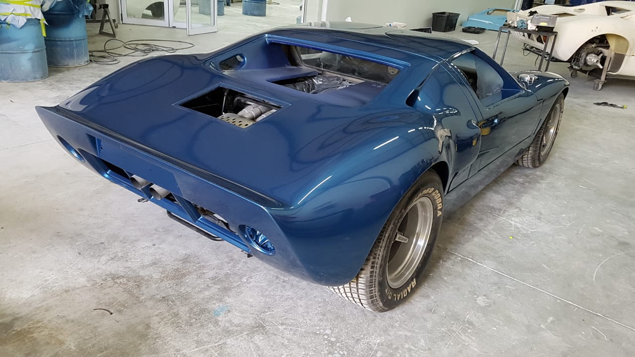

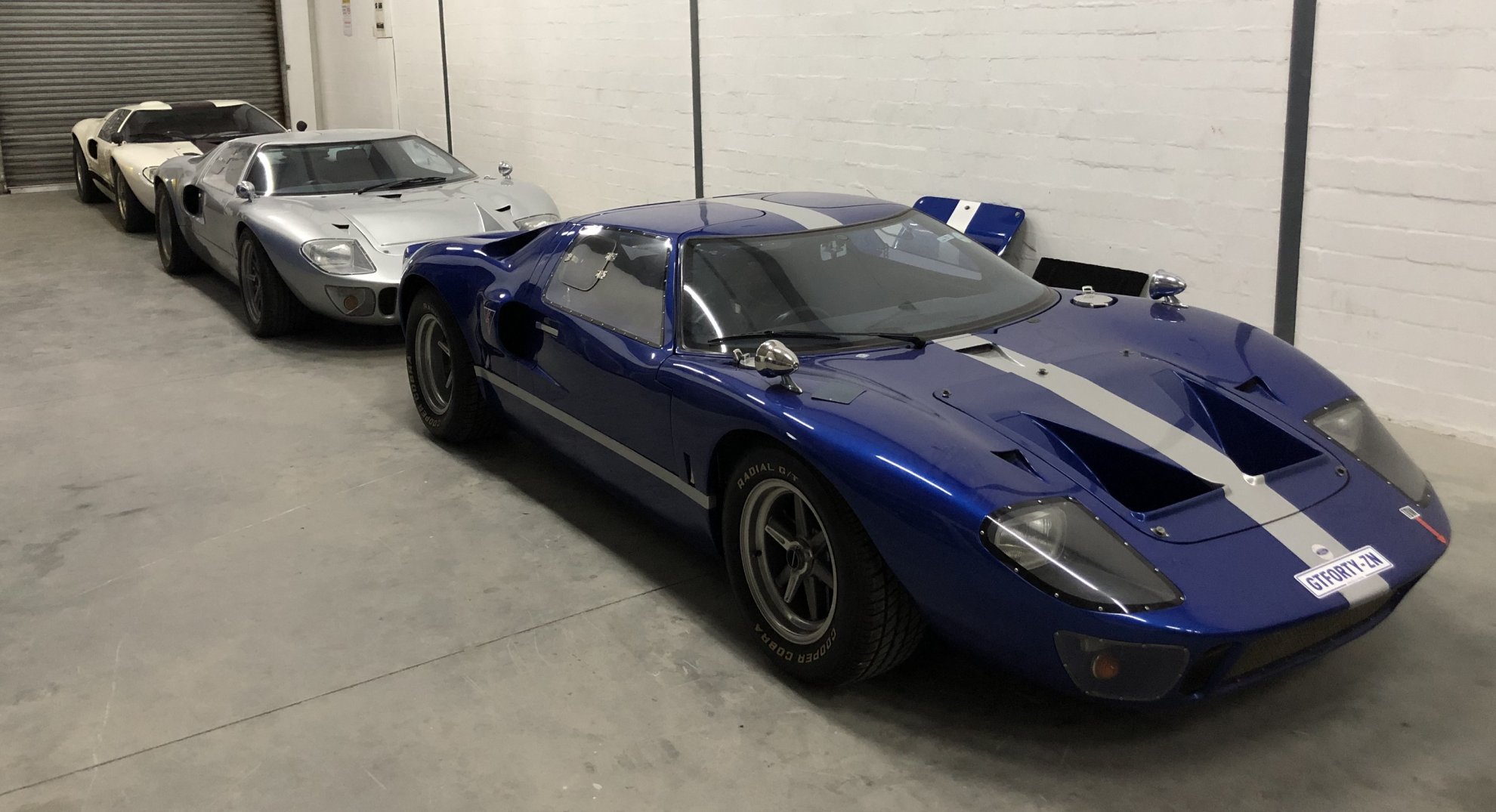

Beautiful to see all those brand new CAV's there. Also: the guys at CAV did not waste time!

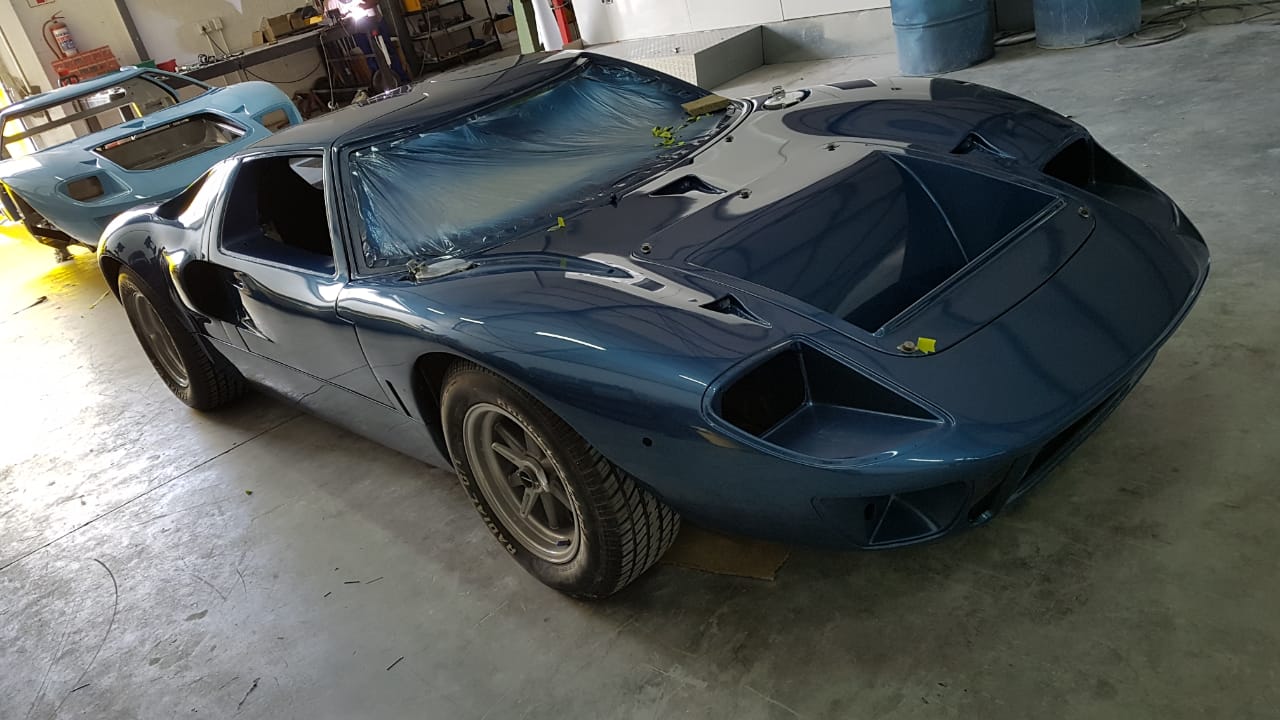

By now, the car is actually already busy being reassembled, but I have yet to see the final result.
Color looks amazing, and the car just oozes much more sixties feel, which I was going for.

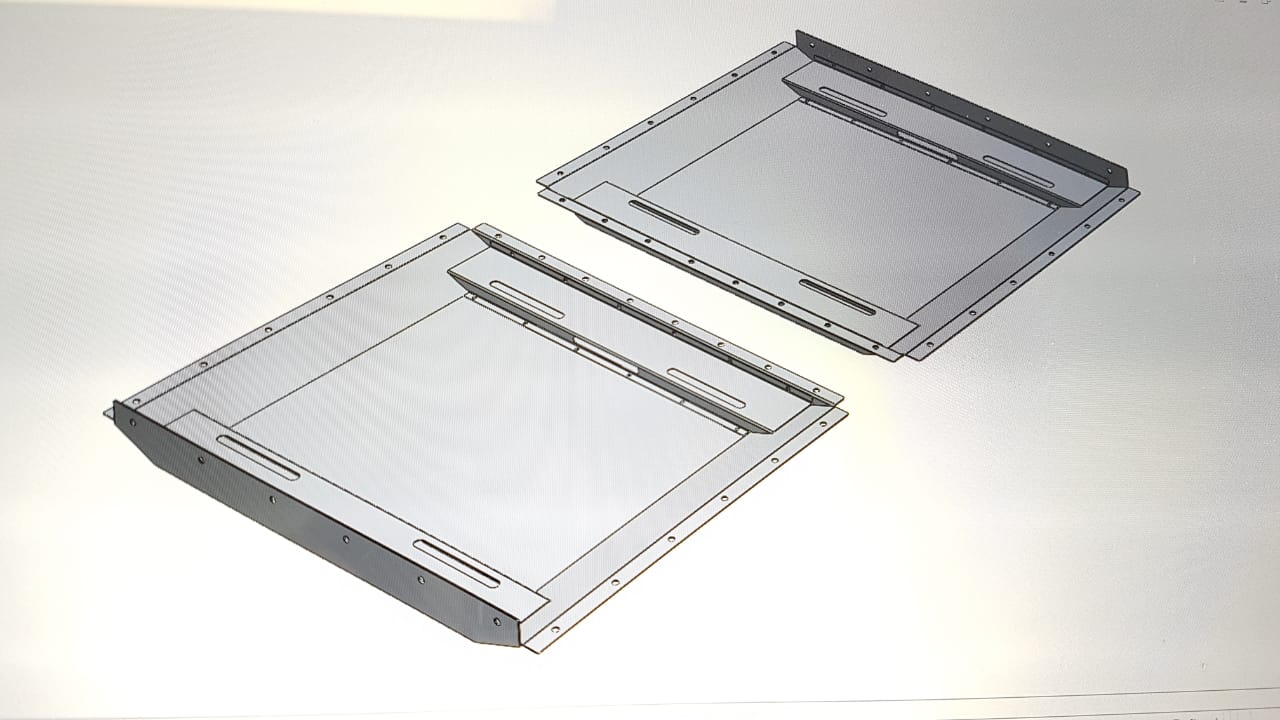

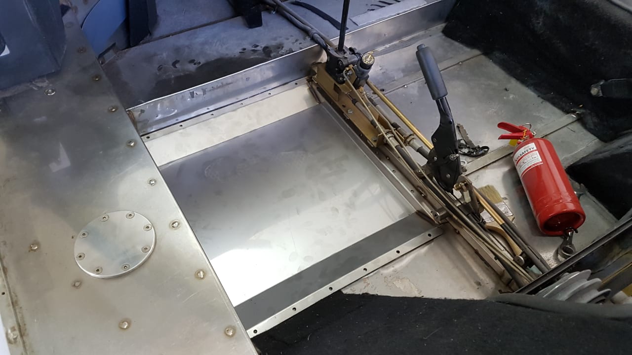

Ow, I actually forgot a very important point:

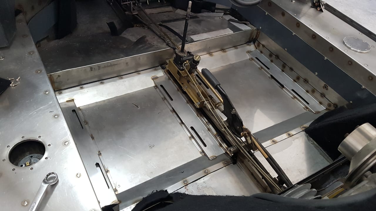

The newer CAV chassis have a special provision to allow us tall european folks to fit in th 40" available.
There is a slighty lowered section in the chassis floor to allow the seat to drop another 1" or so, and thinner seats.
I test-sat in one of the upgraded CAV's and it was a world of difference.
Jordi at CAV actually approved to make a custom designed modification to my earlier chassis, to create the same extra head room:
Not really rocket science.
Just a local 'dent'in the floor to allow the seat to drop a little further.
Design below:
Installed here on the left-hand-side, normal floor on the right.
Because of the better fit with their seat design, it also makes better use of all the available milimeters..

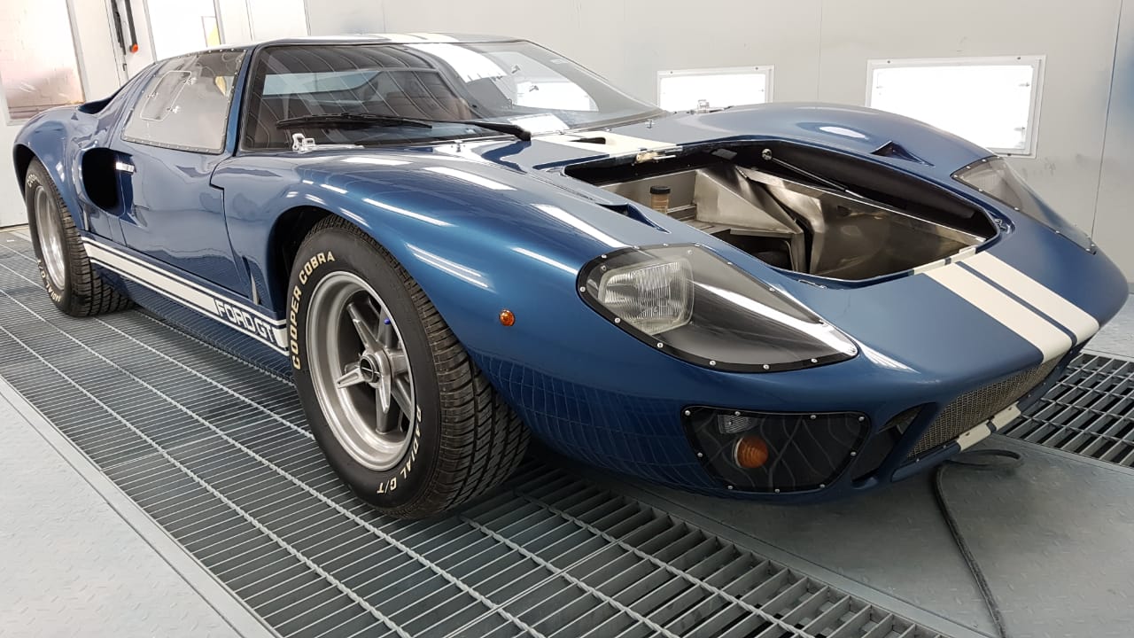

I haven't updated for a while, but lots have happened. Especially now that we're on lock-down in South Africa, I can get a lot done.

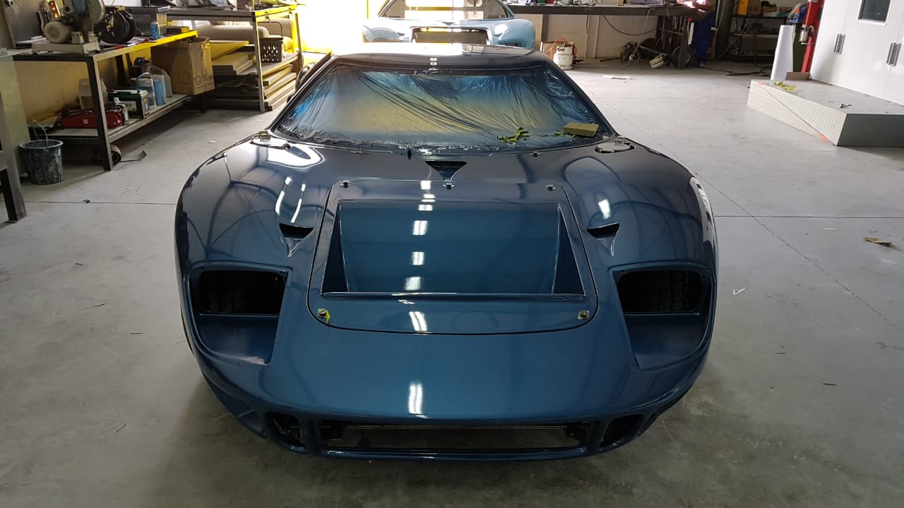

First of all, the car came back from a new paint-job/bodywork job at CAV in Cape Town.
cb7cdbce-339e-43d4-9631-18778afead0c.jpgIMG_6129.JPEG cc5af880-c1e1-489f-90a9-a000d5eae8e6.jpg

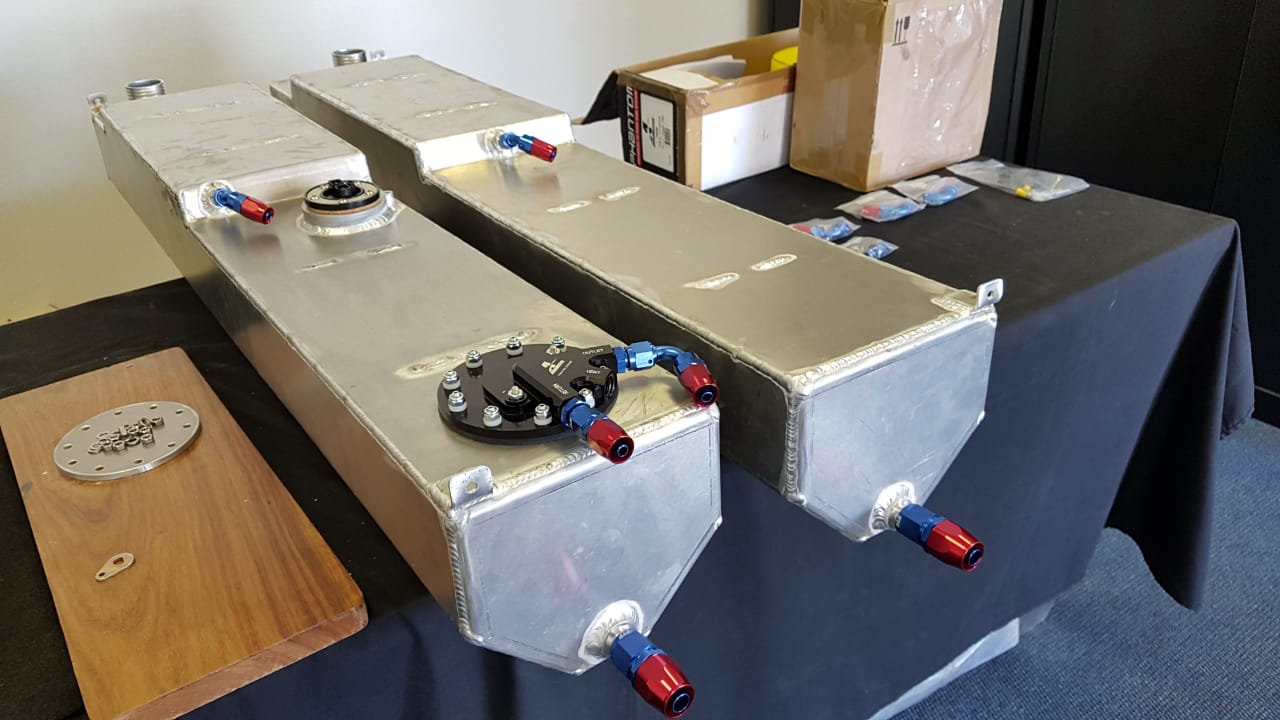

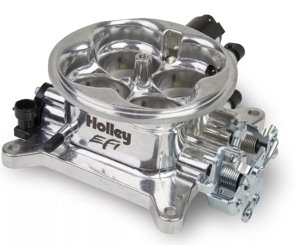

Also got a pair of new tanks made, with integral high-pressure fuel pump system for the fuel injection system. (Aeromotive Phantom)

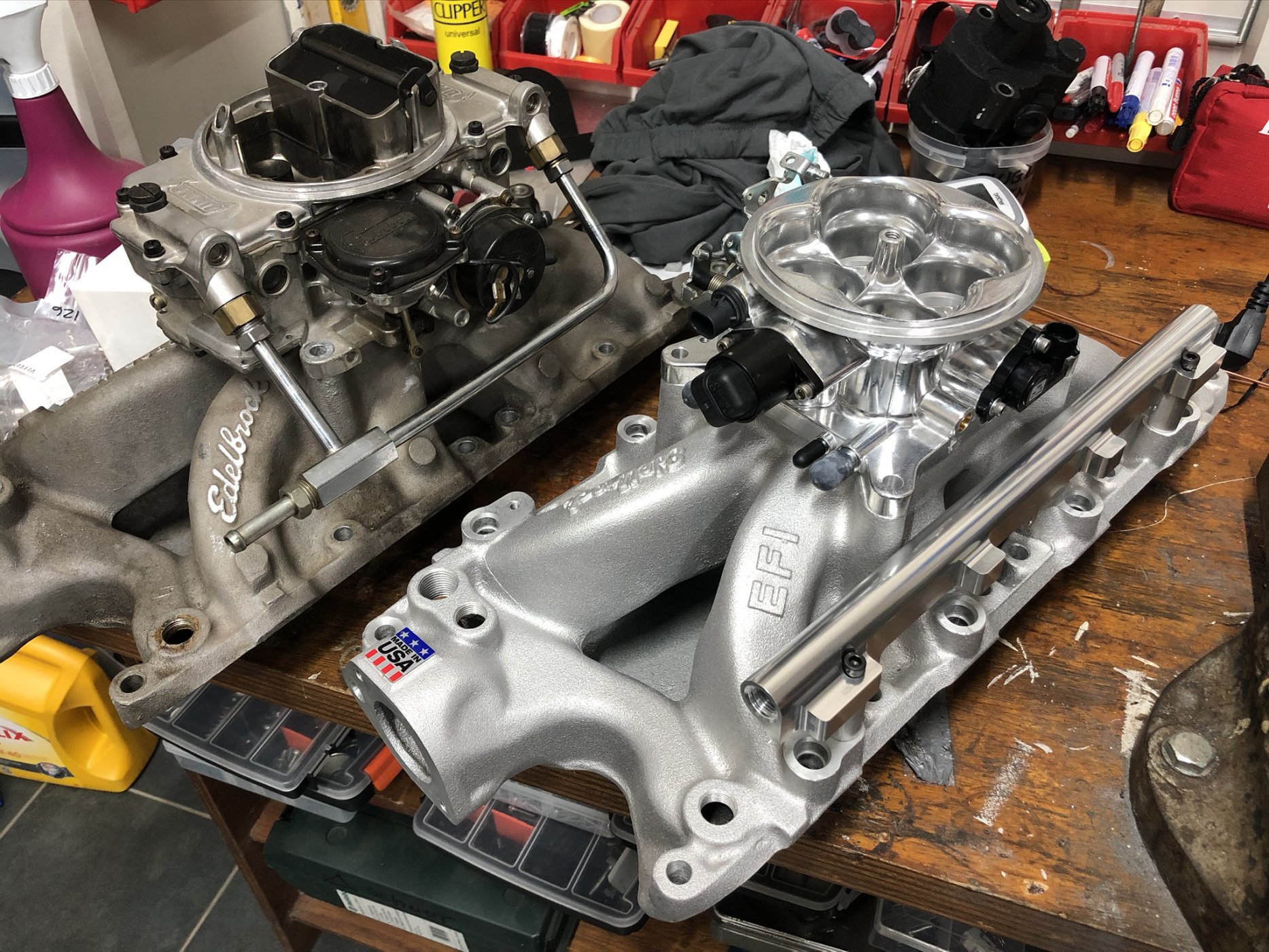

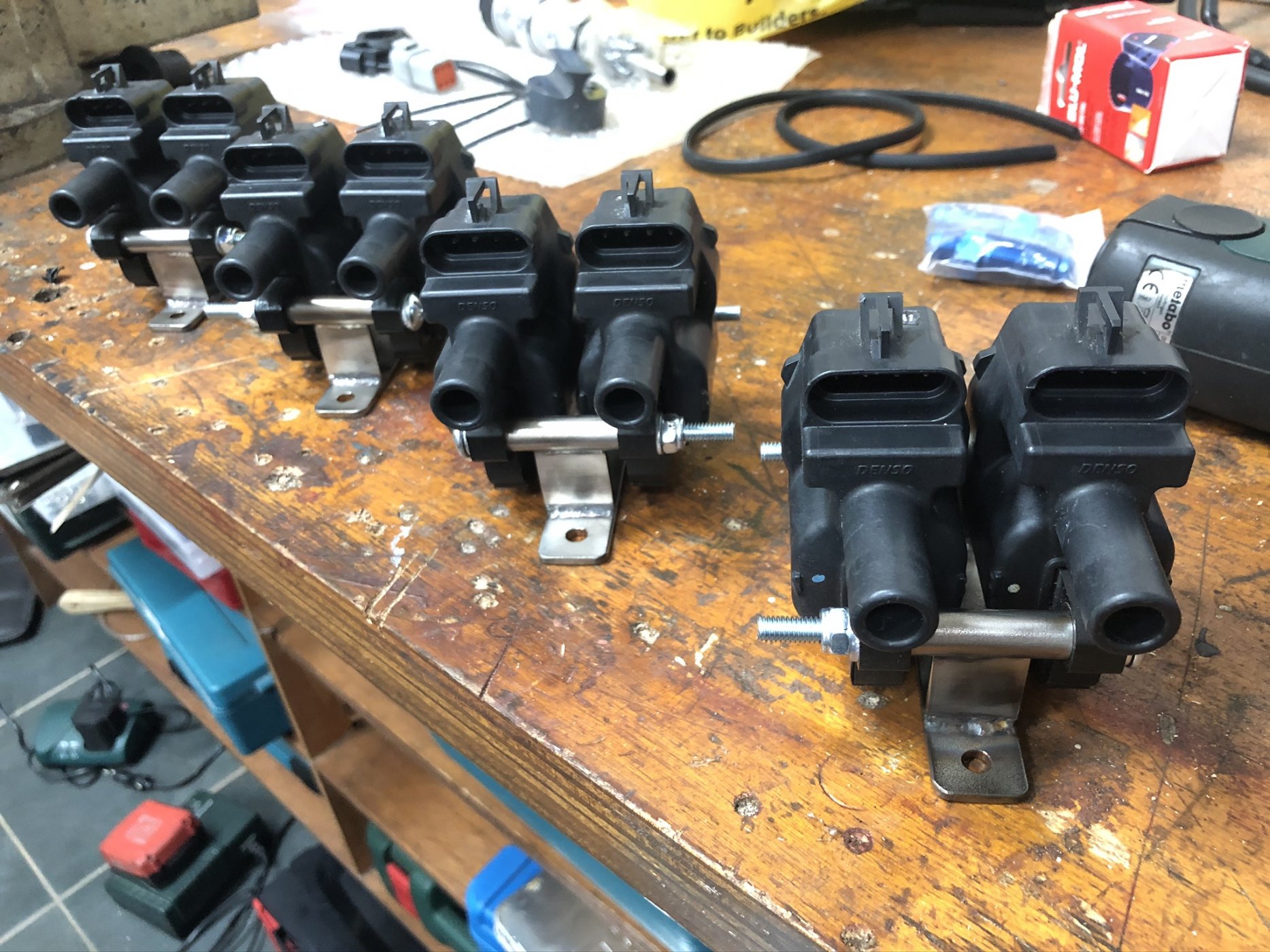

In parallel I was preparing for its return, by prepping the EFI system. I'm going full sequential and coil-on-plug. That means I can time the spark easily with a laptop, and exactly they way the motor wants over the RPM and load range. Hiding the coils underneath the exhaust/chassis rail.
Intake is new, throttle body with idle air control valve and throttle-position sensor for the ECU.
