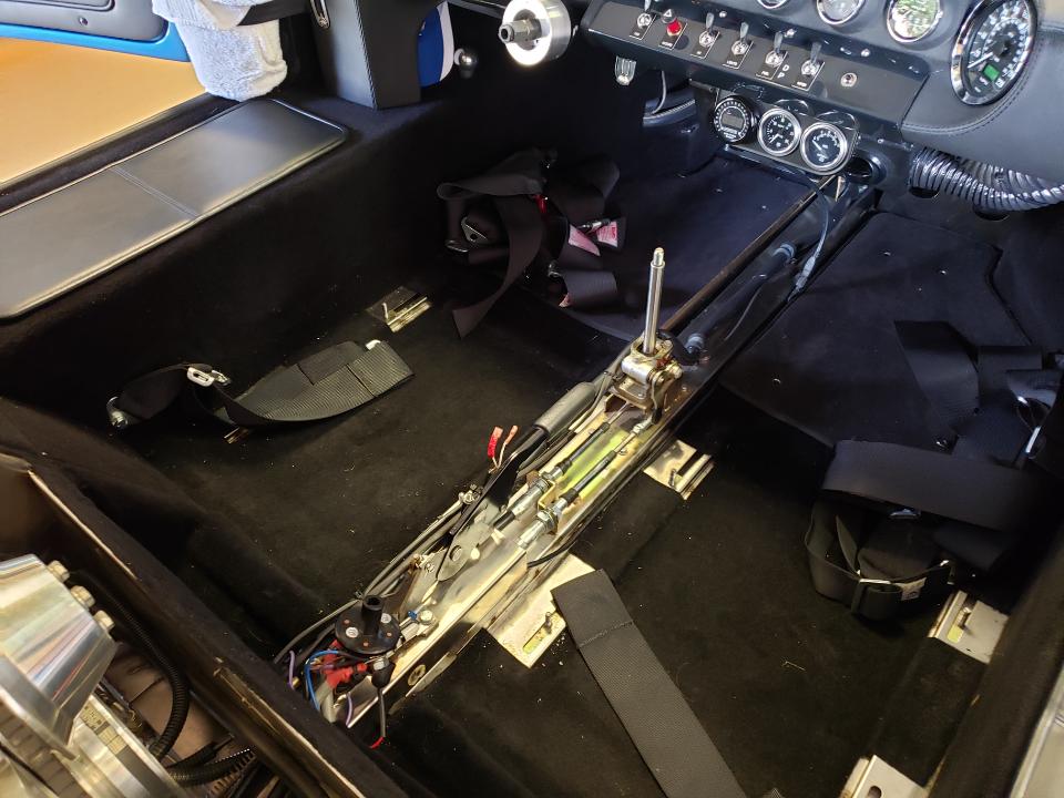

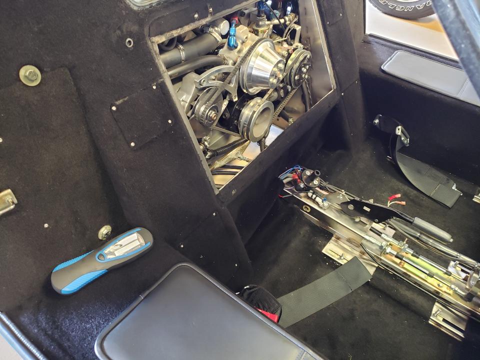

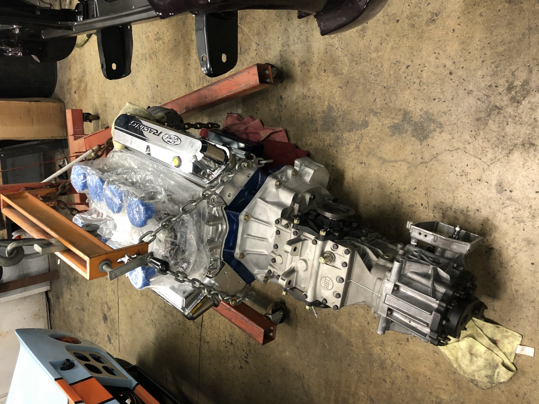

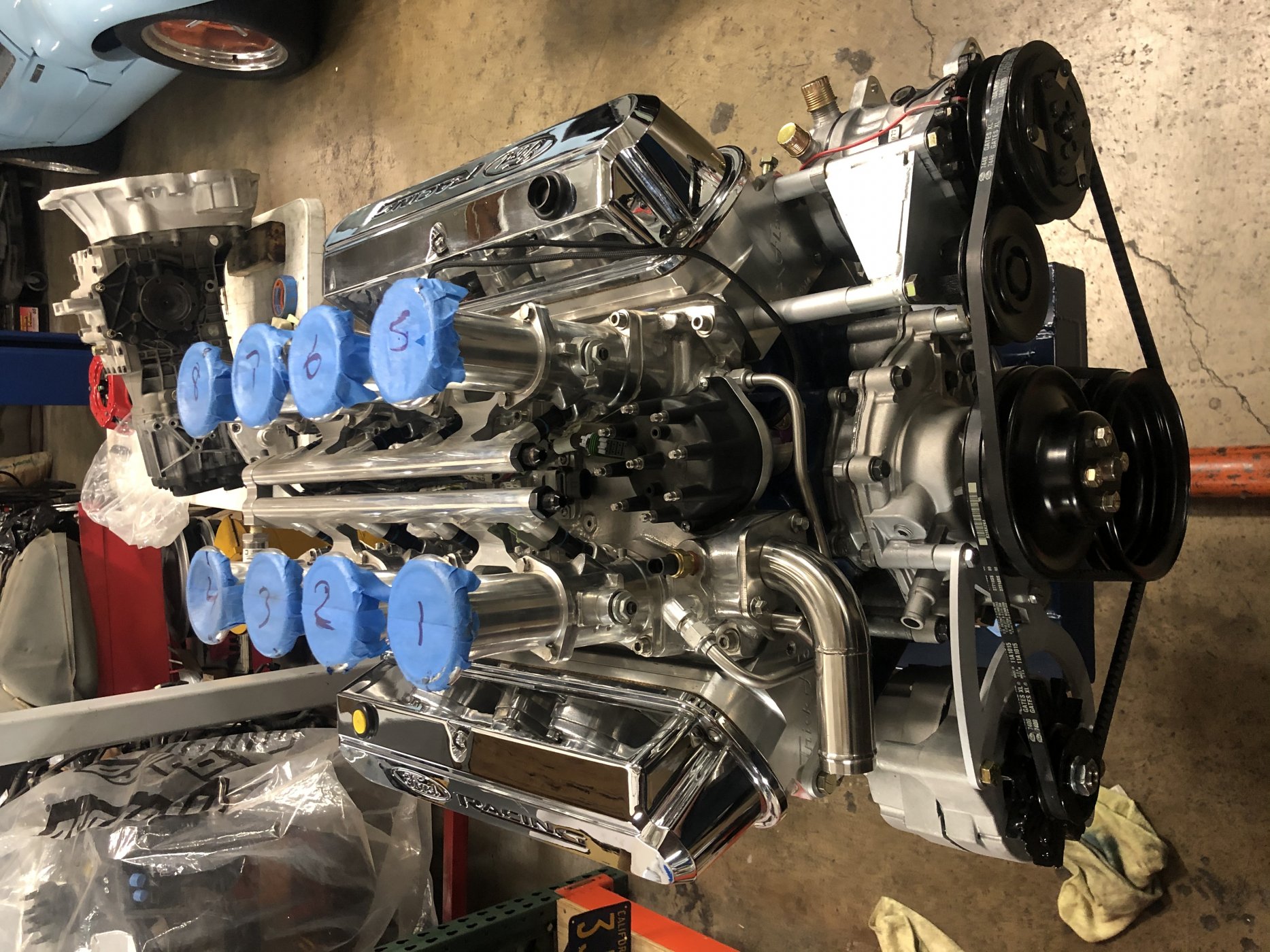

Hey fellas nice to find a GT40 forum we are currently putting together a gem 1 CAV we are pretty close with it just trying to get some feedback on shifter setups. Would love to set up with rods but seems like the hot set up is cables let me know what it guys think. Thanks. I’ll post pictures of our project here shortly

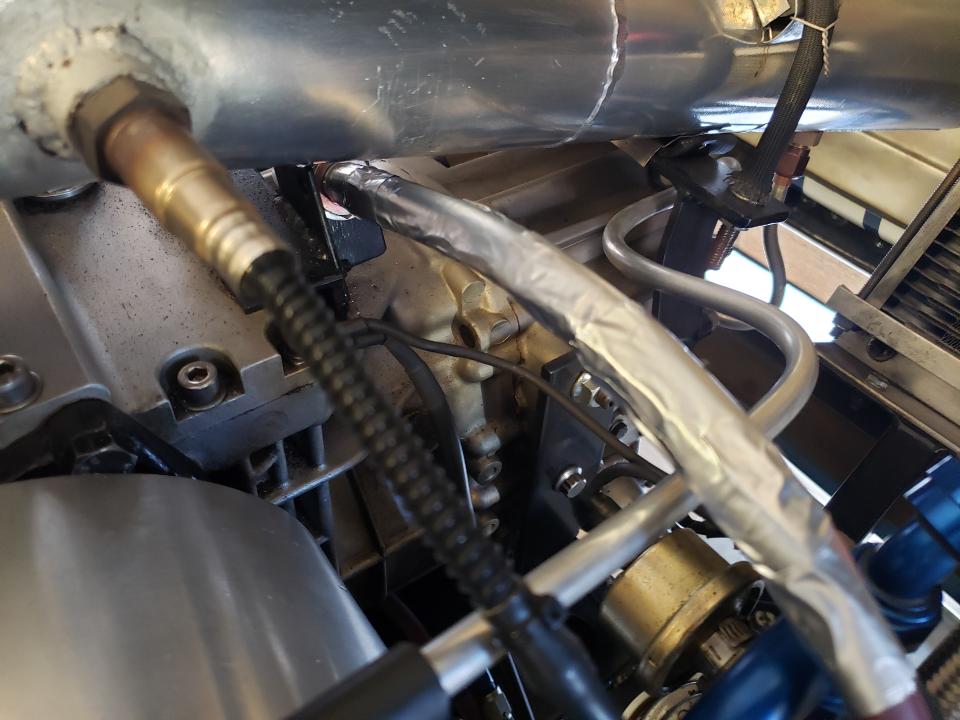

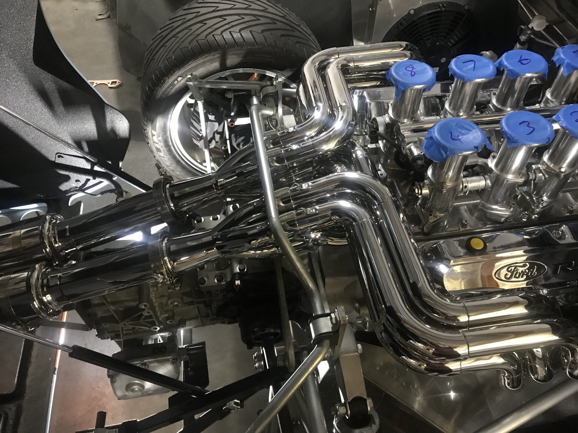

Hello Leon, very nice build! Did you custom build these headers/collectors, or you managed to source them somewhere?
I have CAV #22 with a cable setup, but a friend of mine has a scratch-built GT40 with linkage.. I definitely prefer the linkage setup, and looking to see if I can fit that into my CAV chassis. not going to be easy though i'm affraid.
Bill Kearley
Leon, how are making out with your shift linkage? Jasper, I'm also interested in going to a rod shift linkage. I almost had it worked out on paper before I went with cables. I think it's quite doable with the RBT and a left hand drive.

You can get the castings for a solid shift assembly although I'm not familiar with the CAV chassis. You would need to obviously route the shift through the bulkhead and although a solid shift can be used on the central tunnel its easier to mount the gear stick to the right of the driver (in a RH car)

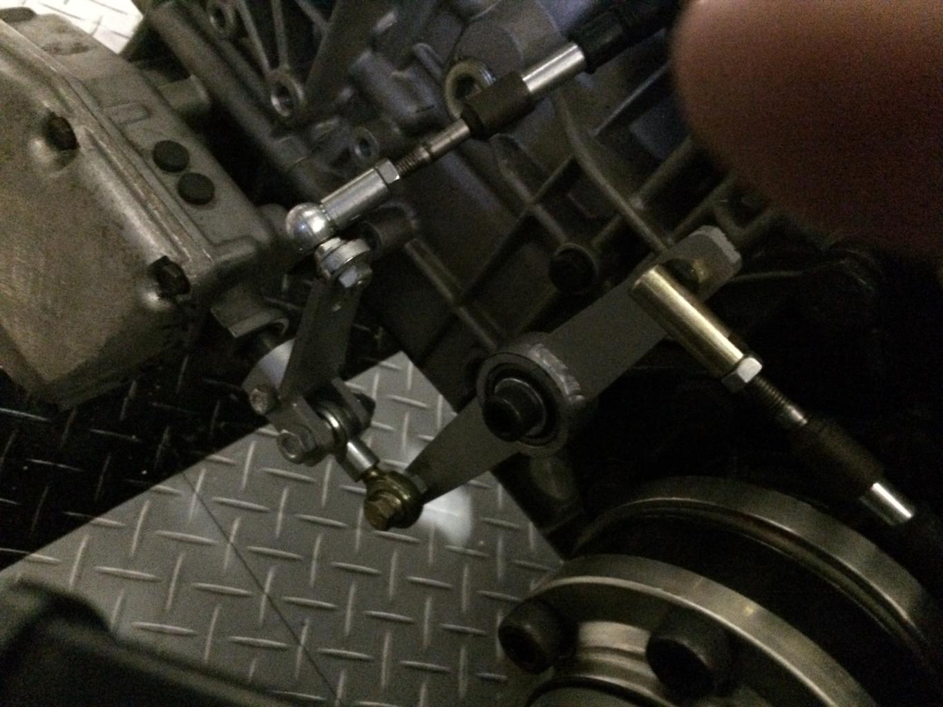

Here is a pic at the transaxle (ZF inverted). Not on my car but same Olthoff Racing setup. My car is left hand drive and this setup works great. If I had right hand drive I'd probably use the rods like the original cars.
