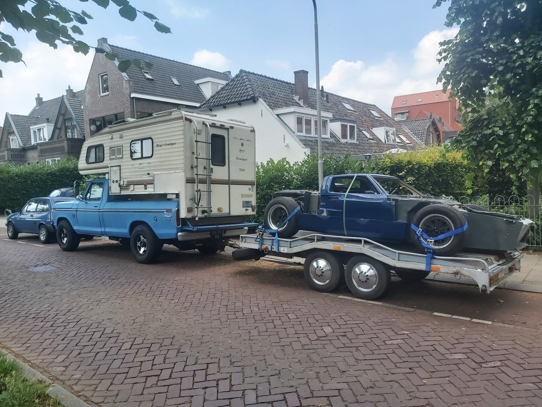

Hello, Where is the best location to tie the front of a CAV down to a trailer? I'm not seeing much besides the control arm. My wheel slots are not big enough to allow a strap through the holes. Thanks
I've see some cars secured by straps looped over the tires. Depends if the deck has suitable cross braces or brackets to allow that. It needs a point directly in front of and behind the tire, and a third to hook the strap end to so you can pull the strap ratchet buckle tight.
I have an SPF and have always used the lower A arms to tie down the front. Never caused any damage and works well.
How I do it for years.
