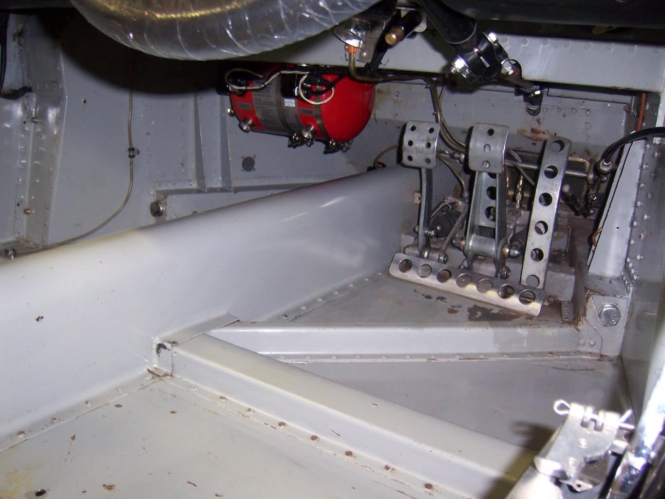

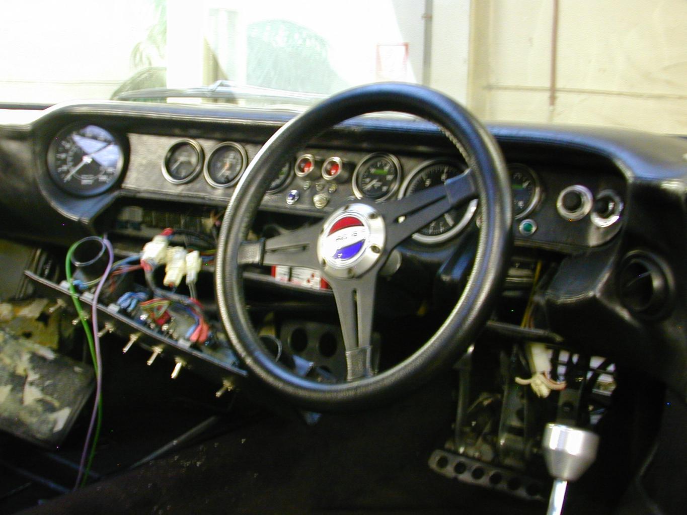

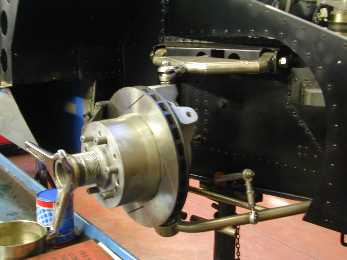

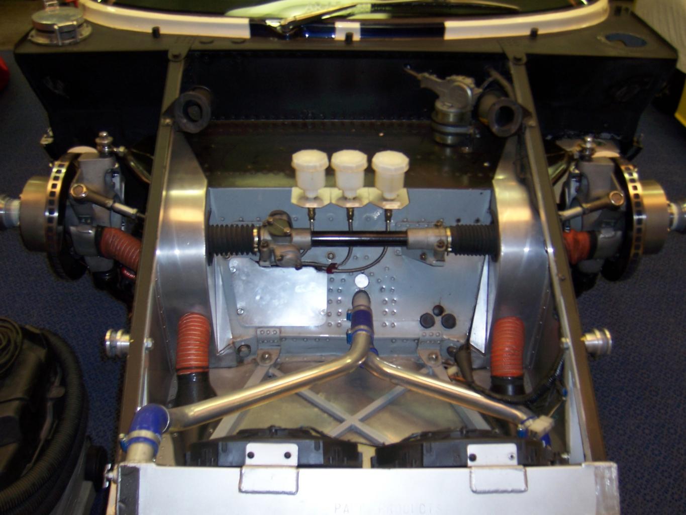

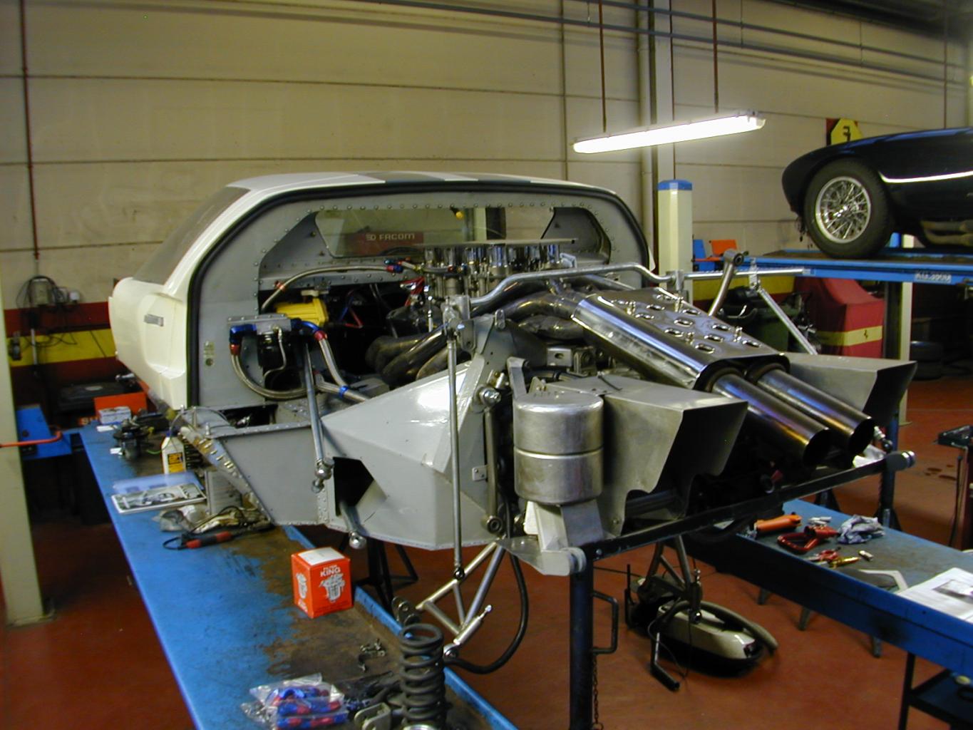

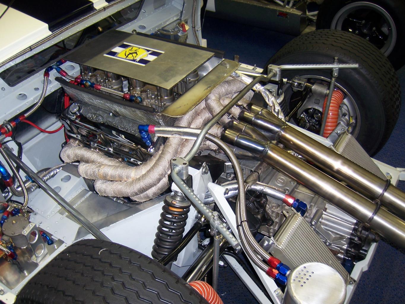

Hi everybody, I'm new member at GT40.com. Can someone help me identifying my GT40 chassis ? I have a lot more photos with details for all parts of the chassis if needed. We already know that the car was "build" or "re-build" early in 1990, apparently not in South Africa (c/f Hi Tech Automotive).

I noticed the AP style rotor but what appears to be a Girling style caliper. Did the calipers require any modification to use the wider rotors or is it done with thinner pads? If you are looking for a "pre-66" classification FIA HTP are those rotors allowable? We have been told a "Pre-66" requires solid rotors.
Love the look of that chassis...the rivets look awesome, anyone know more about it? More pics would be appreciated.
Hi,
When you compare the front of the tube and picture of first GT40 in Spain book, it's far from an original to me.
The rivet construction is neat but don't seem original in anyway.
This tub need expert eyes!!!
No Vin numbers on Tub or rivet on body parts?
I saw and photographed this car back in 2004, in Brussels. At the time, it was being worked on at GTM--Guy Trigaux Motorsports. He told me that it was purported to be an original GT40, but that it was most emphatically NOT original, but rather a later copy. I don't remember who he suggested had built it--Sbarro, or somebody in England? I honestly can't remember now. I don't think this car has anything to do with GT/111 referenced in the numerous above posts?
I think he said it had a 351W engine instead of a 289/302. At the time I photographed it, it had a big single muffler on it instead of the megaphones it now has. Or rather, it had two mufflers with a single heat shield joining them together.

The chassis looks like one of the 10 or so built in the early 90's in Australia. A real 40 was used as the source. The tubs were riveted together. Trevor Booth who is on this forum is very familiar with these cars as he owned one. A guy in the US attempted to import them as kits but the deal fell through. He had one car in the US in Palm Springs in about 1995 which was a very real looking replica. That is my bet on the origins of the car. Contact Trevor if you are interested in a positive ID.

Some pics of what I believe was a 'Wigg' chassis, photos were on T/Me & i think may have been posted here as well.

yes it is a frank wigg chassis. the car you have was built many years ago and advertised for sale as GT 111 , I have some photos that i can post when it was advertised as GT 111.
The chassis is reasonably OK, however, the rivetting was not done correctly. A lot of the rivetts need to be replaced. The chassis was also incorrect in wheelbase approx 40 mm shorter than original. It can be corrected reasonbly easy
I can email you some photos of the one I had some time ago showing replace rivetts etc.

Jac Mac,
yes that is a wigg chassis , however I would suggest Frank did not build this one.
All of the chassis that he built were completed not half done as this is
