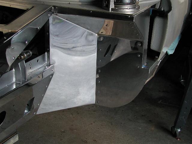

I was a little dismayed by some of the beatings that my paneling had taken while we trial fitted and removed, and fit back on and removed again the various bits on to the car. So I decided to take a poke at cleaning up the aluminumi cladding in the driver side wheel well. A little compounding followed by a finish polish with a DA and here's what we have. This started out as mill finish aluminum which was about as reflective as concrete.

I'll probably put some Zoop-Seal on, have heard some good things about it from the bike guys up here.

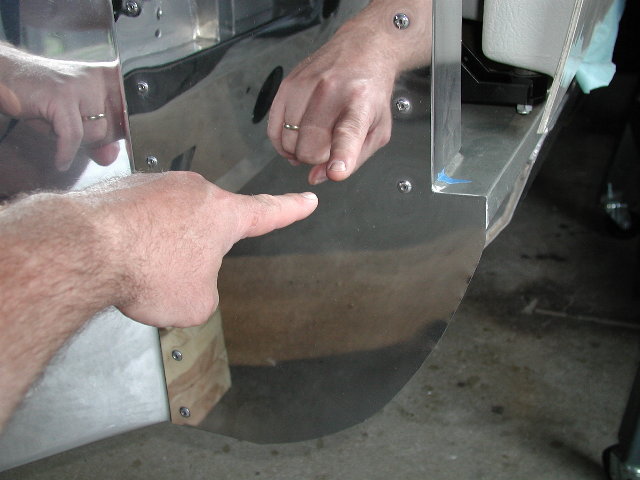

Now that is shiny. You are hereby banned from my garage!
Are you pointing at a spec of dirt that causes offence?
It looks beautiful now but being in the vicinty of the tires and all the road trash / sand they kick up, I fear it won't look that way for long - wax, sealer or not...
You may want to consider getting some of that heavy duty clear film that they put on the front ends of cars (Clear Bra) to protect that area..

I purchased the materials from Tom over at perfect polish. He has a variety of buffing kits and compound sample sets that allow you to play a bit. I compounded with my 1/2 drill , and then followed up with a DA to polish out. It's a little work but it works pretty well.

Clear anondizing would work the best, but alas the panels are installed.
Now that they are polished, it won't be to hard to keep up.
