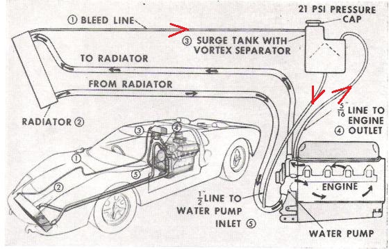

Has anyone connected their coolant expansion tank to the drivers side coolant pipe? My expansion tank is located on the drivers side bulkhead and the plumbing would be much easier if I just dropped straight down to the driver side coolant pipe instead of crossing over the front of the engine and connecting to the 3/4" heater hose at the water pump.
