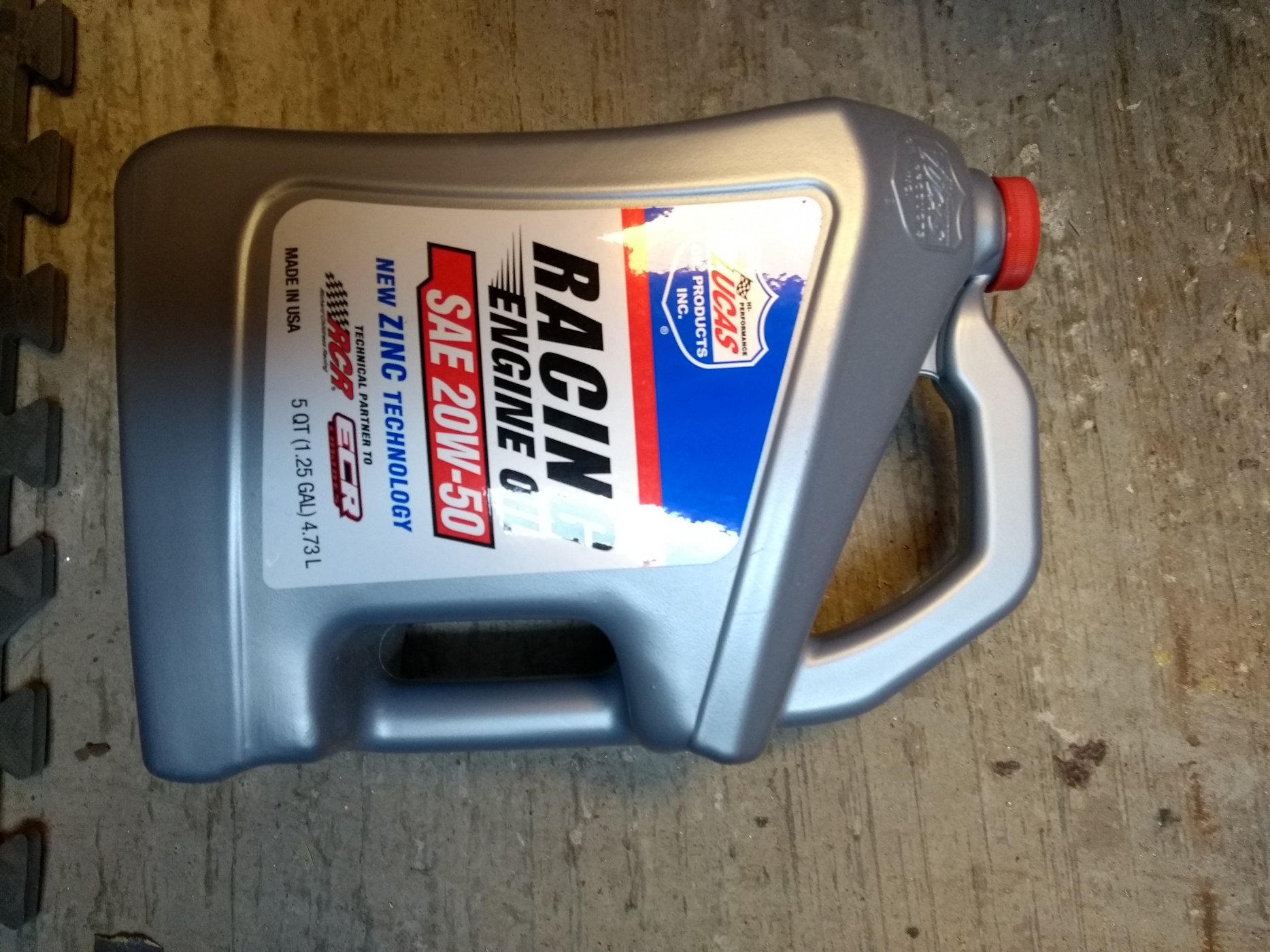

I was recommended to use Lucas Racing Oil by my engine builder who has been building race and road V8s for many many years. He used to recommend Valvoline VR1 but they lowered the ZDDP content.
There is a website where they have tested and analysed most of the oils available. The oil which came out on top for ultimate load pressure and incidentally highest ZDDP content was Lucas Racing Oil. Second best was Joe Gibbs Racing Oil. The Lucas is what I now use in my flat tappet 302 which is now past it's 20th birthday.
(pic attached.)
