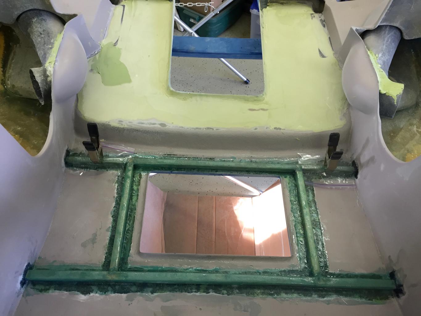

After discussing the scope of work I wanted done and/or not done to the body, the shop and I are back to where we were at when I dropped the car off. There is two places on the body where the fiberglass panels flex a lot. The top of the spider and the large flat section just in front of the rear spoiler which need reinforcement but no large weight additions.

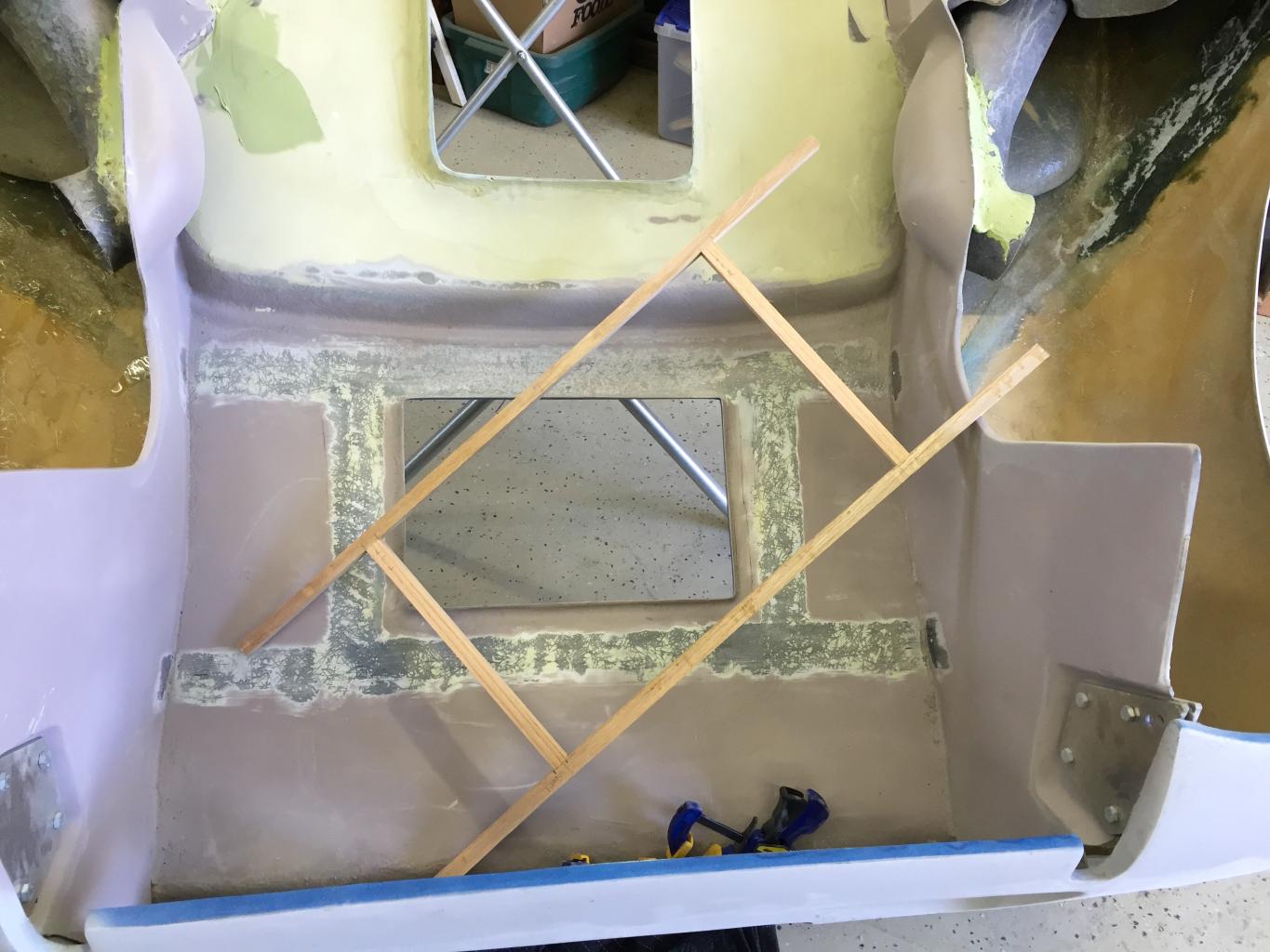

My rear deck on the Mk1 in front of the spoiler was almost impossible to get and keep flat. Until I copied how Dwight had solved a similar problem with his Mk1.
I built an oak support structure from clear-oak 1x1's and fiberglassed it to the bottom side of the deck.
At 215#, I won't claim that I can dance on it without it moving, but pretty darned close..
My stainless steel heat shield will screw to this structure and add even more strength.. :thumbsup:
