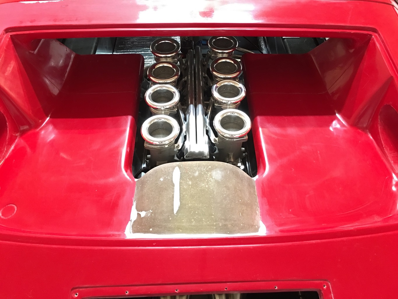

Another option is to go old school 302 or 351 and add ITB injection along with COP. This will give you old school looks with modern fuel and spark control. Of course the cost will go up but I chose this route because I like the look of the old school engines with the modern tech added for reliability and performance improvements that come with it. BTW when my build is complete you will not be able to see the electronics and fuel system so the engine compartment will basically be all motor without the supporting controllers, coils and pumps visible.
Note: Controllers will be hidden when double bulkhead is added.

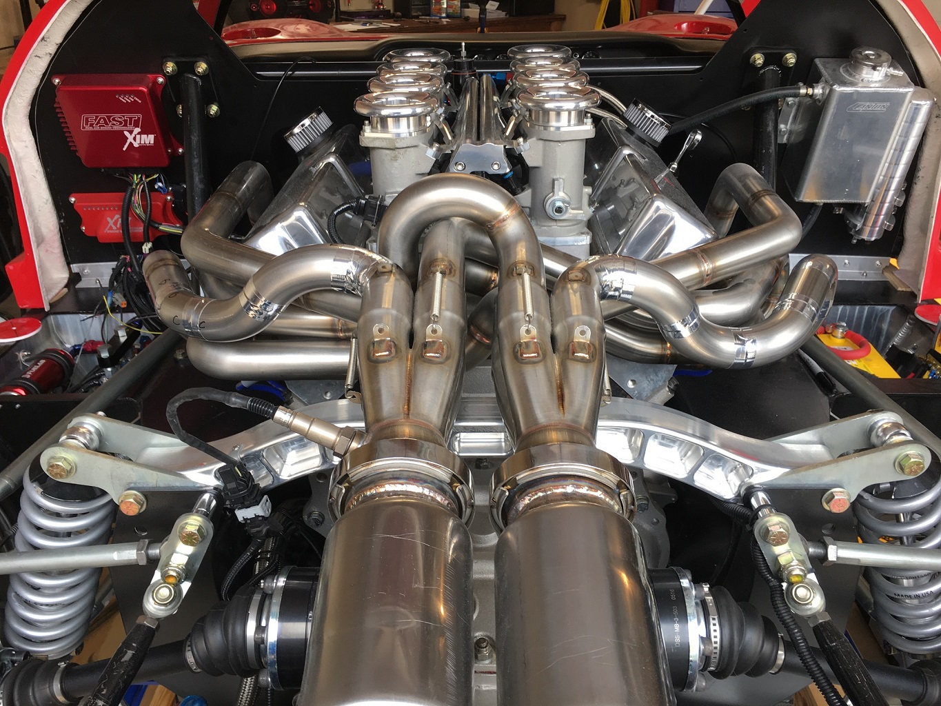

Wow, your car looks awesome! Where did you get the support that connects the shocks? It looks terrific.
My chassis is designed for a Coyote engine. If I want to change to a 302, I'd need to cut the existing mounts and weld in new ones, that's not a problem but it would be easier to use a Coyote.
I love that brace between the shock tops. Did you Make it?
My chassis is designed for a coyote. I could cut the mount brackets and weld new ones on so I can use either engine.

Another option is to go old school 302 or 351 and add ITB injection along with COP..... you will not be able to see the electronics and fuel system so the engine compartment will basically be all motor without the supporting controllers, coils and pumps visible.
Hey Rick, totally agree. You can also hide the COPs in the sponsons and feed the plug wires up to the plugs.

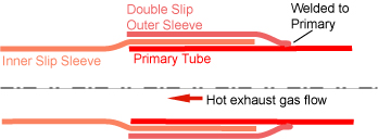

Your exhaust is coming along nicely but can't tell if you're running double slip joints at the collectors. If you don't, you'll get all kinds of O2 leakage downstream to your sensor and that FAST ECU will go pig rich on you (closed loop).
Mine are that way and aside from some reversion at low rpm (tuneable), there is no leakage in that area. I'm running the same intake and ECU setup...
Rick, I love the support between the shocks. Did you make that?

Steve - The support beam for the transaxle is as supplied by RCR, they make different styles depending on the transaxle that you use, as with all of their cnc'd parts they are a work of art and very well designed.
Tom - My exhaust was supplied by RCR but I had to modify the 2 rear tubes to have sufficient clearance from the rear deck. I have to weld all of the joints together so when I do that I can add the slip joints. My intake has 58mm throttle bodies instead of the 52mm bodies usually mounted to the intake. My engine is built to live at 7,500 so I needed larger TB's to provide air at high RPM's, HP starts dropping off from 625hp @ 7,500 to 575hp @ 8,000 rpm.

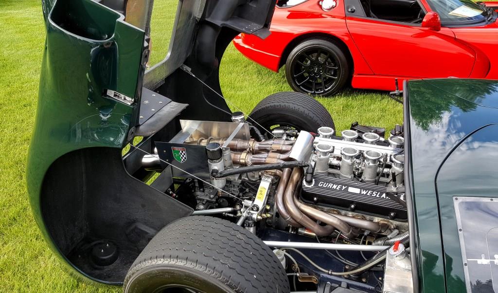

There's that CLASSIC GT40 look!
What else can you tell us about your engine?

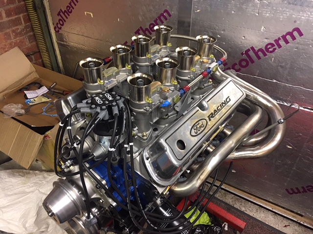

Mark Boyers
1973 block ,eagle steel crank internally balanced,eagle rods forged pistons stroked to 347 ,Edelbrock rpm heads ,scorpion roller rockers,Chet Herbert cam 500 lift and lifters 10.6 to 1 Comp ratio
Target hp is 400 as the bottom end is stock ,my guess is it will make a little more,perhaps the engine men on the forum would care to comment
