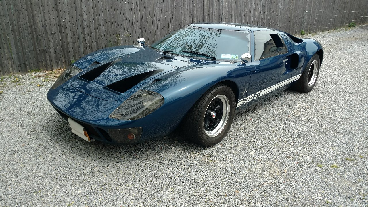

I have been working on a GTD that was passed down to me from my dad. The car sat in his garage for about 15 years. My dad having a collection of classic Fords let this one get left behind because of frustration of the car not going into reverse and some electrical issues. I took possession of the car in July of 2017 and was determined to get everything in order.
First problem - I knew nothing about the car at all except for the beautiful ford motor sitting in it. I decided to drain and flush all fluids get the plugs out and get some marvel mystery oil in the cylinders. After about a week of soaking the cylinders and turning the motor by hand it was time to put in some fresh fuel and fire it up, success!
Next- Shifter is real tight and will not go in reverse. I disconnected the cables and put the car in reverse by hand, went in easy but went to put the cables back on and guess what? cables are junk. I had some custom cables made and a couple of adjustments and I was good to go.
Electrical- My brother makes a living wiring boats. We had lights, signals after about a day of going through it. Winter set in time to wait for a break in the weather. My next post will be about where I am present and the great folks that have been helping me out and giving me great advise and knowledge.

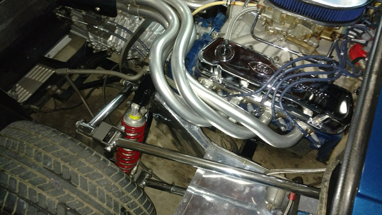

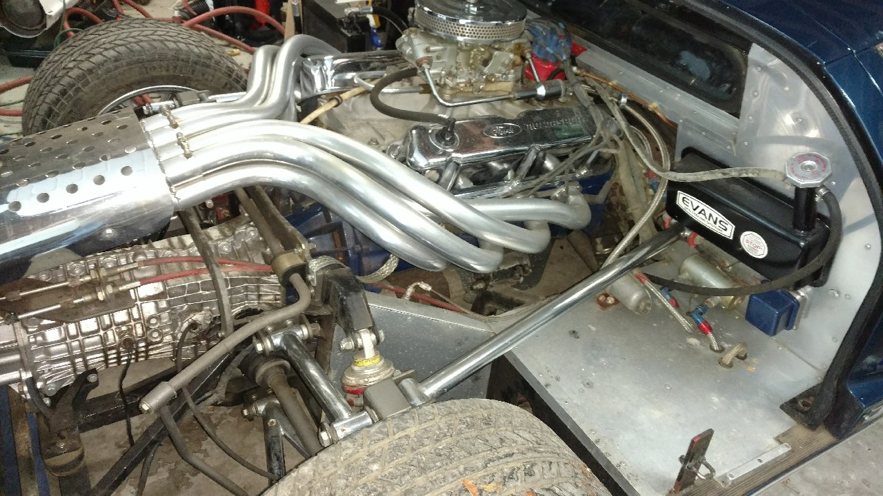

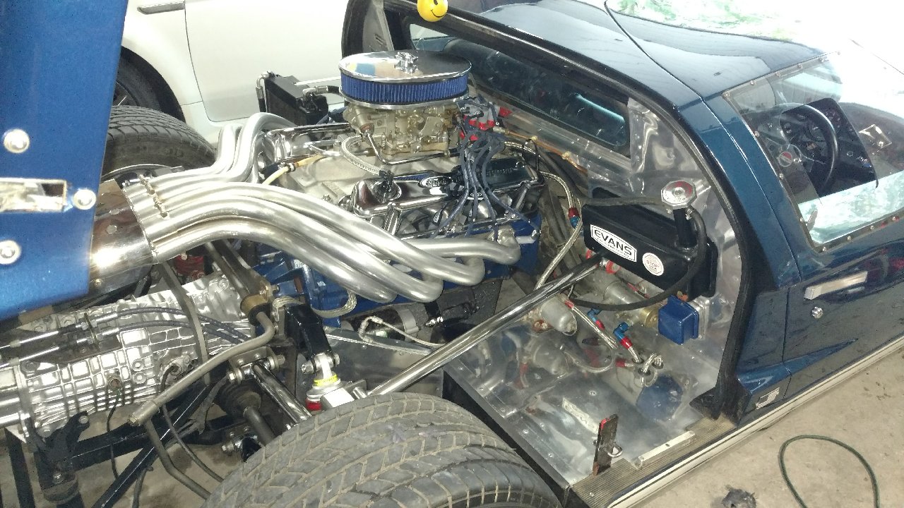

Ok so where I am at now is I replaced the throttle cable, seemed really stiff so I had a custom cable made. I have been going out in the shop every night for the last few weeks and working on the engine bay. My car seems to have been built with great detail but the sitting thing took away its luster. I have been lucky enough to have a lot of items that were chromed. All suspension arms are chrome except the uppers on the front. the exhaust is jet hot coated in silver. I have been hand polishing all the aluminum panels in the engine bay to a high shine, fortunately everything is coming back to life. I replaced the cap, rotor, wires, and updated the air filter assembly. Everything that comes off the car gets bagged and tagged.

Hi Dan what polish did you use on the aluminium as that is a job I need to do to my panels under the front clip.
Dan Kasten
Nick, I use a product called x-treem polish you can find it on ebay. The polish works the best I have ever seen. I use buffing pads on a drill to get oxidation off then it is all by hand. Rough surfaces I use a triple zero steel wool lightly and carefully to get where the aluminum can be polished. My advise would be obvious, do a test piece and get a feel for it first. I have also done a 1000 grit wet sand on the aluminum but never had to do it on the this car.
Dan Kasten
Nick, I use a product called xtreem polish. You can find it on ebay. I use buffing pads/cones to clean it up then its all by hand after that. Areas in bad shape I use a triple zero steel wool very carefully it is even possible to do really bad areas with 1000 grit sandpaper. I suggest to try the steel wool or sandpaper on test panel first not the car until you get used to it.
Dan, the pictures show you have done a great job bringing things back to life. I am sure you will find a lot of pleasure behind the wheel. The mk l has such a beautiful shape I could look at it for hours. More pictures if you can.

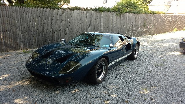

I switched it up today, it was too nice out. I decided to do a wash and wax on the car. I am in a little trouble. I needed 9 towels to plug up all the scoops, vents, and windows so no water would get in. My wife came home early and noticed I had used 4 of her "good towels" to wash the car, not going to be a good day for me. Here is another pic.
Mike Pass
Looking good Dan. Hopefully you can get to drive it soon. Don't worry about a bit of water - sooner or later it will be out in the rain. My GTD has been washed and hosed down dozens of times and been in many a downpour with no ill effects and is still going strong after 20 years.
