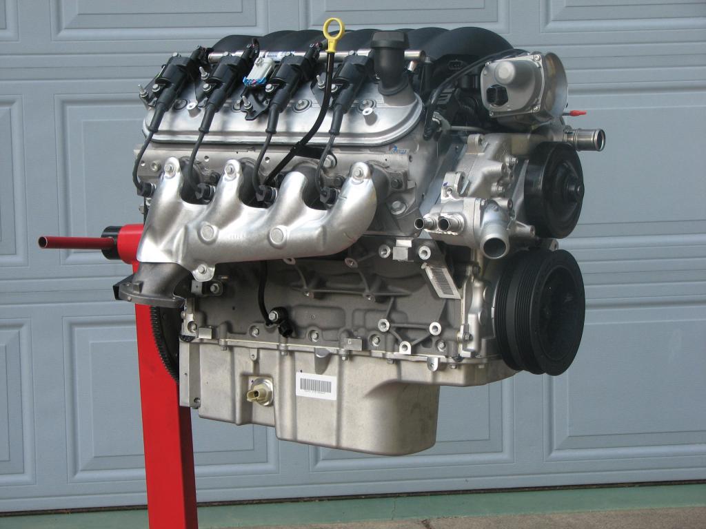

Attached is a photo of the engine as it was received. It is available from GM Performance through various distributors on the internet. I ordered mine from Jegs. Great price and free shipping. Ordered it on their website and it showed up in my garage. In addition, the electronic engine management system is supposedly a plug-and-play unit. It has the drive-by-wire accelerator , so will have to be modified for the Tilton pedals.
I call this the "Pre-op Photo" because this is as it appeared prior to various surgical procedures.
The Tilton pedals support your choice of either the traditional cable approach or the DBW (which is what most of us running these engines use) with a custom bracket supplied by Superlite.
Are you going to dry-sump the engine? The LMP can pull lateral g loads that will likely uncover the pickup in the sump in a hurry. Or is that what the "surgical procedures" are? :)

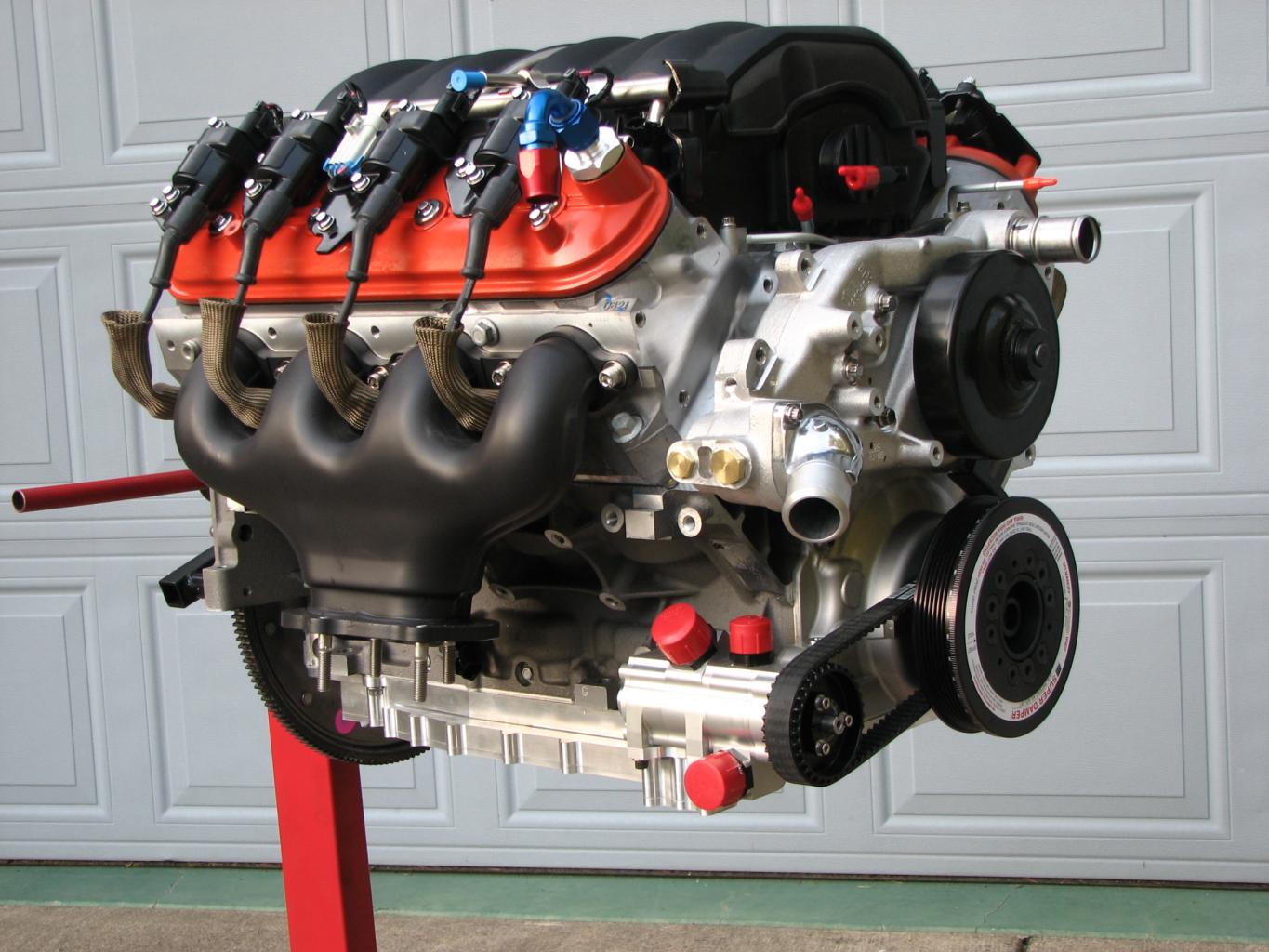

Yes I installed a dry sump. Here is a Post-op view of the engine. Some of the surgery was purely cosmetic, but others were reconstructive. The dry sump came from Dailey Engineering. Bill Dailey was a great help, providing me with exactly what I needed and the advice to install it. The pan is CNC-machined billet. A true work of art. There are NO scavenger lines. The pump pulls the oil right out of the pan, eliminating the external lines from the pan to the pump. I also installed an ATI Super Damper.
The LS7 headers are ceramic coated, which significantly decreases the heat around the engine. They were done by a guy here in Oregon. He does a great job, inside and out, and has several colors available. The black is the most insulating and durable. I am thinking about coating my stainless steel Ultima GTR exhaust, as the heat under the rear canopy is intense. The silver ceramachrome looks great but not as insulating. I had him put it on the headers and exhaust on my street-legal Lola Indy Car and it looks striking, like polished aluminum. He also has a titanium and even a white. I had him do the white on my Cobra Daytona Coupe exhaust and it looks awesome. Much more insulating and durable than the old VHT paint.
Other things I did to the engine involved reversing the intake with the parts from Katech Performance. Much of the hardware was replaced with ARP or other stainless bolts (its a personal thing). The heater fittings were also removed, tapped, and plugged. Who needs a heater in a race car?
The Corvette transaxle and rear end were built by Rockland Standard Gear in New York. Everything is waiting for the day the BIG truck arrives.

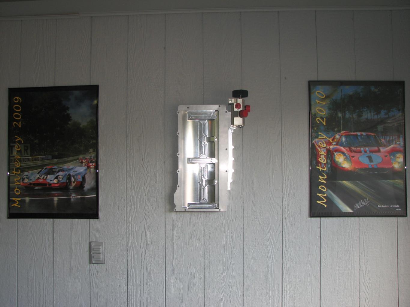

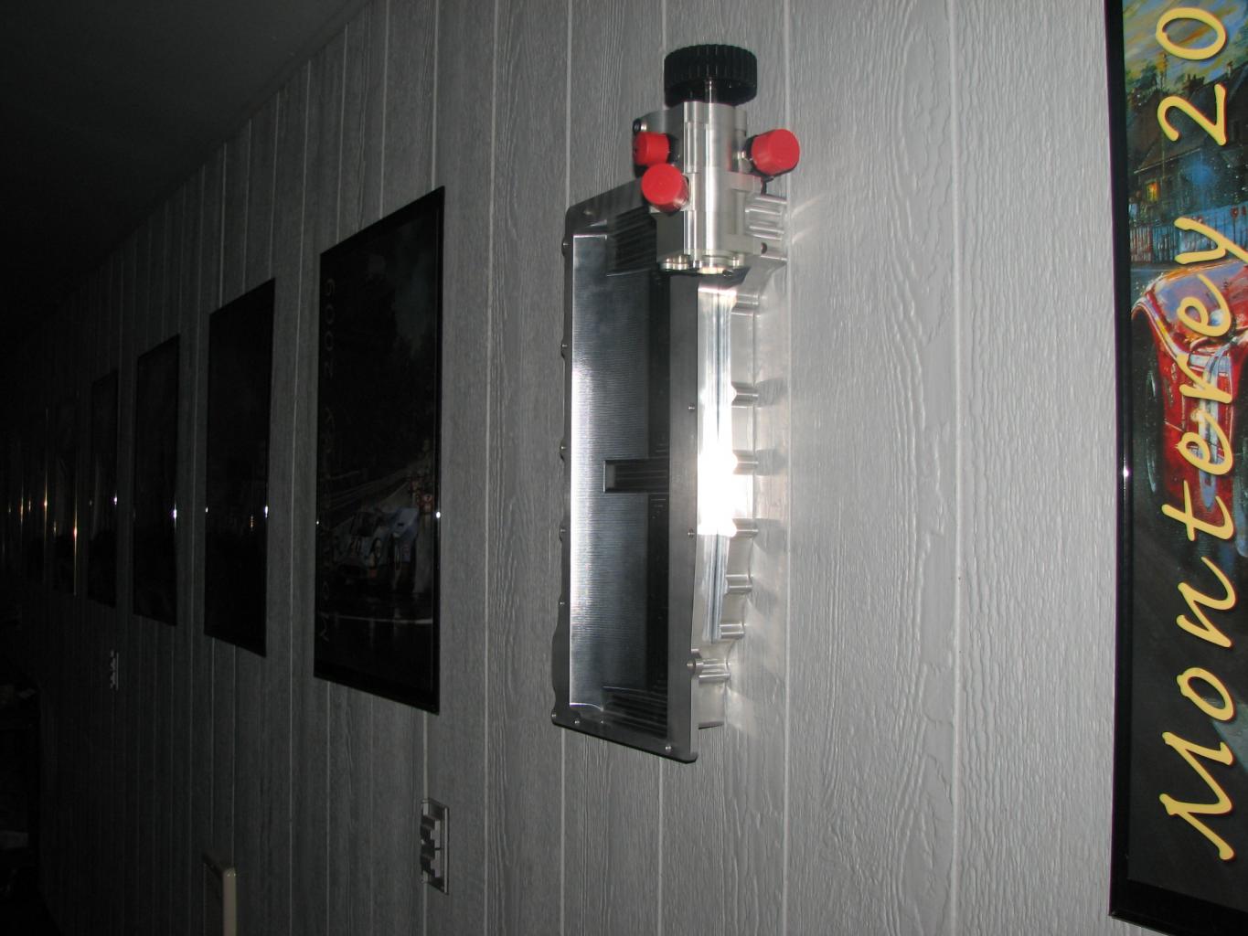

Just a couple photos of the inside of the Dailey Dry Sump pan and of the pump. Like I said before, a true work of art. So much so that I had it hanging on of wall of my garage before I installed it, between the Monterey posters of the 917 and the Mark IV. I need to buy another one for my next project as soon as possible, to give it more "Wall Time"!
