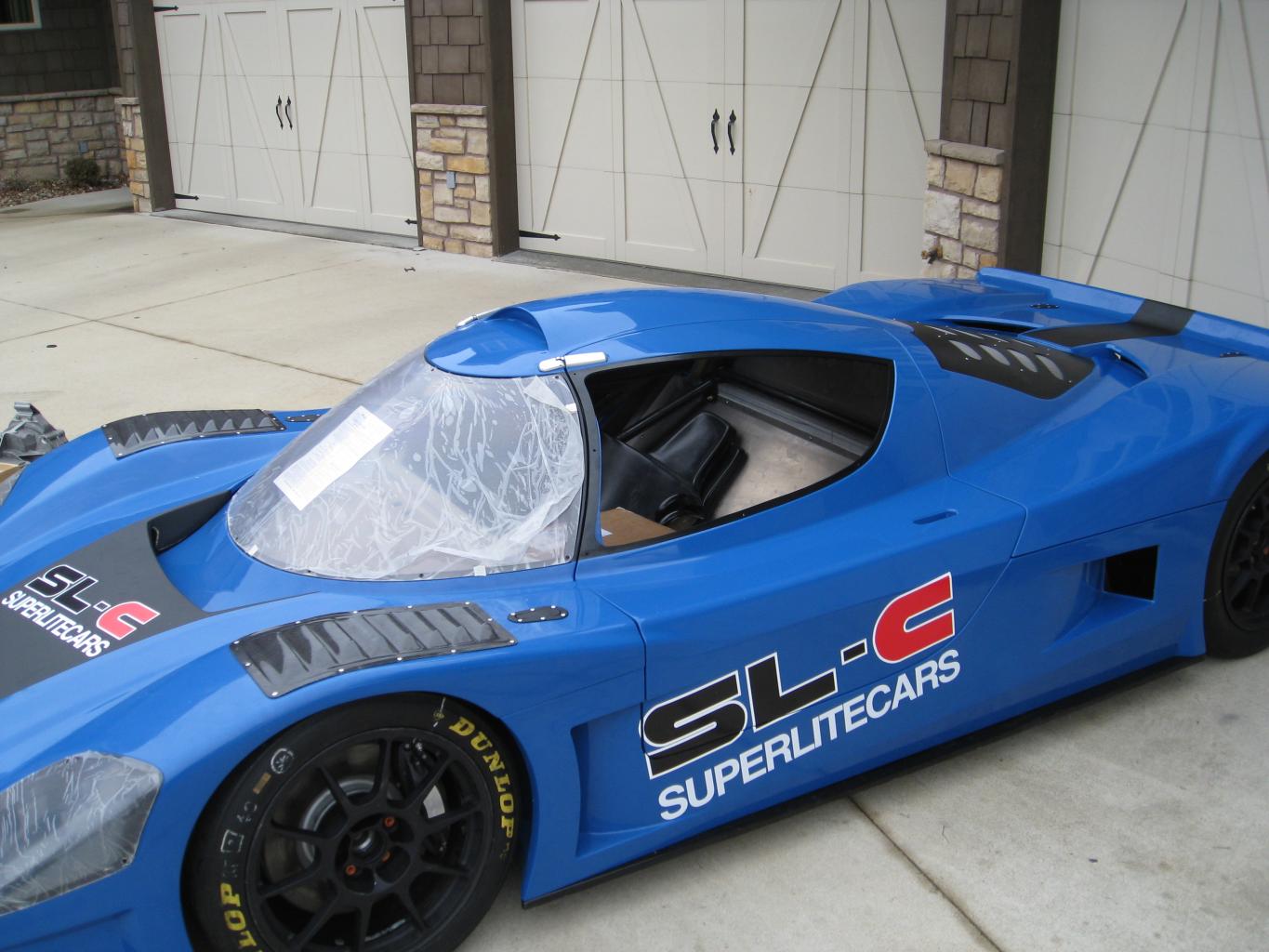

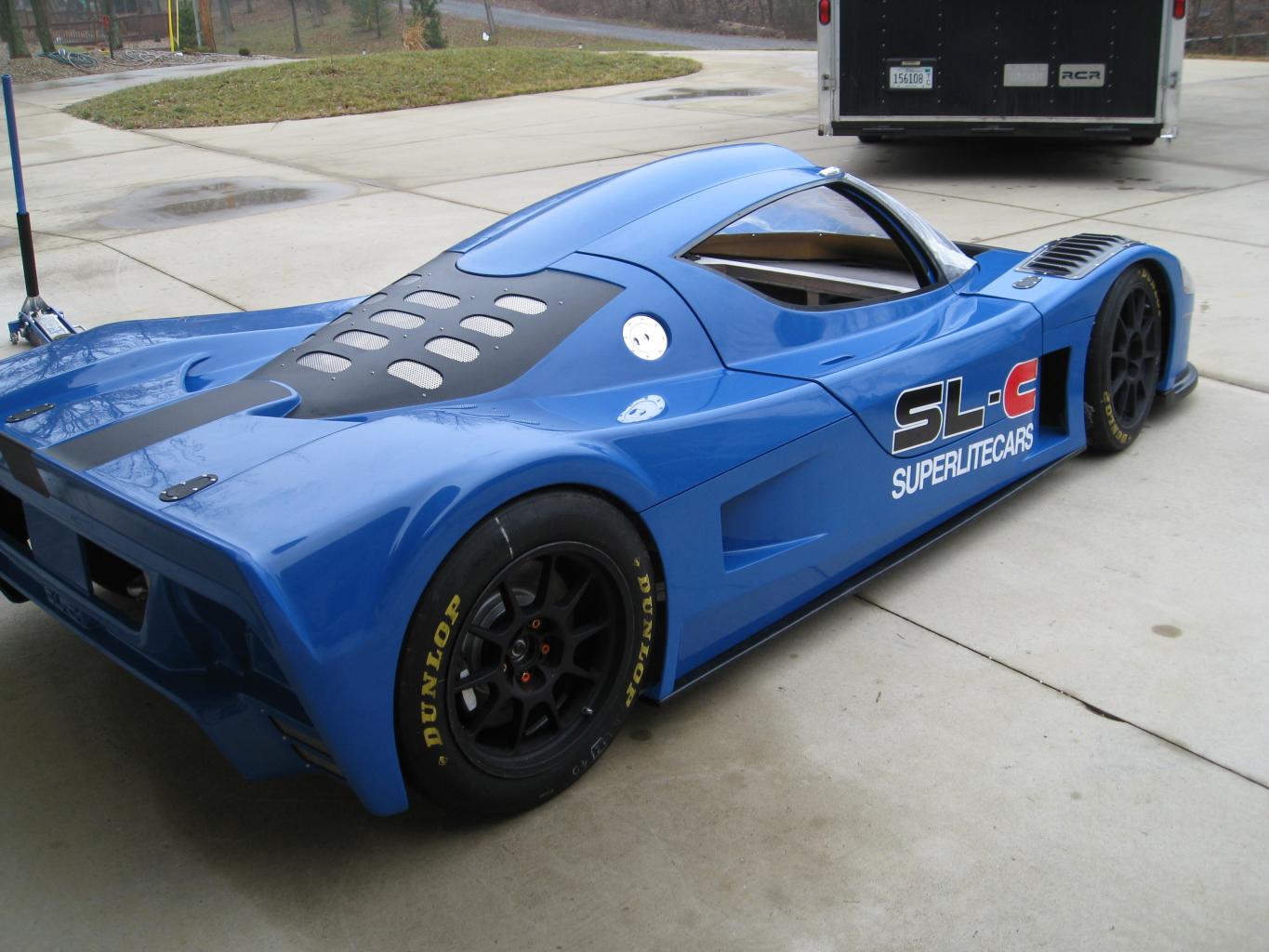

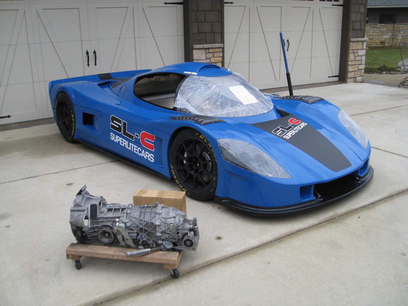

Thats it out of the trailer which was no small task. Even with a 4 foot extension on the door, it took a pile of lumber to get it out with out rubbing. I moved it into the garage and started unpacking. Apparently I left some stuff at Fran's shop.:shrug: It was getting pretty late and I had a long drive ahead of me. No big deal, there's plenty to do.

Well I got the car in the garage and took the front and rear off the car. That way I could see what I'm dealing with.
There is a lot of stuff here. I had a chance to lay ever thing out and get a good look at it. When you first get a car like this it is so exciting you just don't know where to begin.
