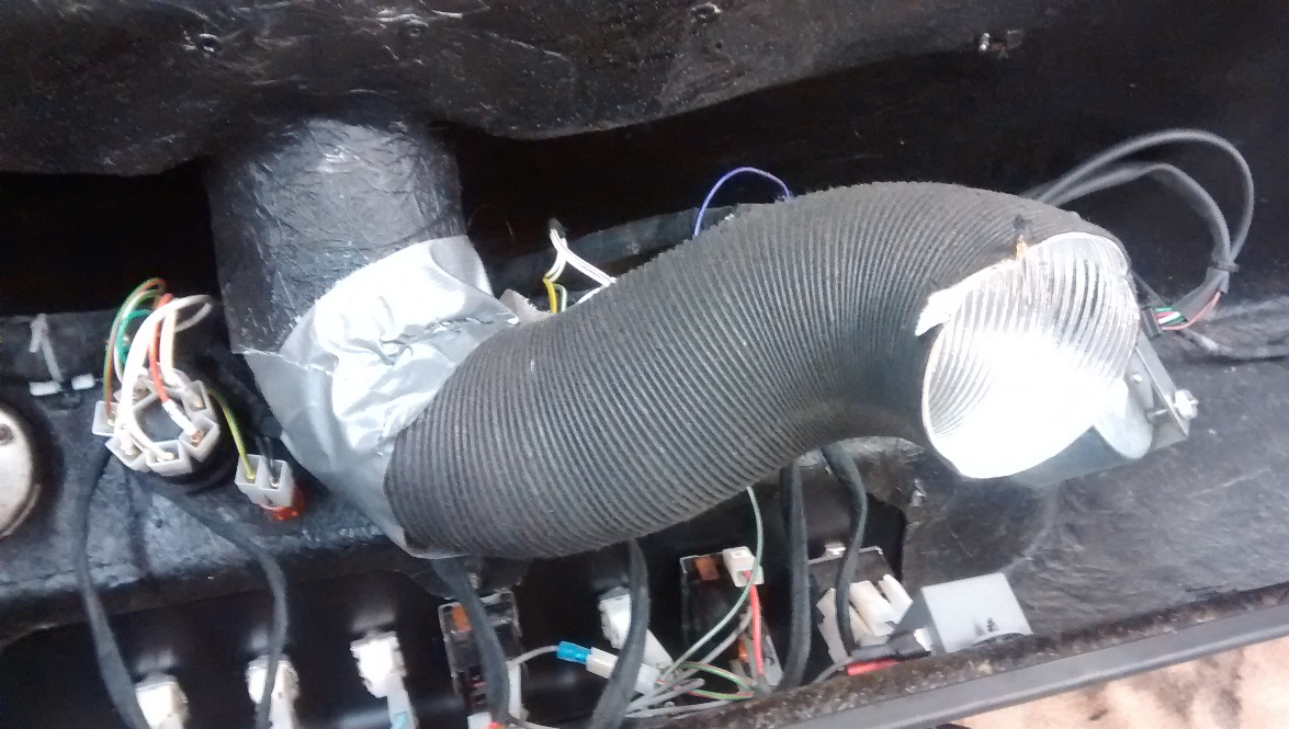

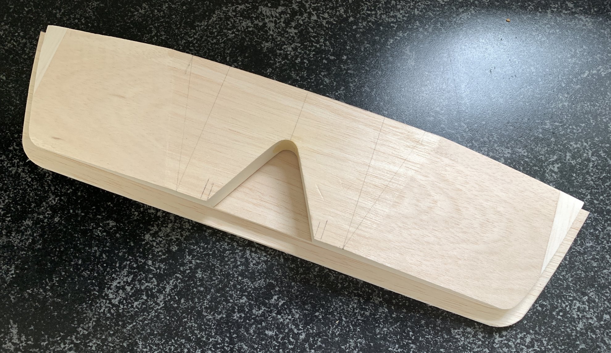

Presuming you mean the screen vent, it’s a coincidence that I’ve currently got my dash out for a few minor mods. I glassed in a tube to accept a flexi tube from the heater unit, however to make the system work, the exit from the vent needs guide plates to keep up the air velocity – see attached pics.

These are just some simple deflector plates up to fit below and original Zephyr grill, to keep the up the air velocity.

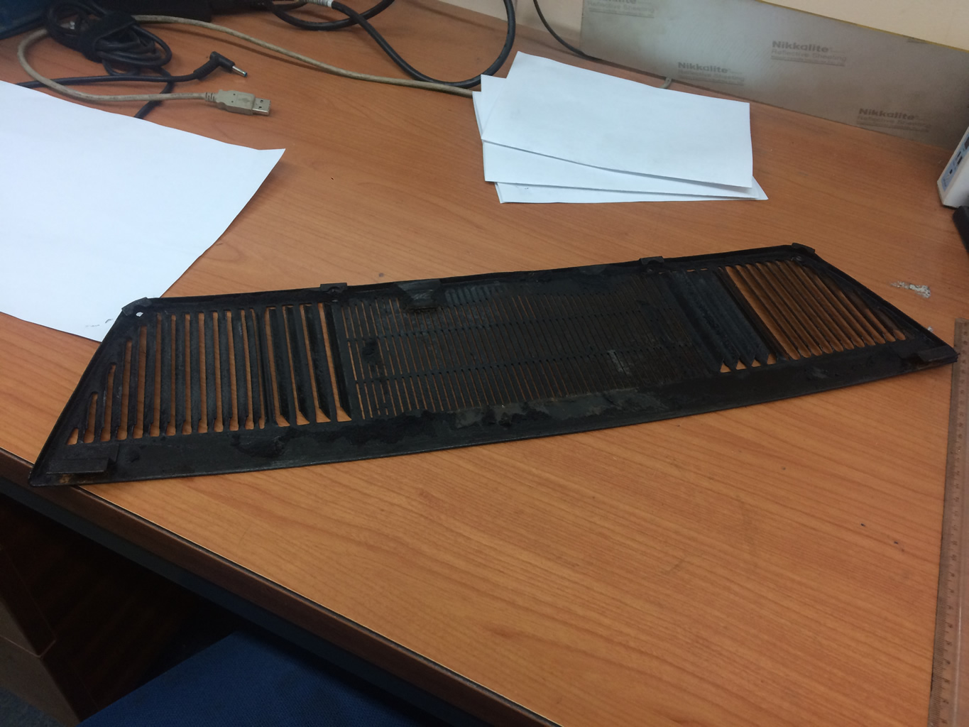

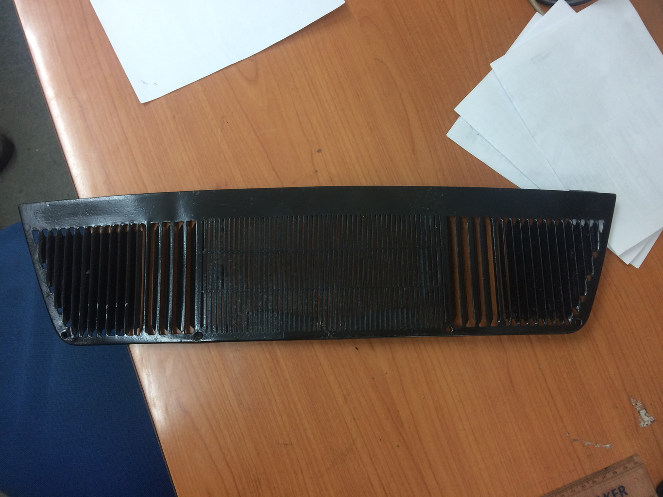

I’m fiddling around with mine at the moment. I think I have the latter 65 Zephyr grill/vent. It’s a bit bigger than the dash opening I have (in both dashes, I have 2 of them that are different) and also has the curved up bit at the windscreen edge.
Does that sound right. Do I need to source a different vent?
Ryan

Both1965 Zephyr vent panels have the same footprint. Most of the fibreglass molds out there are copies and show shrinkage everywhere, hence the fitting problems.
The later "facelift" grille which as you described, has a curved front and not strictly original.
I am rebuilding my dash top at the moment and made a new mold for the diffuser tray for hopefully a better fit for the flat fronted panel to the venturi. The trouble is getting the panel to flex slightly over the vent box duct - about 1-1/2" deep and 8" wide clearance.

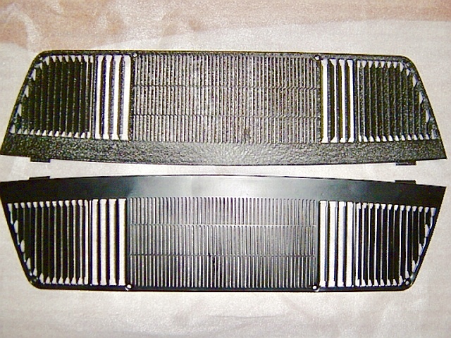

Below is an old photo of two original grilles that I got and these are curved along the front and flat. The front tangs or tabs as Morten mentioned previously go into slots in the dash recess.
The crinkle finish one on top is now on Alistair's car.

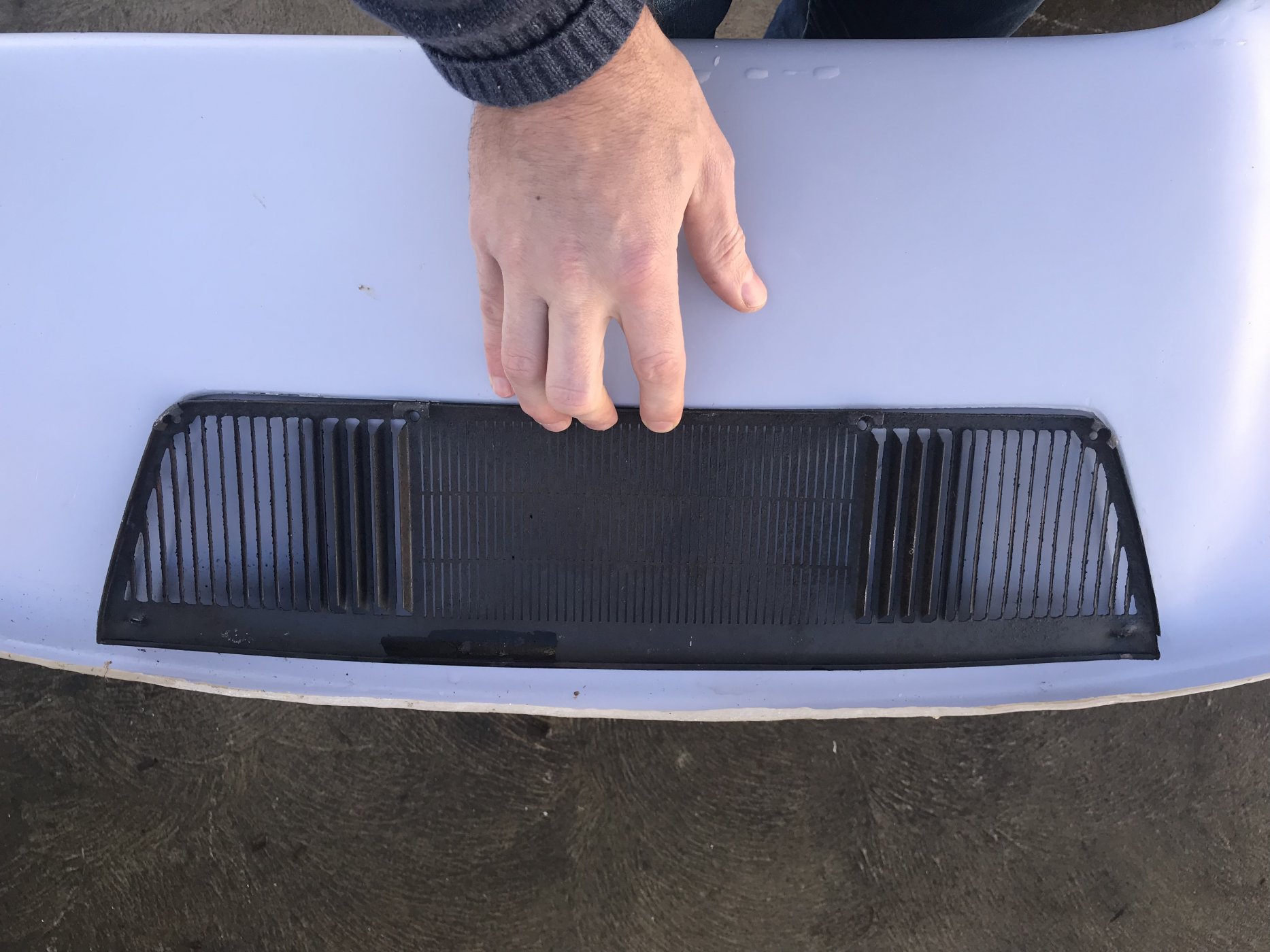

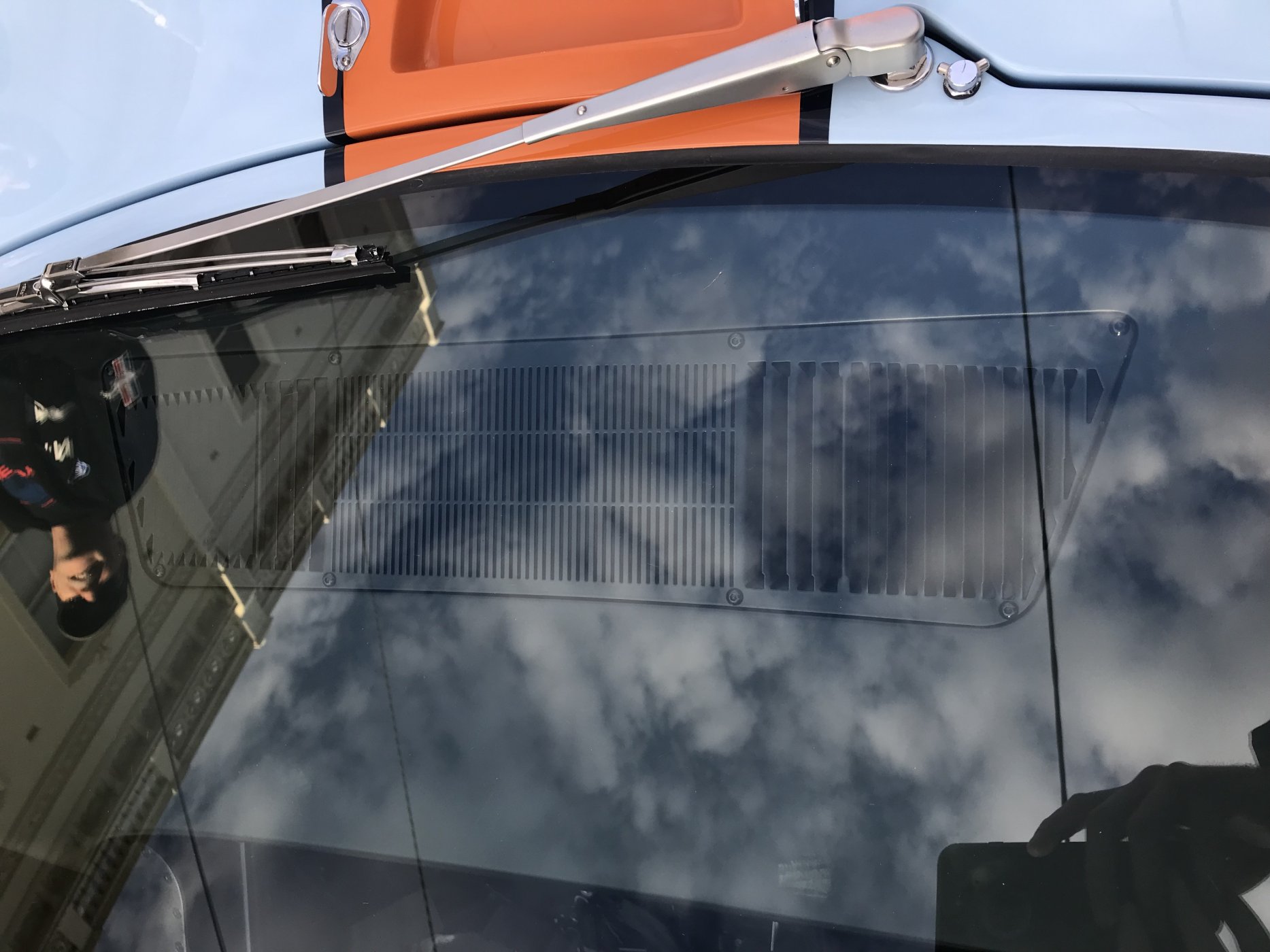

I don’t mind the straight section, it’s hard to tell these days what is right. Most people will never have seen an original. What I do like is that it’s flat and follows and matches the shape of the dash nicely.
The “original” ford grill/vent that I have has a curved lip that bends up to meet the windscreen. I did find a photo of one installed in a zephyr or zodiac and it matched the shape of the dash and looked fine. Just looks odd on my GT40 dash I think.
I think I could scan and redraw the vent cover that I have, then get it laser or water jet cut.
