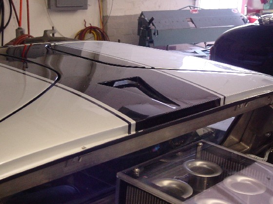

Here is the NASA duct that Ian (Canuk 40) spotted in another thread. I think it is unique to this particular CAV. The car was spected for racing with no air conditioning until I added it for my use.

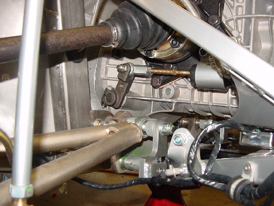

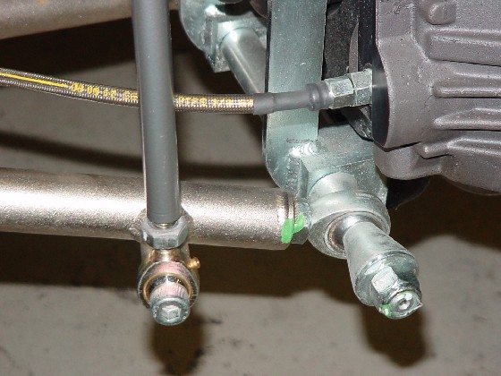

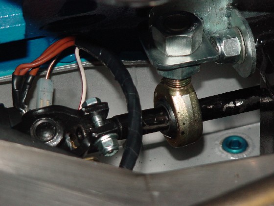

Another thing unique to this CAV was the additional heim joint suspension pieces.

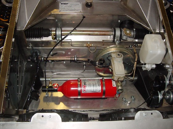

Front "luggage" area with Fire System. The horn and washer bottle have been moved to the drivers side to offer more room for a bag or bags.

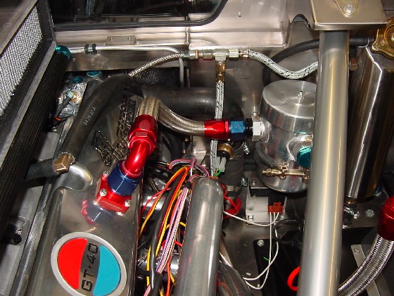

Here is the single breather plumbed to a catch can on the firewall behind the roll bar support.
All the colorful wires are going to be hooked up to the ECU.

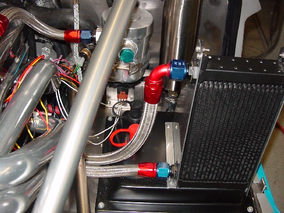

Battery mount under the oil cooler with positive & negative post access.

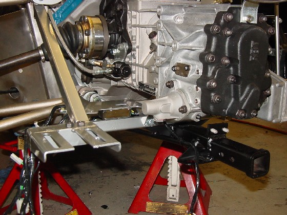

Trailer hitch. Secured at a rear transmission cradle, at the square crossmember and with a bracket to the ZF.

John: 6,000+ miles, 17 track events, 9 days, no support vehicles, and no storage room in the 40 for even the two helmets = Trailer Hitch!

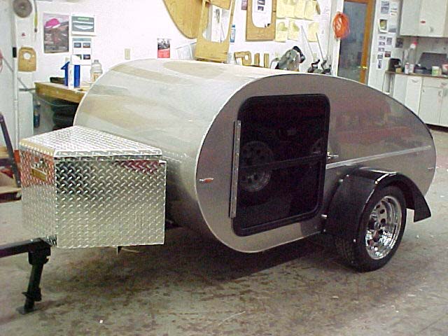

Nothing wrong with a hitch. Here's what I pull with my GT.
This thing has A/C, DVD player and a memory foam mattress for super comfort. I carry a portable stove and a small 110V-12V frig.
On week end shows me and the wife stay overnight in a campground. I'm getting ready to put the black stripes on it to match the GT. The outside is all stainless steel satin finish.
