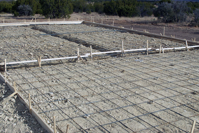

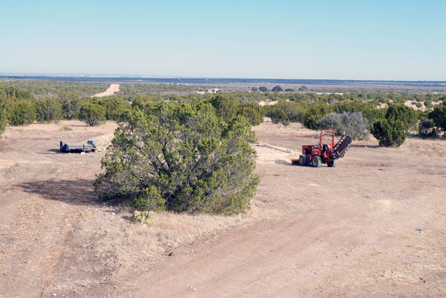

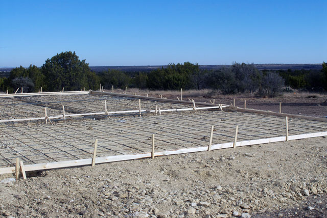

We just got started on my new shop. Overall, 30' x 60' divided into a covered 20' x 30' front and enclosed 30' x 40' shop. It will be red steel welded, insulated, roll-up door, bath/shower room, skylights, eaves vents, 110V/220V all around, stationary compressor with piping and drops, 2-post lift, epoxy floor, outside 220V welder plug and water on porch.

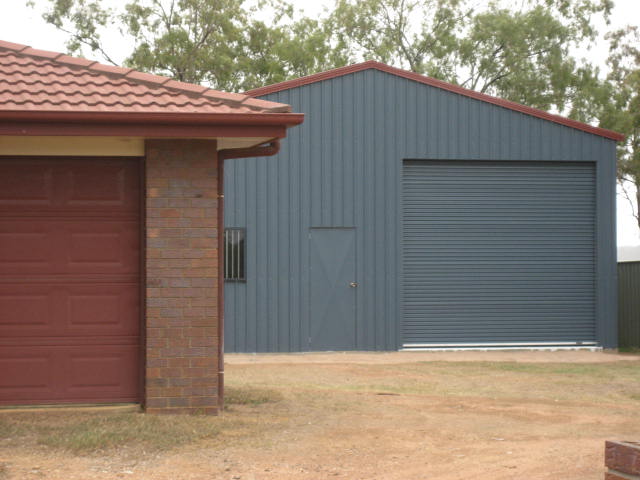

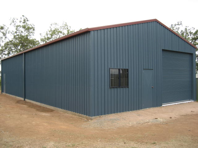

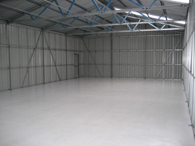

Yeah, man cave! 30x60+ height. Insulation is a must in these things as its like a fridge in the winter and like an oven in summer.

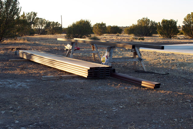

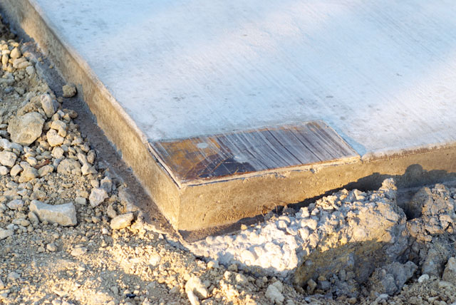

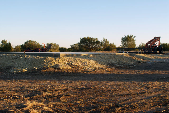

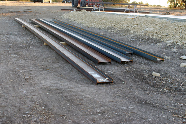

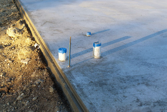

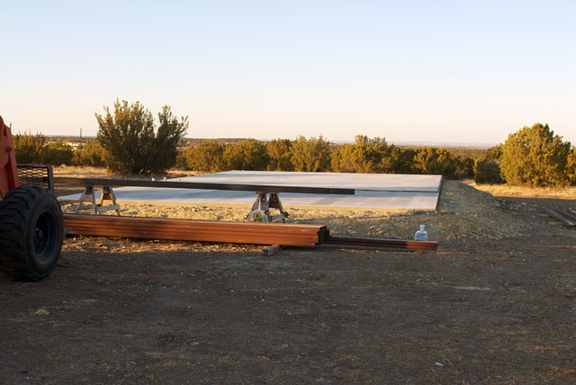

A few photos: There are Plates in the slab for each post. All welded red steel posts and beams. The longest I-Beam will run the length of the shop for the trolly.

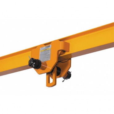

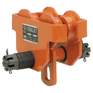

Little update: Met with builder Sunday to go over some details/changes. One change will be to change to opening ridge vents rather than eaves vents. Going to use boxed beams rather than C-beams outside under front porch to keep birds from nesting inside C-beams. Gutters will go to 55-gal drums (my "green earth contribution" :thumbsup:) for water catchment. I purchased this 2-ton trolly from Harbor Freight to run along the center ridge I-beam.
