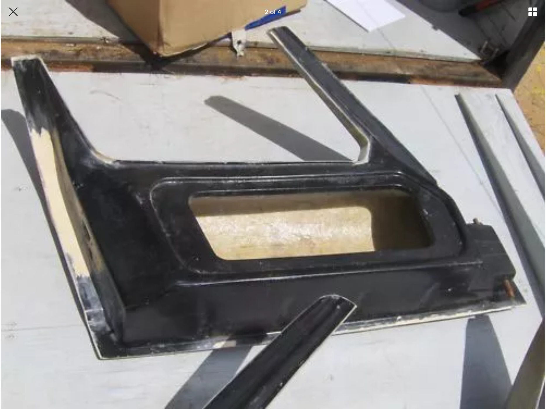

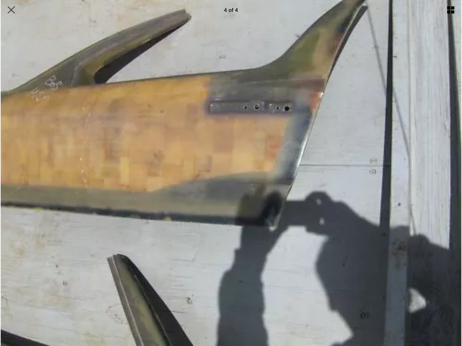

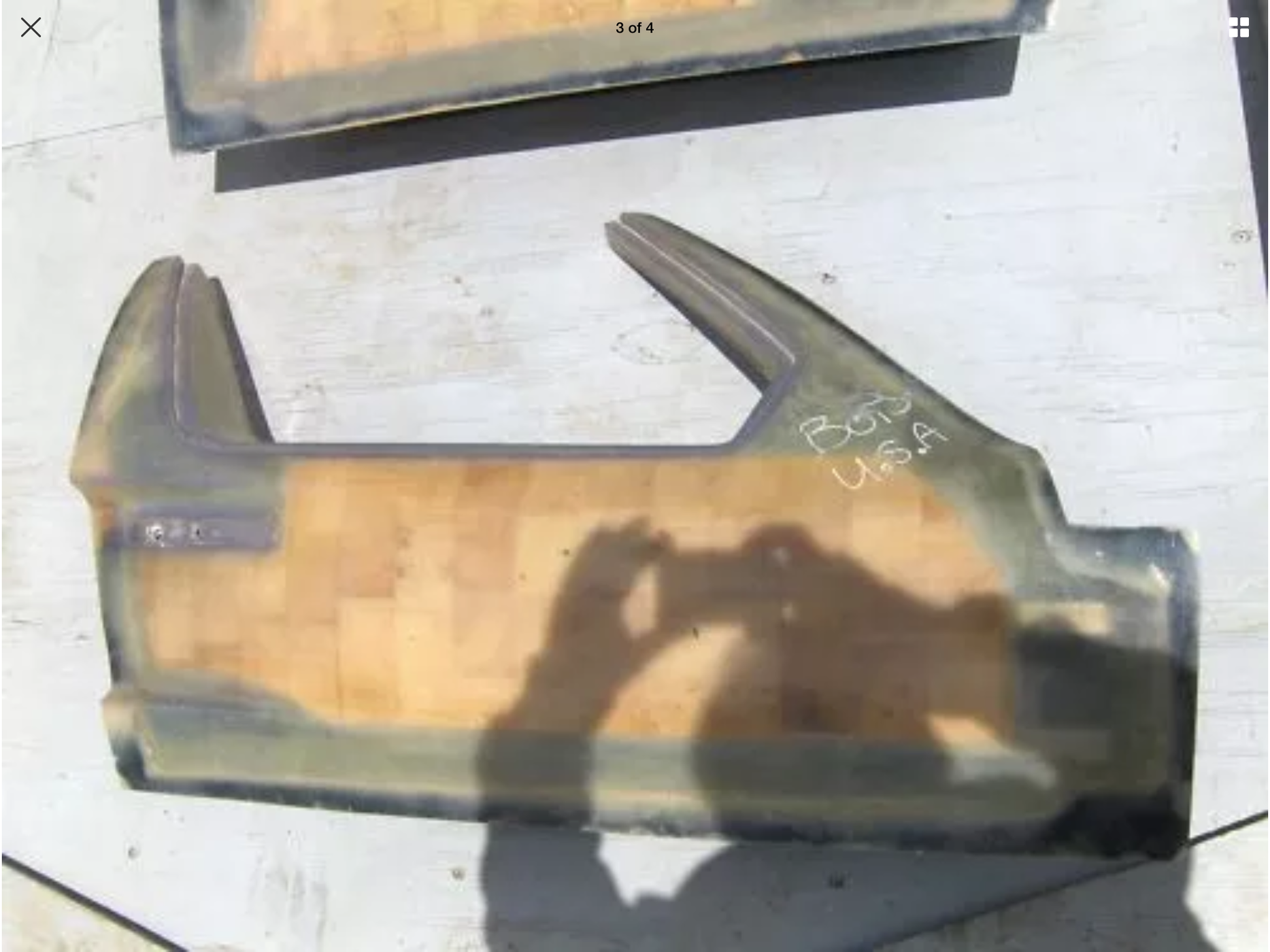

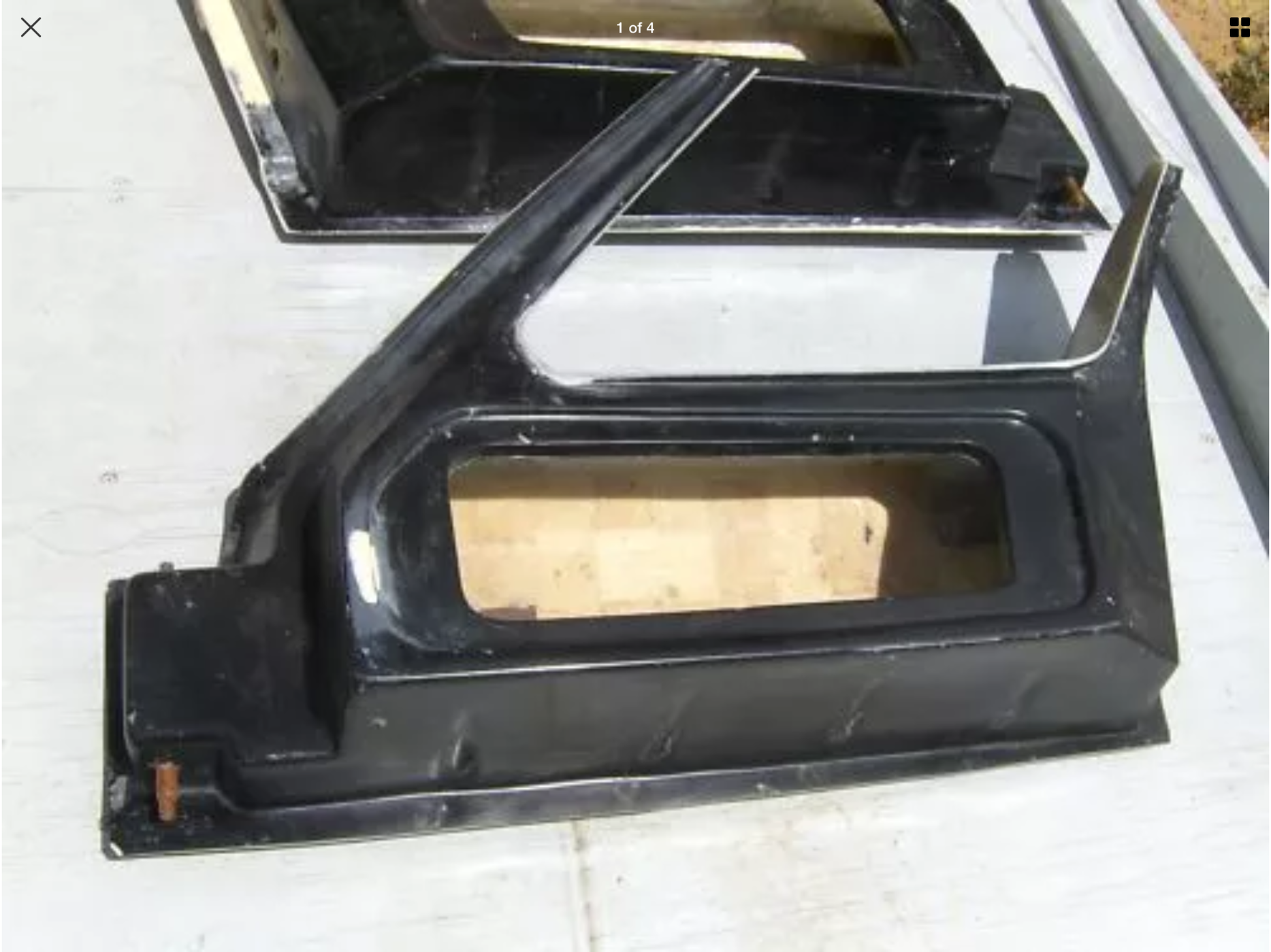

The fitting of the doors within the spider are the most complex panels in the entire car.
I understand you are on a tight budget, but I would be remiss if I didn’t give you this warning -
At the very minimum, you should purchase the doors and spider from the same supplier.
#3
OP, Randy,
You wont be able to fit the front or rear clips easily either as they wont match up between replicas!! A HOT MESS to say the least....... I would recc. you buy the body all together from one source. (unless of course you or a GOOD friend are great at repairing fiberglass/corvette/boat parts) . Scott
JimmyMac
Member
#5
OP
Are you positive that those doors are ex-CAV ?
The shape of those window openings also look odd and the word "replica" is often a misused term these days so I agree with Randy and Scott.
I see from your avatar that you already have spider to work from but five hundred dollars without a trial fit of these seems a lot of wages for mystery scrap doors needing major work (even if they had the tops intact).
