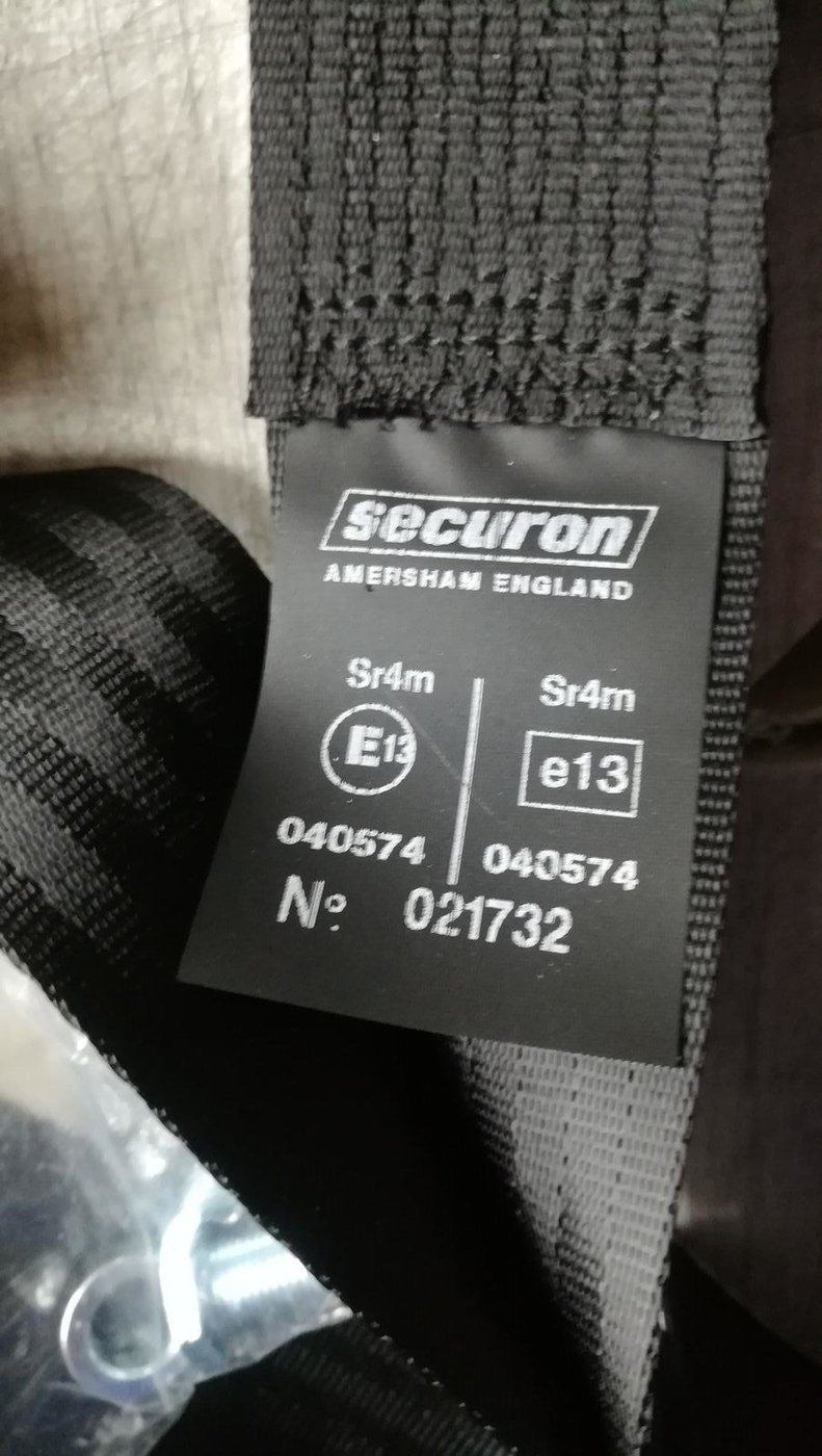

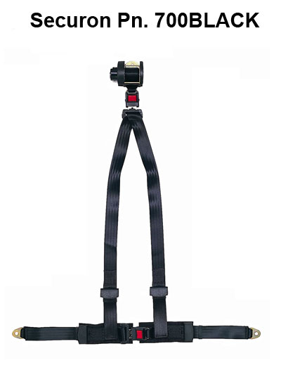

I have been looking at the SECURON 700 Harness and have purchased a pair with a Date of Manufacture of 2017, this was the last year Securon had there Harness Belts Certified to ECE R16/04.
Due to the low volume of orders they are not going to get there Harness Belts Certified to the current EU ECE R16/06.
The Corbeau Harness is NOT Certified for Road Use, Off Road Only.
Now I have to get my car "Engineer Certified" this year, before they say the belts are to old.
