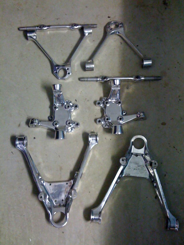

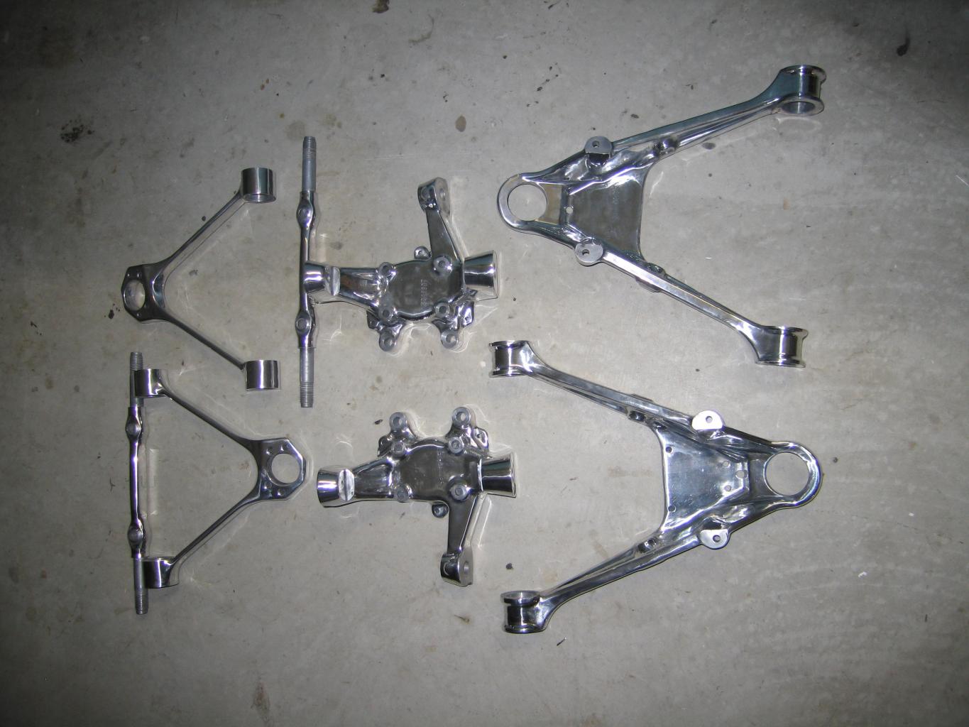

First was to sort out what I had and to make it look pretty, so off to the polishers to make the front end look shiny and as they did that, I got all new bushes and wheel bearings from the States. Being that the front suspension is from a Corvette and the rear is custom but uses Corvette brakes and hubs, once the front arms were back, I needed to fit the bushes (not the easiest of jobs) but done and fitted to the car.

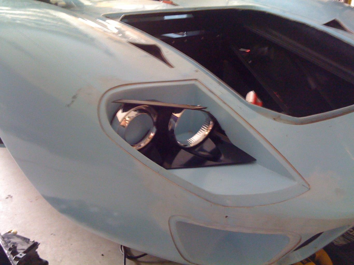

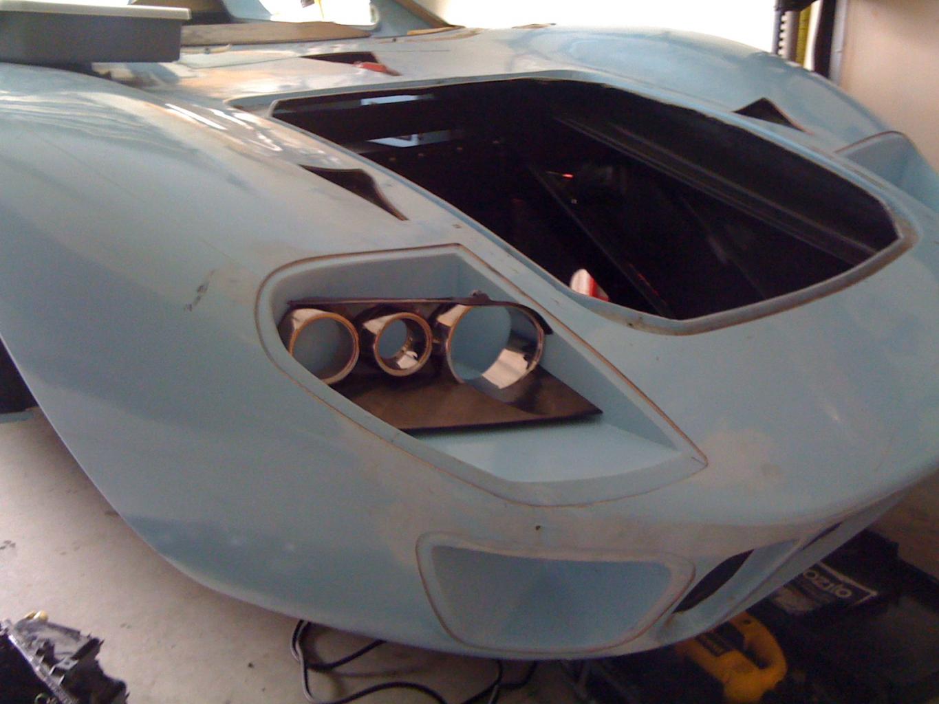

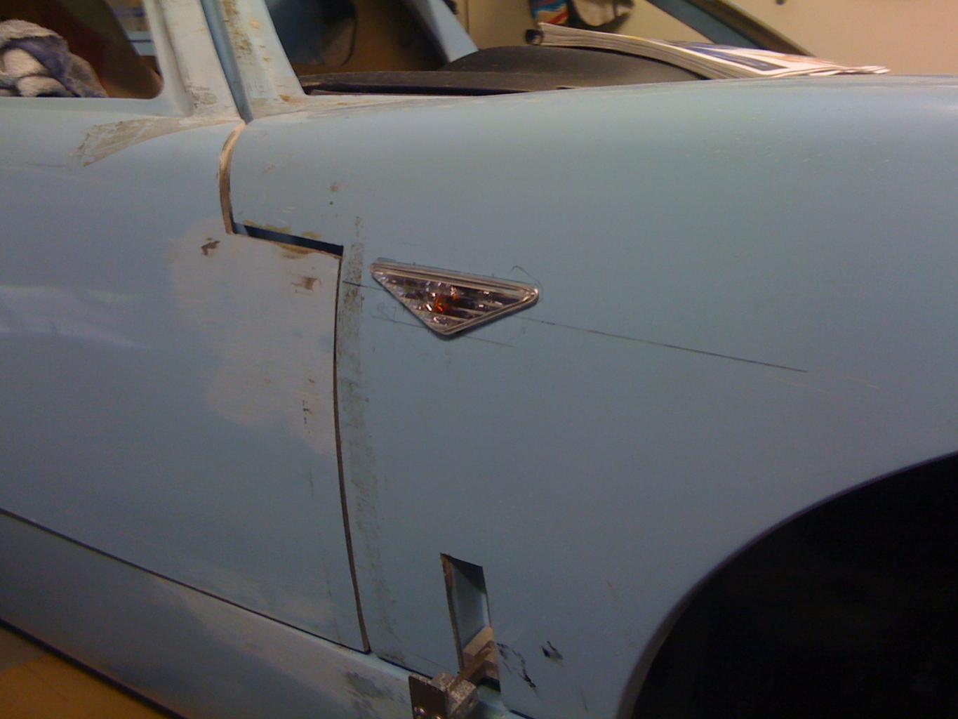

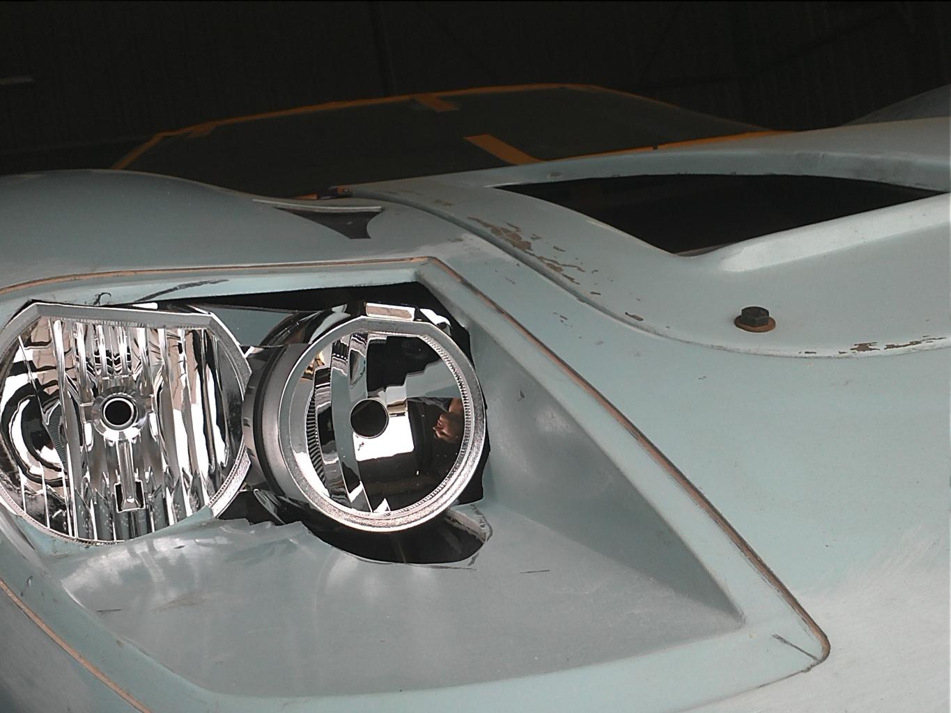

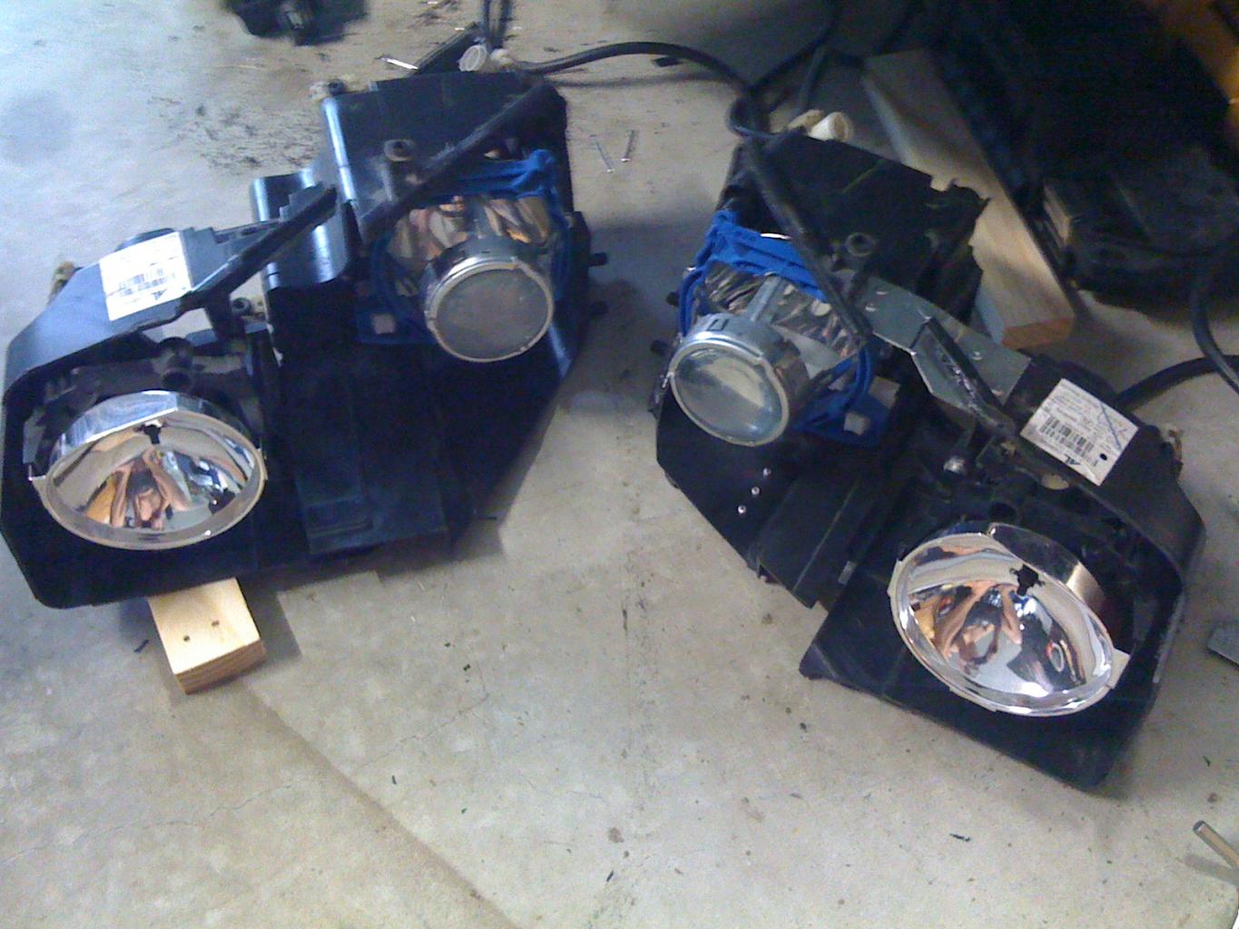

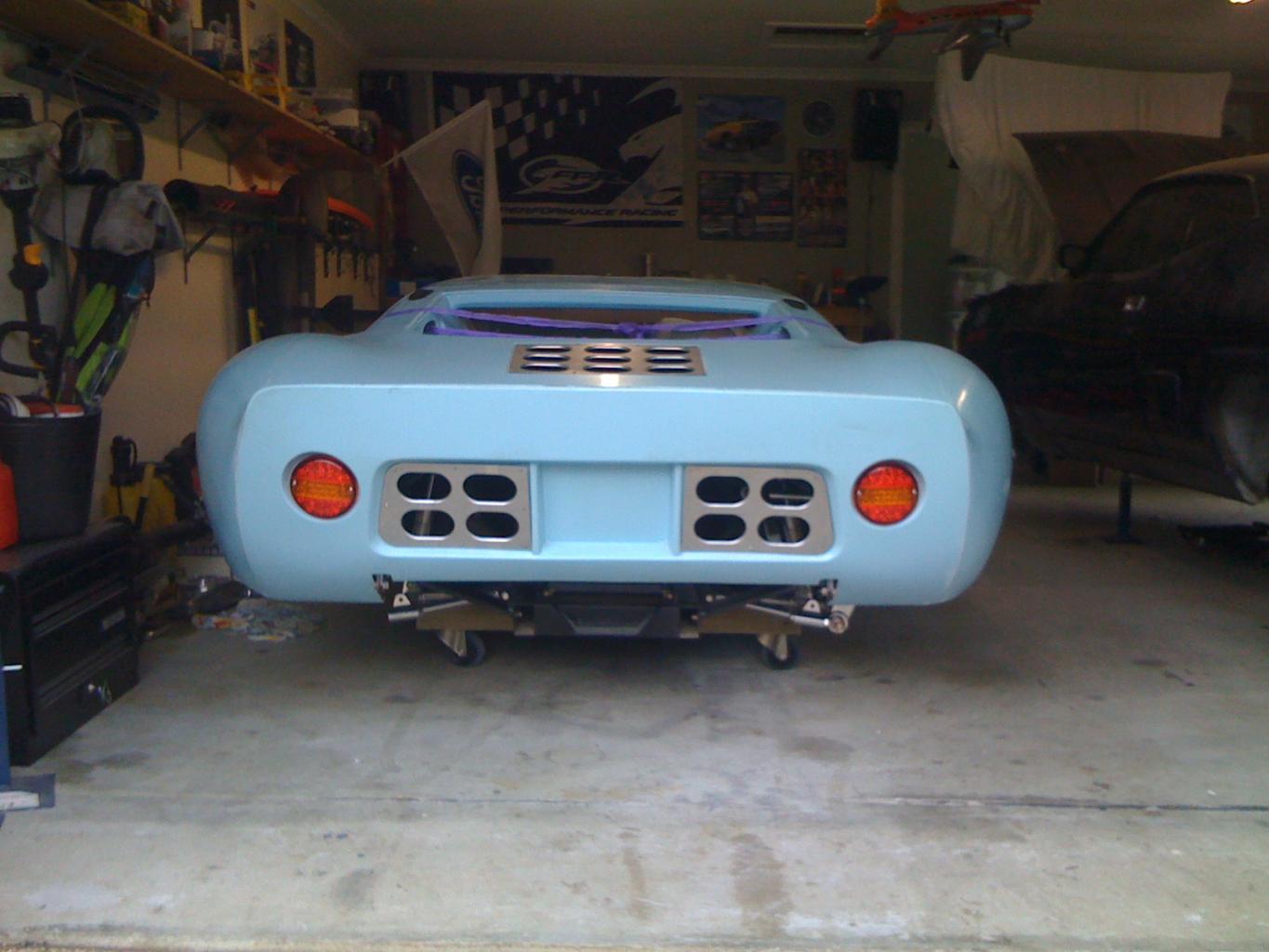

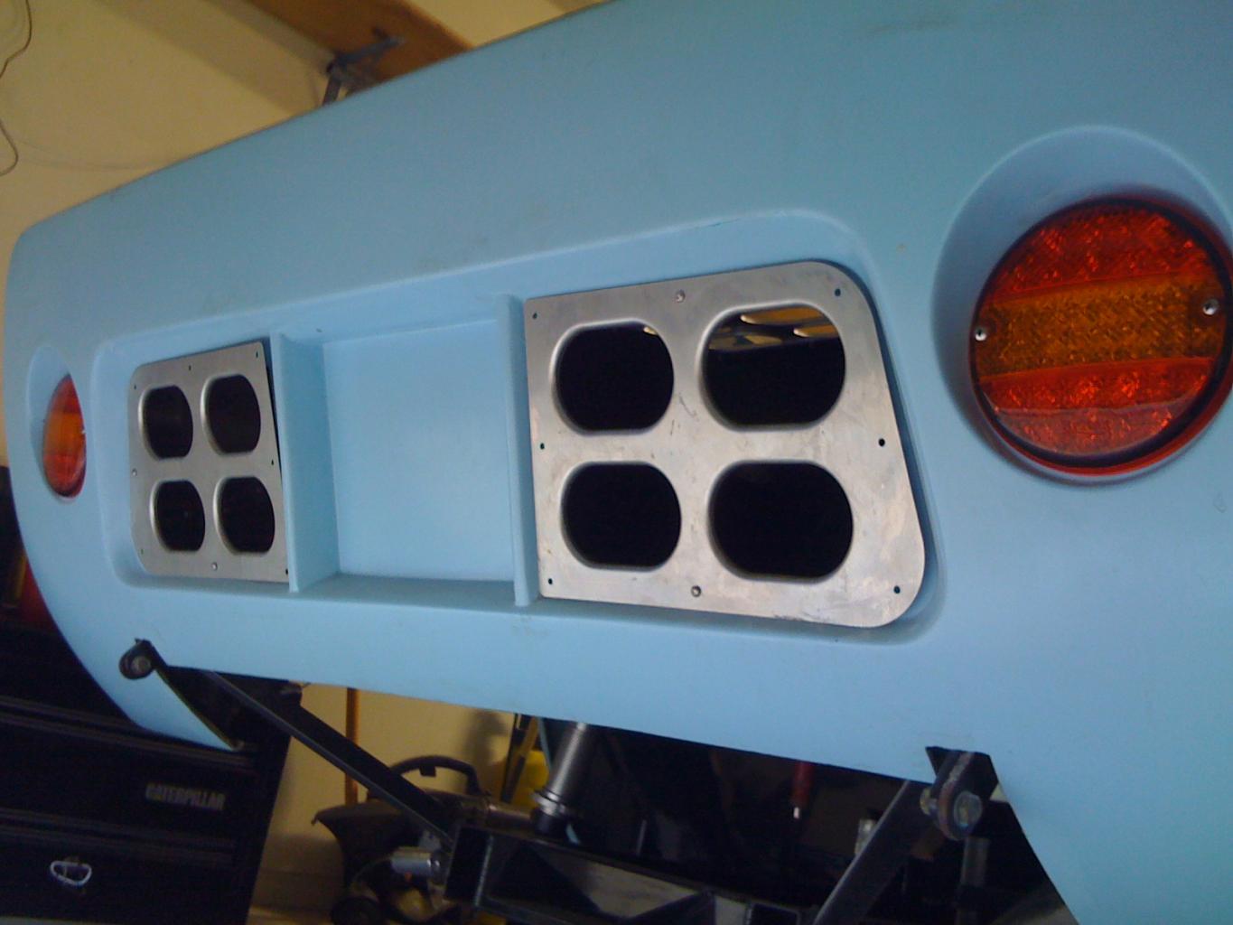

Next was the lights, I went for LED tail lights in original style because they look nice and are brighter. I figured if someone sees a GT40 driving down the road they aren’t going to be looking at the brake lights and I don’t want a 4WD attached to the rear of my car. For the repeaters I went for Falcon ones just for something different, for something completely different for the head lights I decided to try and fit some lights from a late model car to them (sounds like it would look odd but bear with me on this) first was Mazda 3 head lights but after starting I didn't like the way the inside light cut down, so next was Mazda 6 MPS lights, these had potential but the high and low beams were on the outer edges of the lights so after a lot off cutting and grinding I got them fitted and wired them up to see how they looked… still wasn't completely happy with the look but more on that later.

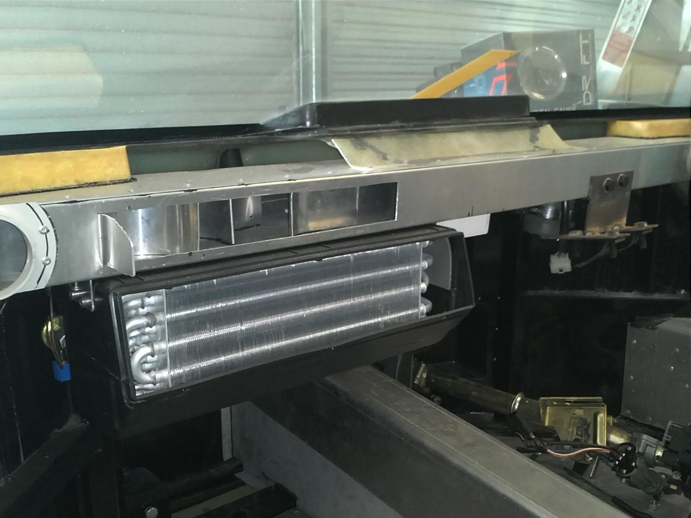

Next up I wanted to work on the wipers and A/C. The inside wipers were straight forward, spend money with DRB and then fit. One thing I could do was make the A/C ducting / steering column mount - I made it out of aluminum so that I could fit my own ducting inside to help with air flow and save weight.

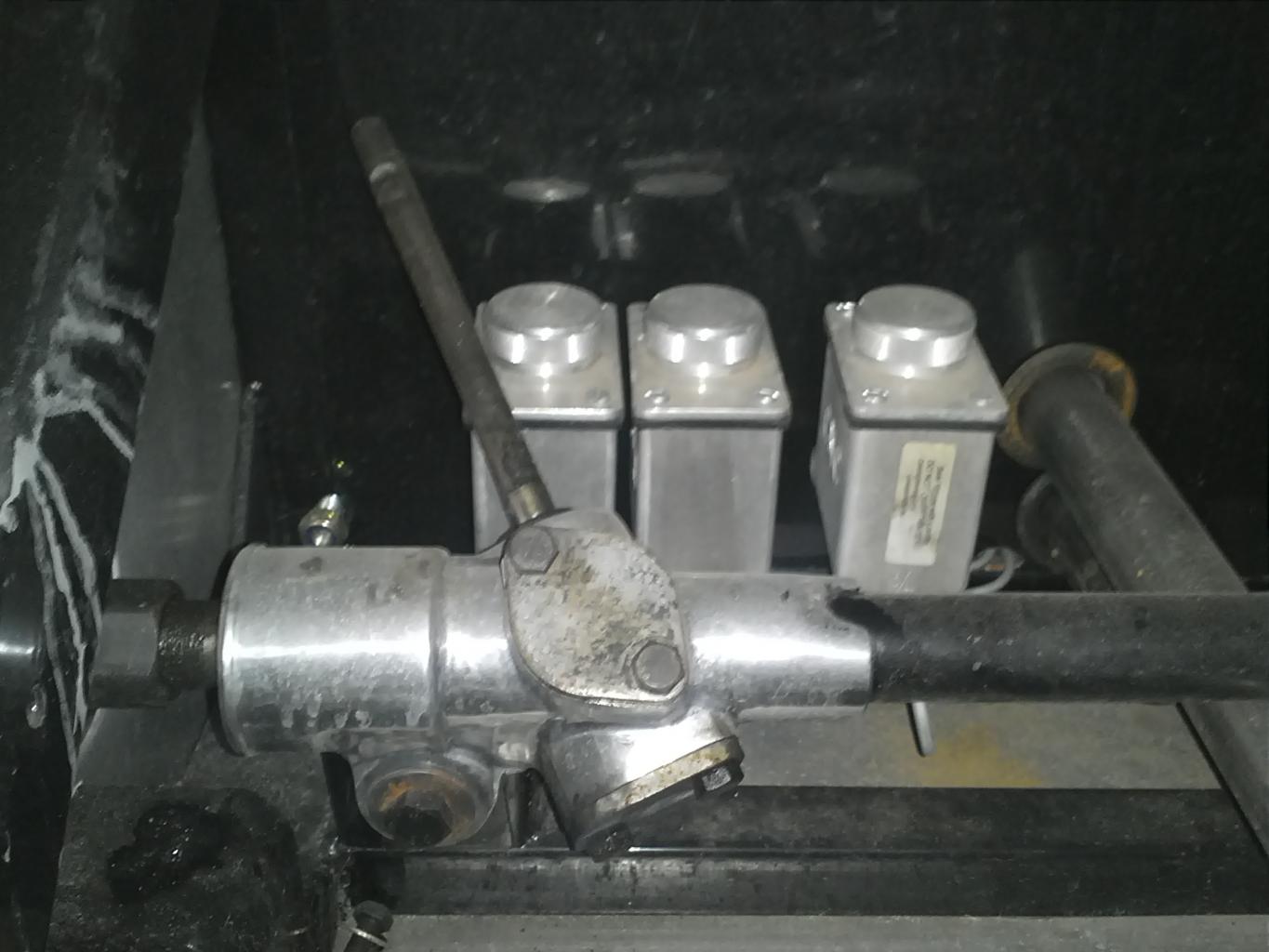

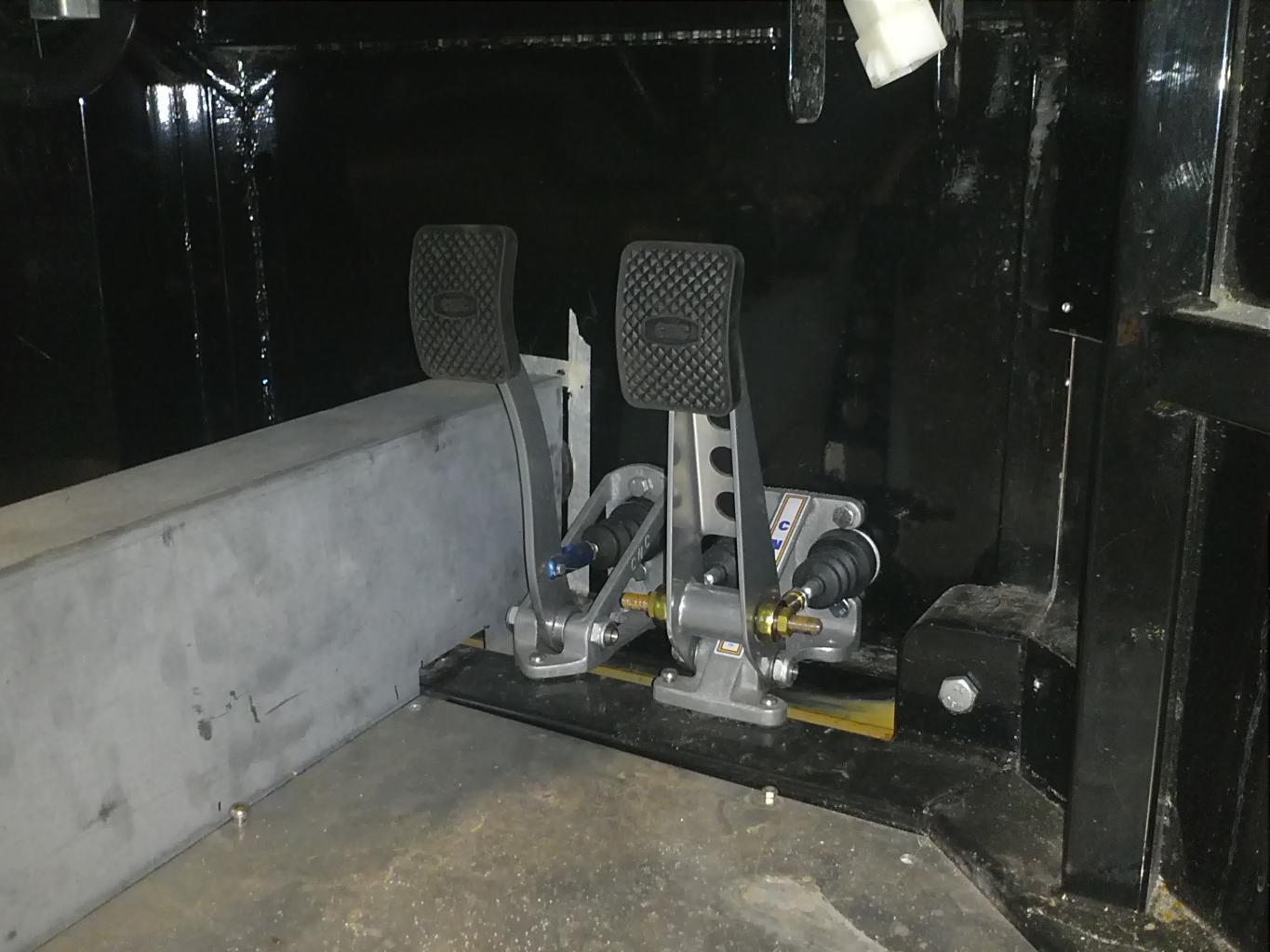

I then fitted the brake and clutch pedal assembly’s using CNC products as I had used them before, ran all the fluid lines through the center console with the coolant pipes, and then fitted the floor panels to finish it off.

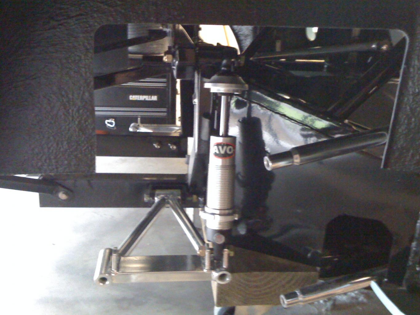

Rear suspension was easy, again spent money with DRB then get all parts ceramic coated to make it look nice.

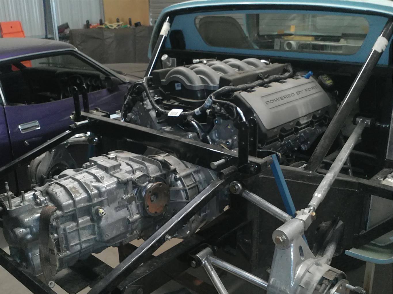

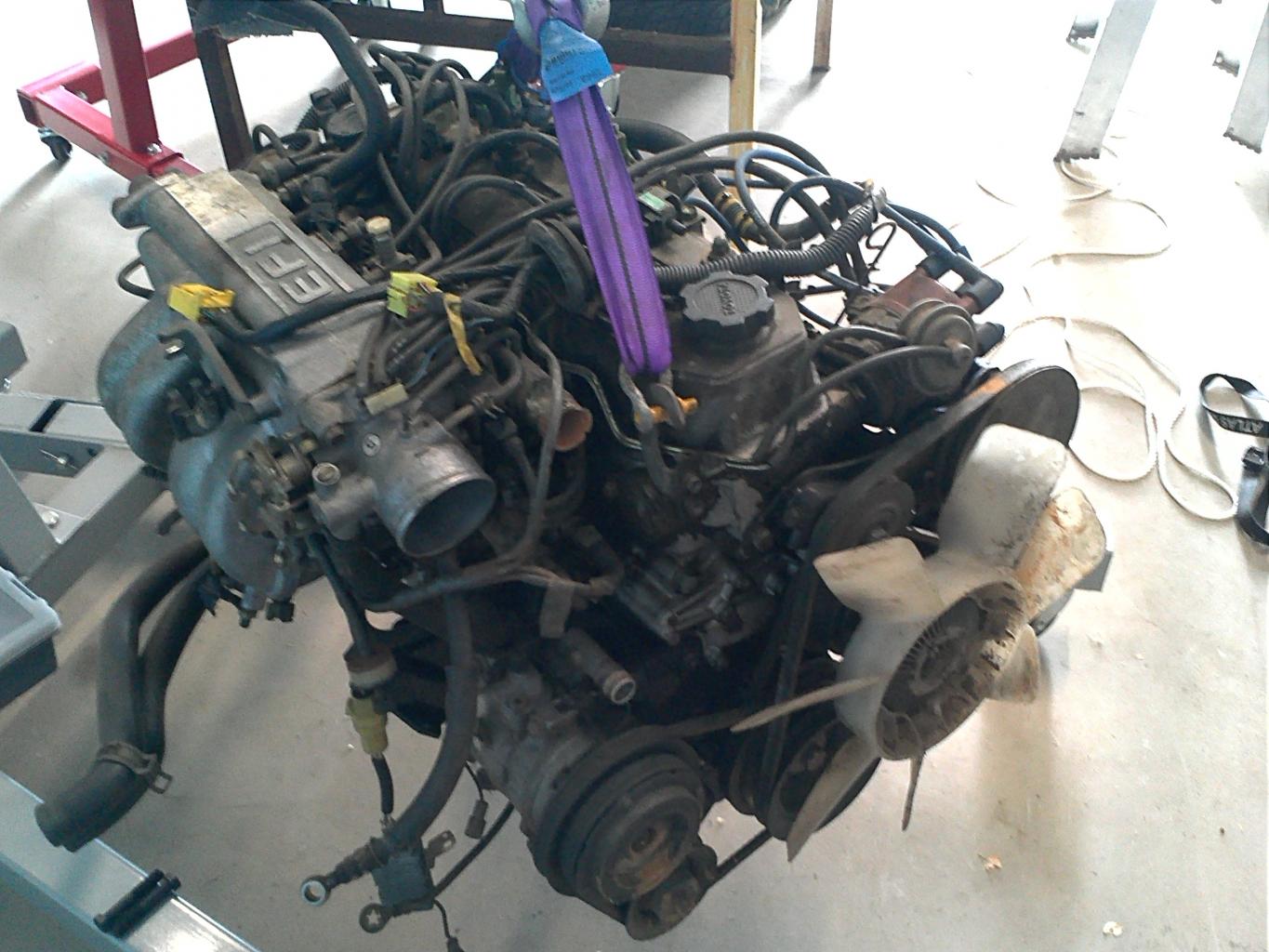

Now for the engine: something different a mighty Toyota 2.4Lt 22rr see.

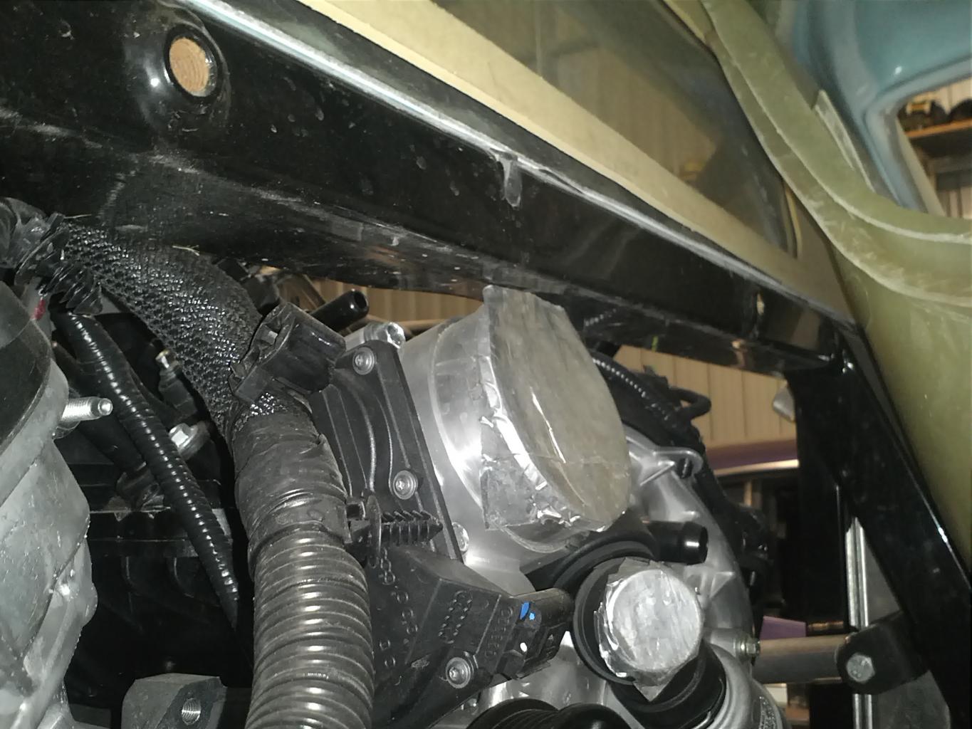

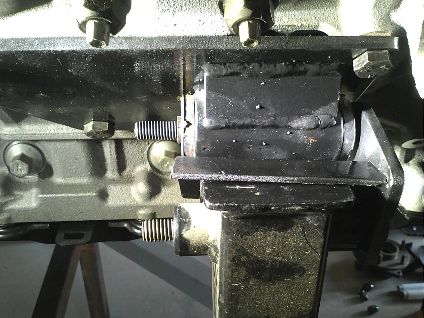

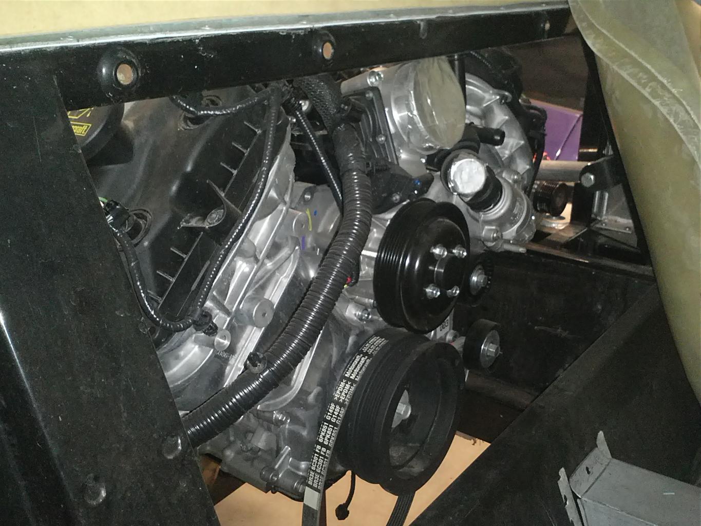

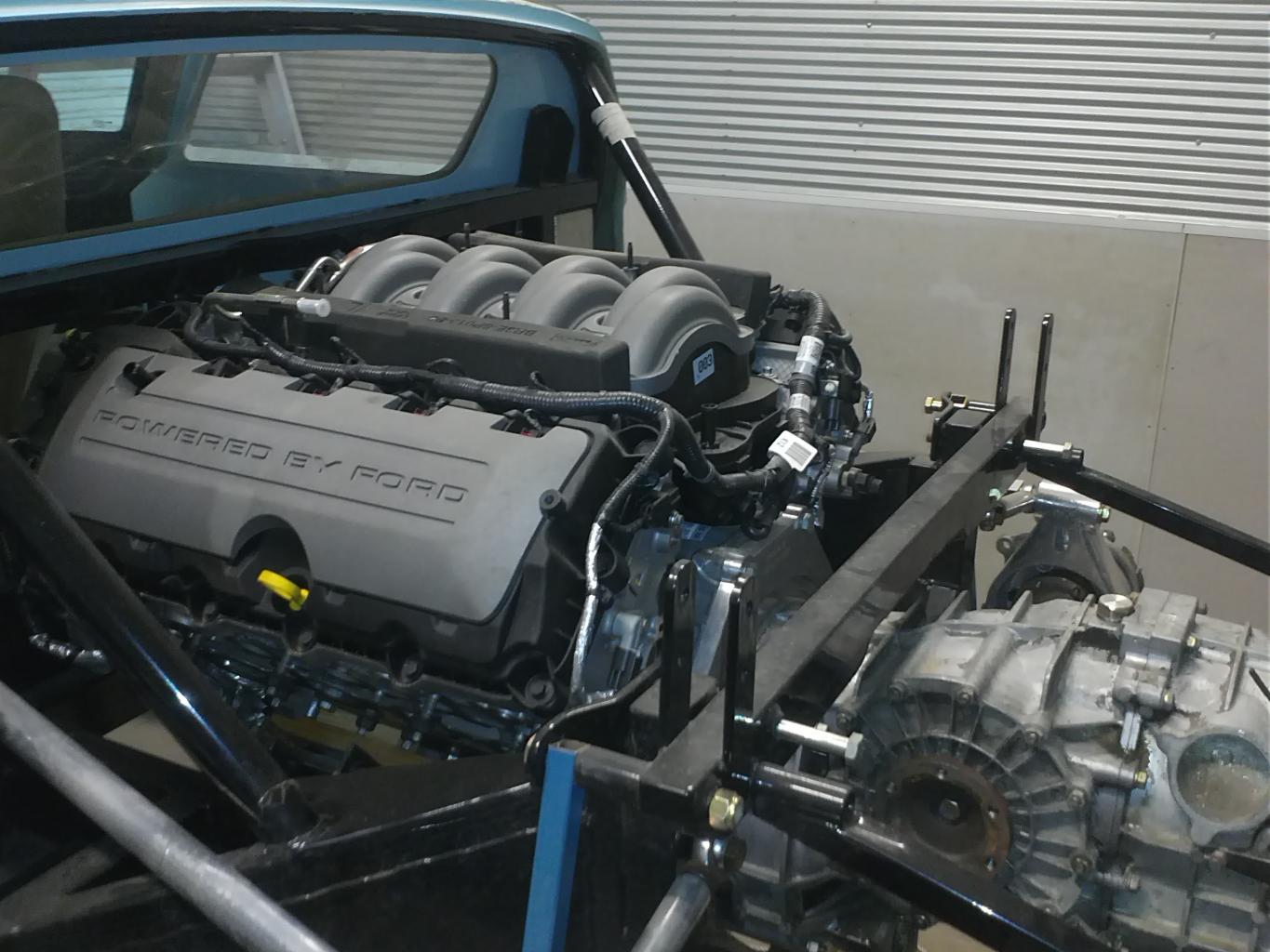

No just kidding! Ford’s new 2011 5.0 all aluminum quad cam mustang motor with a Porsche G50 transaxle, once they were bolted together, I then found out the engine mounts are different to the local 5.4 modular motor which is available as an option from DRB, the intake sits right were part of the frame of the car is I’ve started to make up the engine mounts but trying to fit the engine in without modifying the frame- not easy. One option is to turn the intake around but then it would interfere with the exhaust routing and just look wrong. Any ideas?

Hi Darren
Regarding you intake problem I had a similar issue with my LS1. I think you will just have to turn the manifold 180 and have the exhaust as a twin system. This worked for me,I fitted the air box between the cats.
You have made a good choice,the DRB is a great product and I found them terific to deal with.
Darrell DBR#46
LS1 G50
Hi Darren
Looking good.
From memory Dimi, a DRB owner on this site had to mod his frame or mounts to get it to fit and it was tight.
DRB told him it fitted but he had to massage it.
He may see this and chime in.
Jim

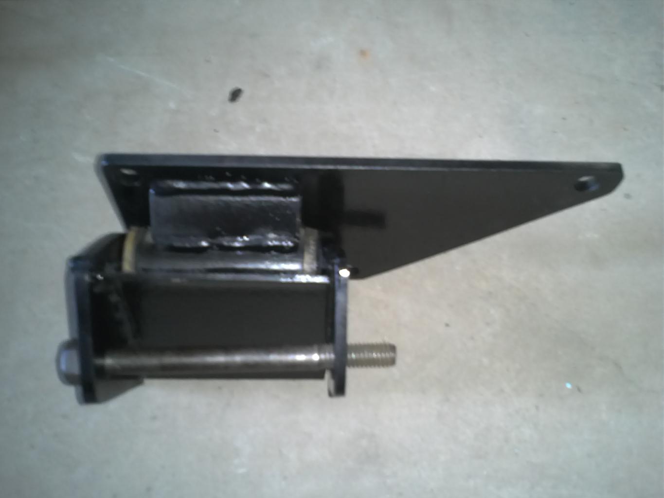

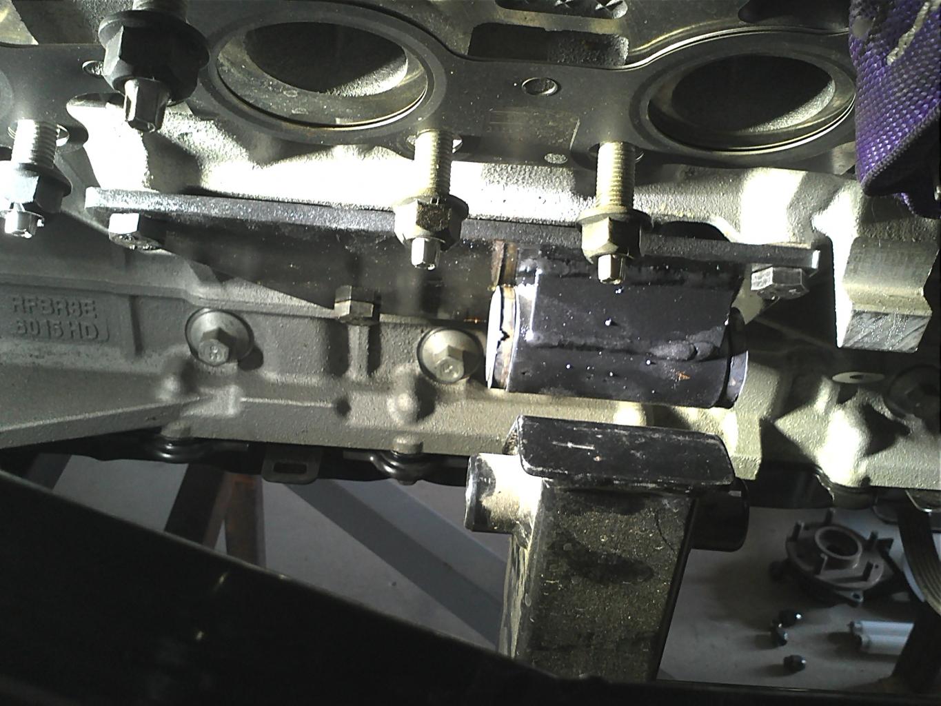

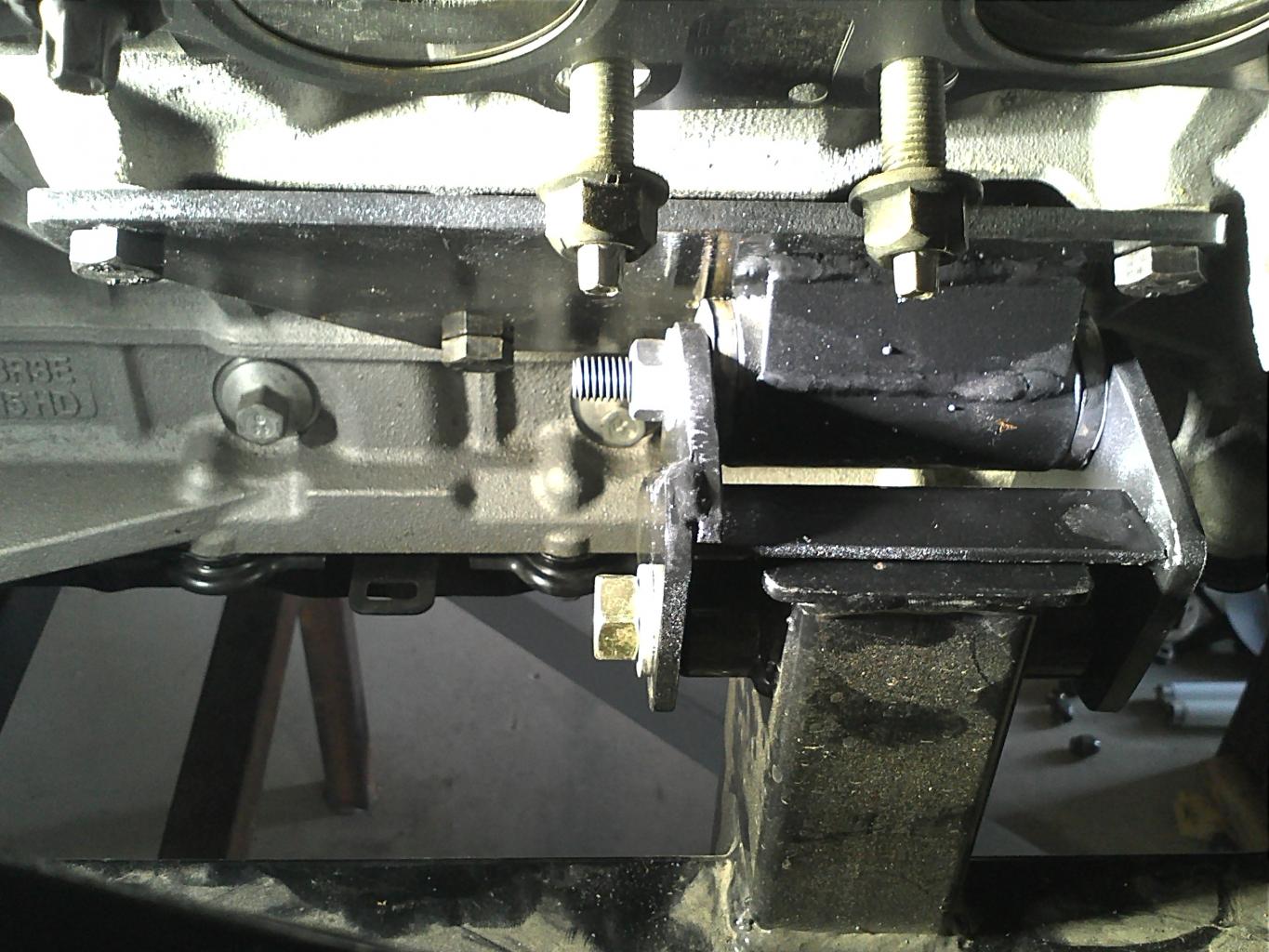

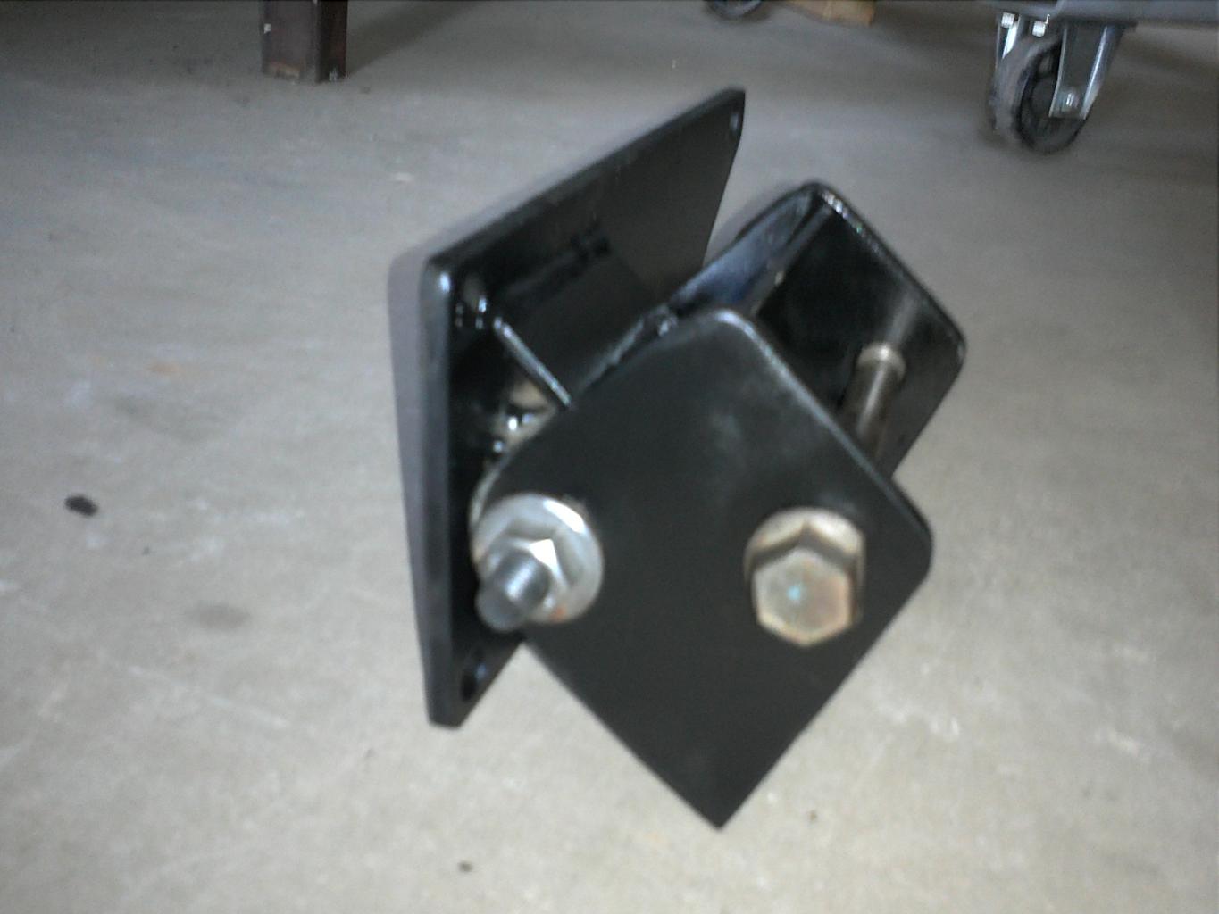

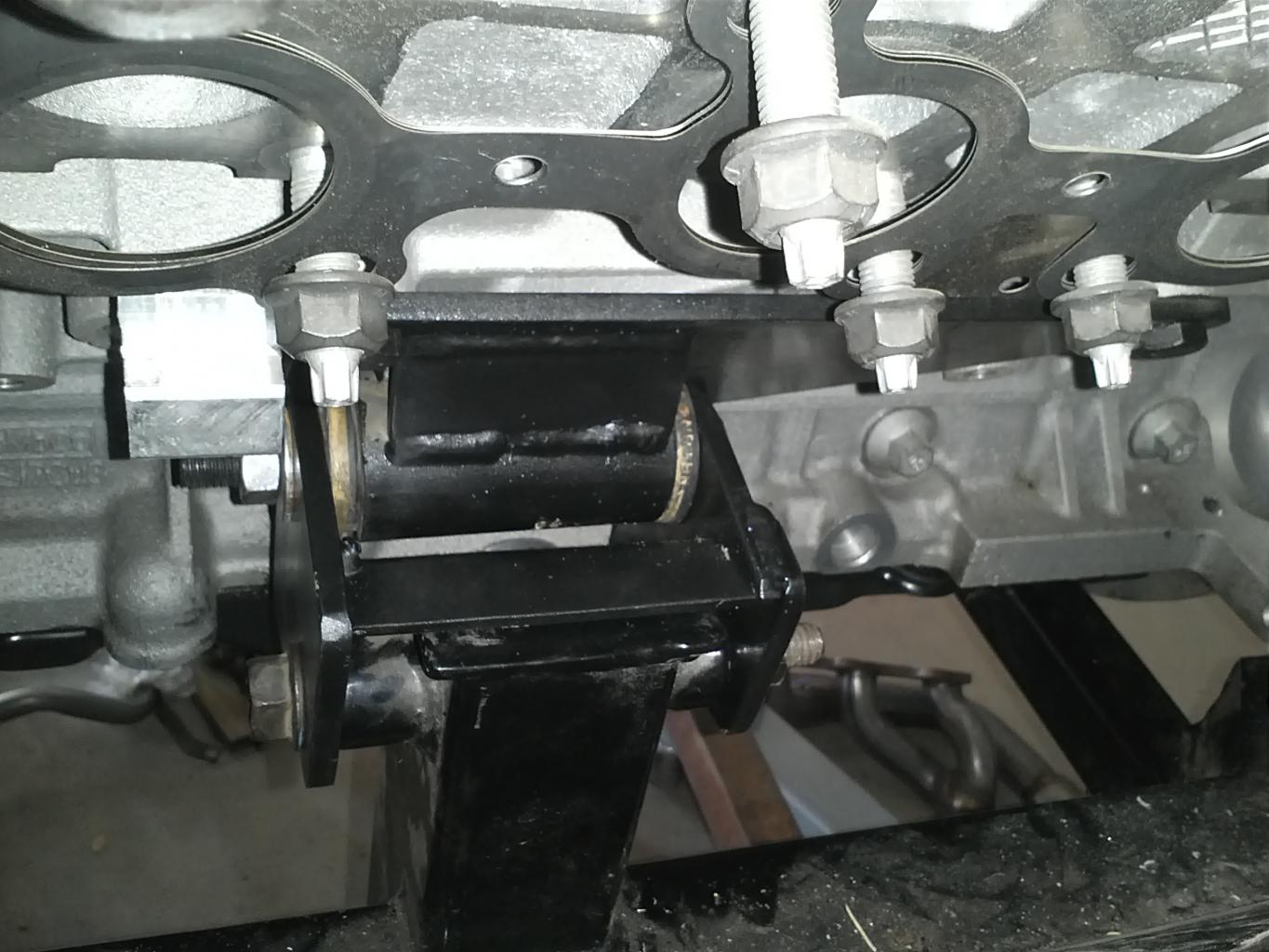

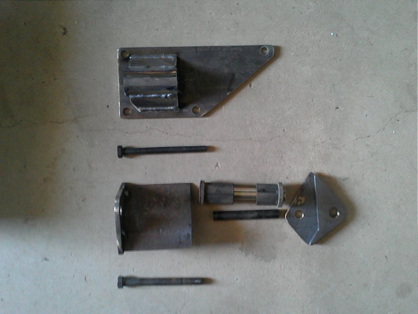

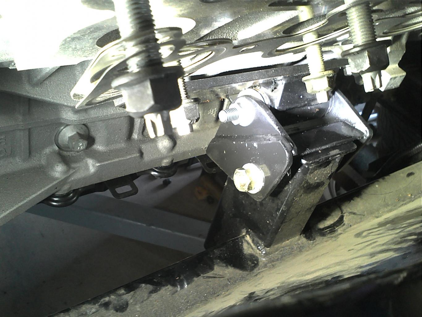

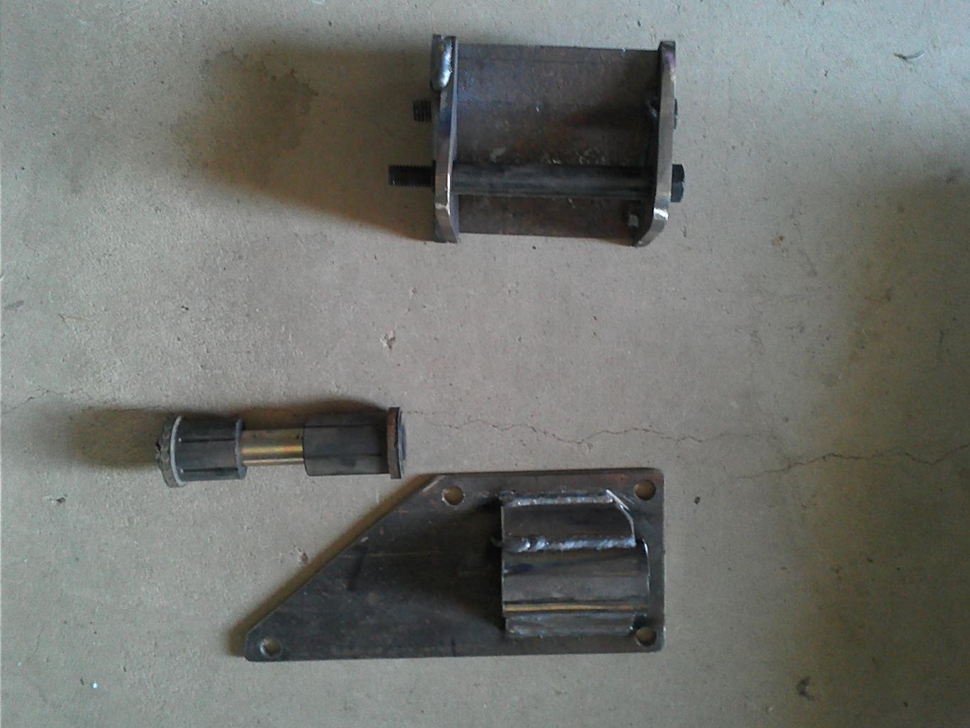

OK so while I've not been on here I have been slowly building the gt this is what I done over the Christmas / new years brake so don't say any thing about the bolts because it's just what I had sitting in the shed as soon as the bolt shop in town opens I'll go and get some zinc plated one to make them look a bit nicer, what I've done with the engine mounts is make them a three piece design to help with getting the engine in and out a bit easier, the cam phase's on the front of the head stick out a bit and make it really hard to lift the engine up so the easiest was to pull the engine back and out and these work perfectly.

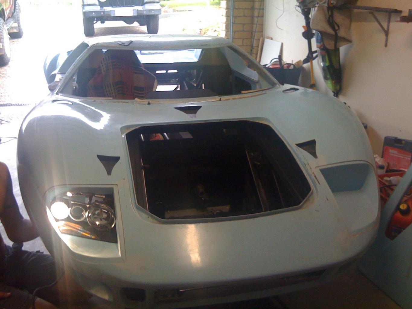

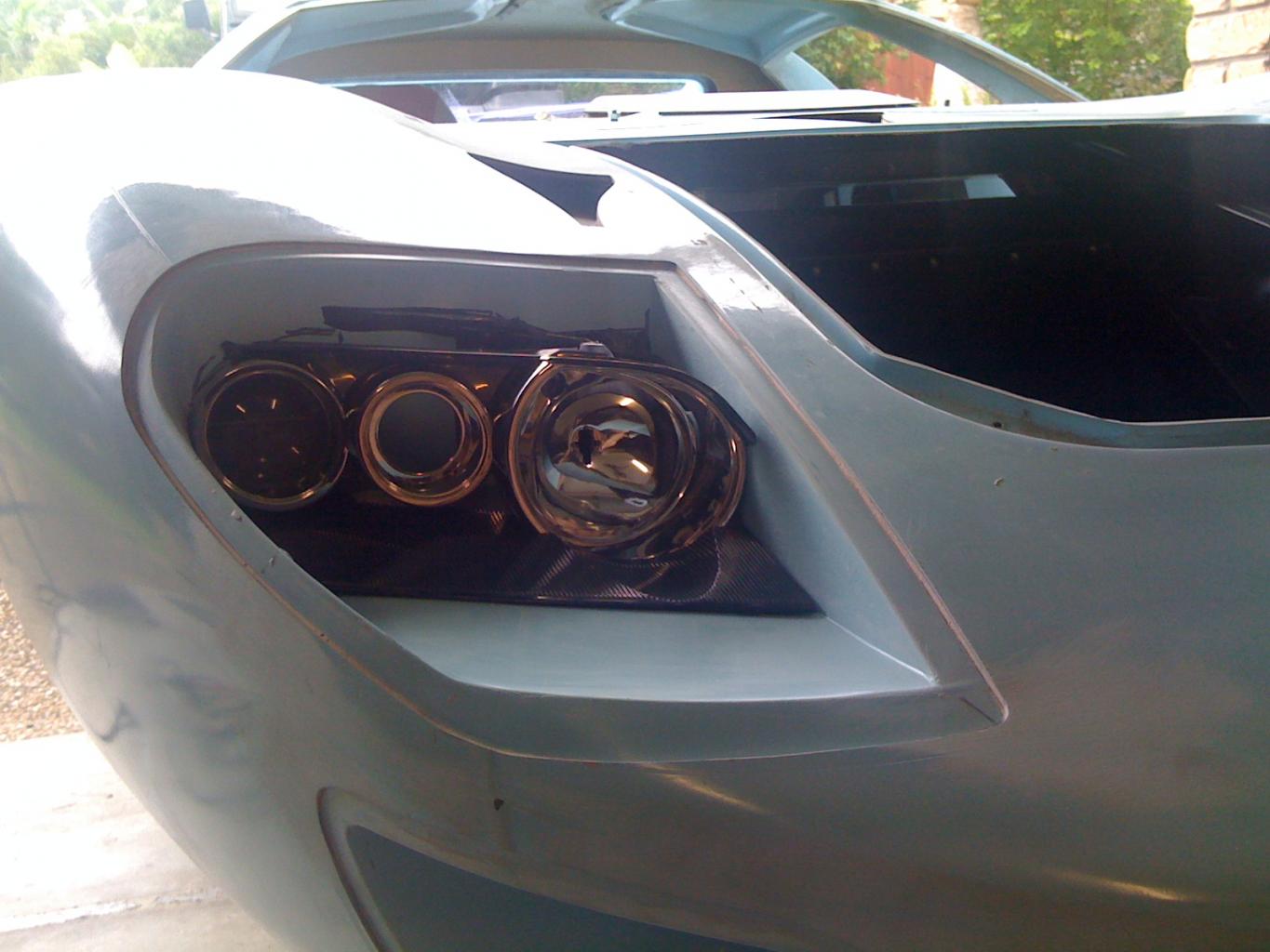

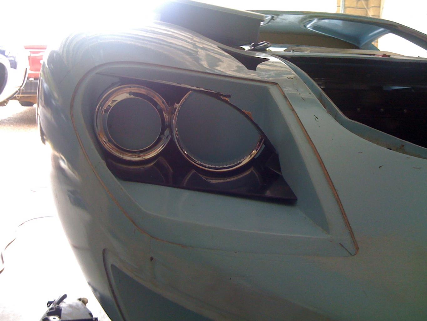

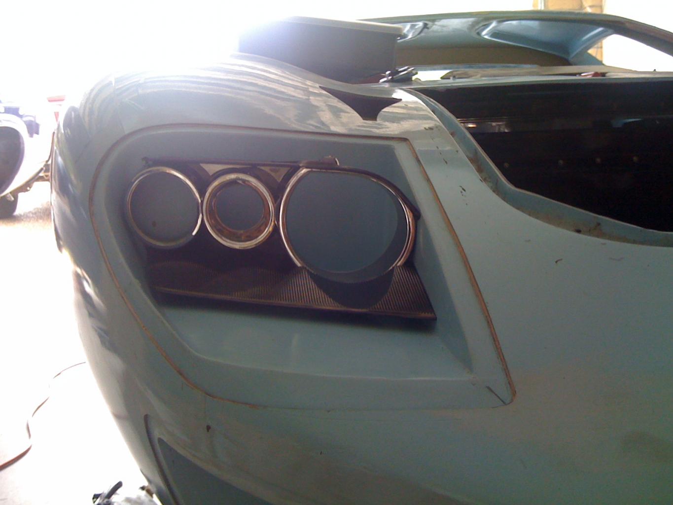

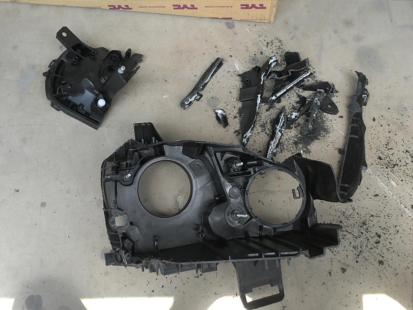

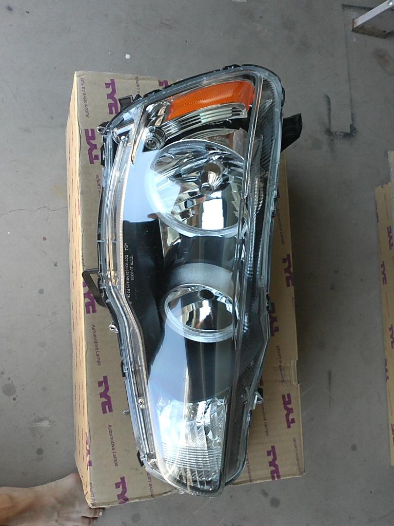

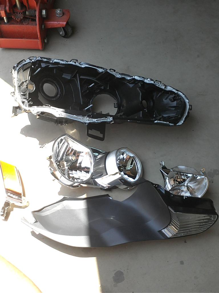

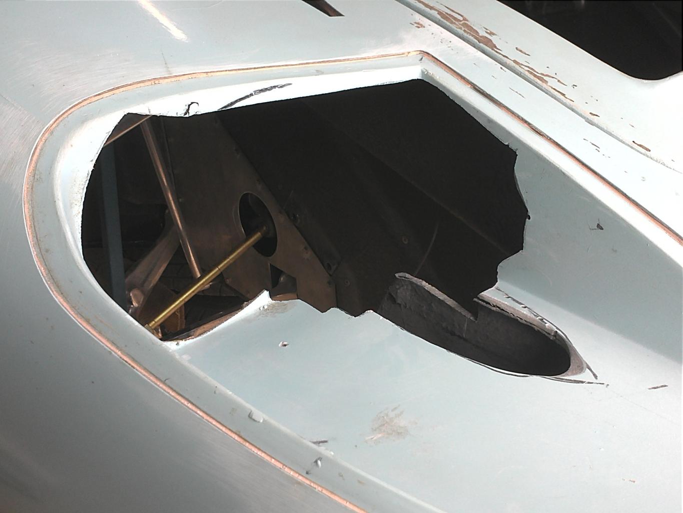

On another subject, started on the new head lights this time with Mitsubishi Lancer CJ lights as you can see the fitting of them involved a lot off modifying but so far the result is the look I wanted now just have to do some fiber glassing but have to wight because it was 46 degrees c today to hot do glass.

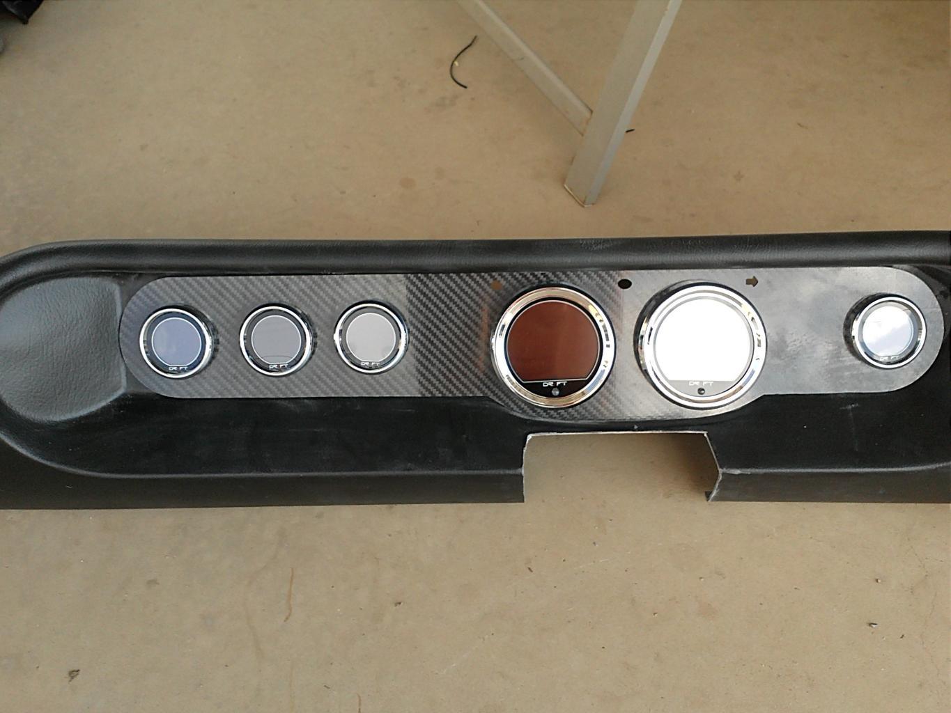

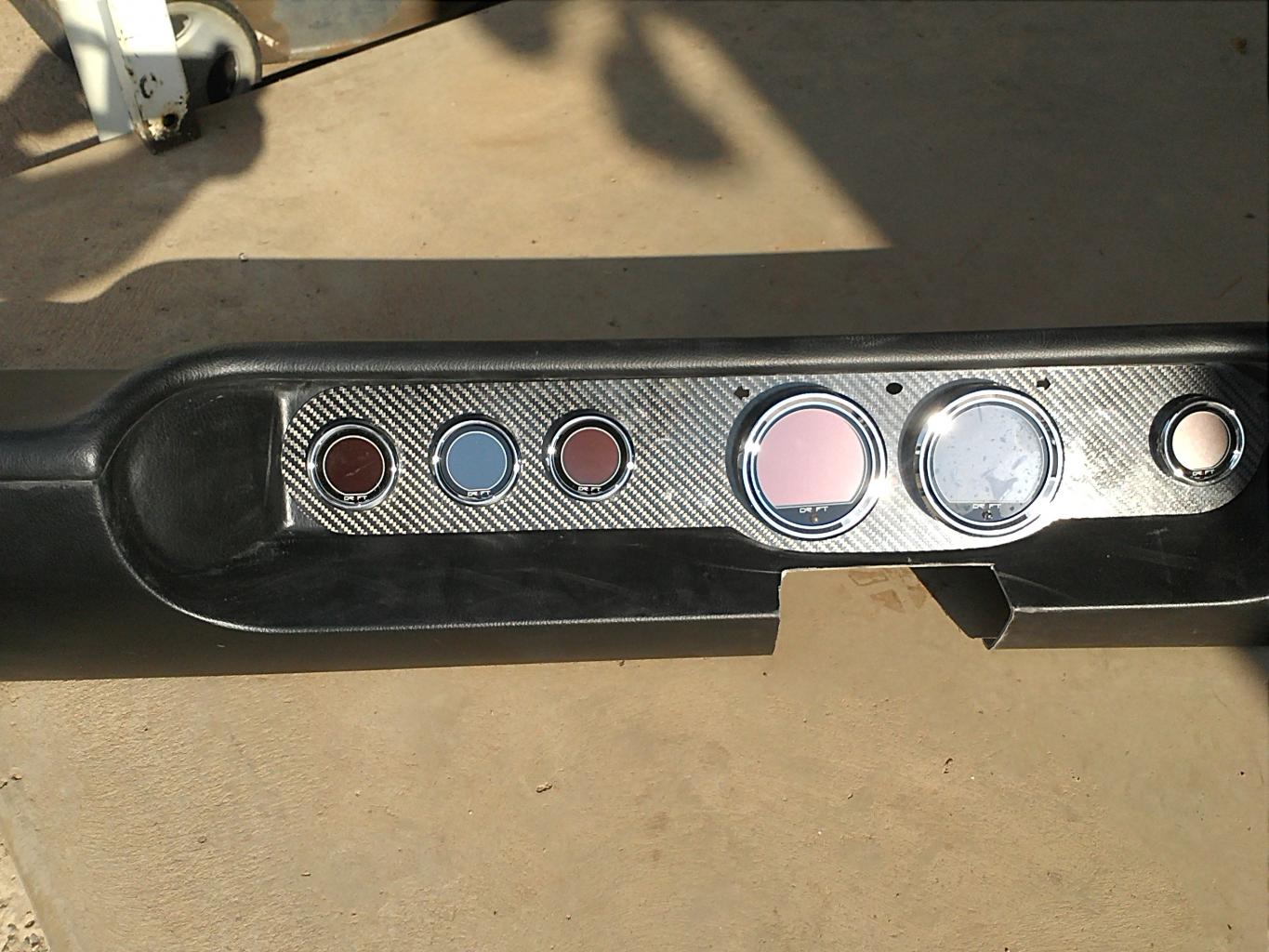

Now the dash I know everyone puts Smiths or VDO gauges in but I wanted once again something different the gauges are digital but look like analog and to spruce it up a but carbon fiber has been used as a backing I only went for six gauges because from previous experience you can have too much information and that can distract you from the drive. A nice feature of these gauges is when they go out of a certain perimeter the gauge changes colour, example if the fuel level drops below 15% it changes from blue to red, same with the other gauges & you can set the rev counter so when it reaches 8000rpm it changes to red as well.

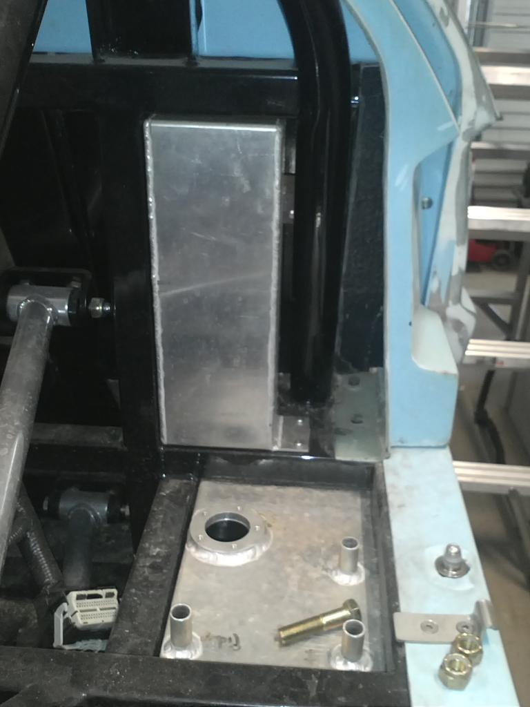

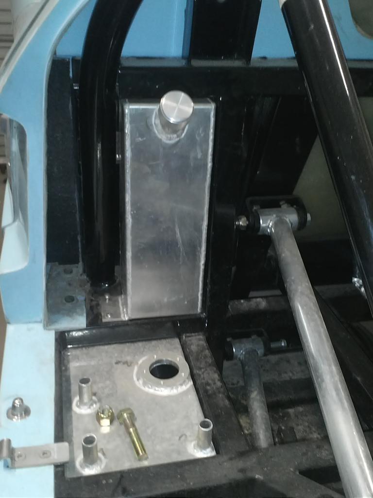

For the serge and radiator overflow tanks I wanted to hide them it’s just the way hoses and wiring look it’s a but ugly so am trying to hide everything fuel pumps, battery, wiring anything that does not need to be seen will be out of sight to make the engine bay clean and un cluttered, these will be sitting behind carbon fiber panels and all that will stick out is the cap for the radiator overflow.

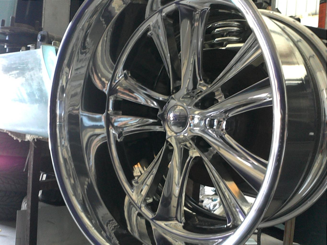

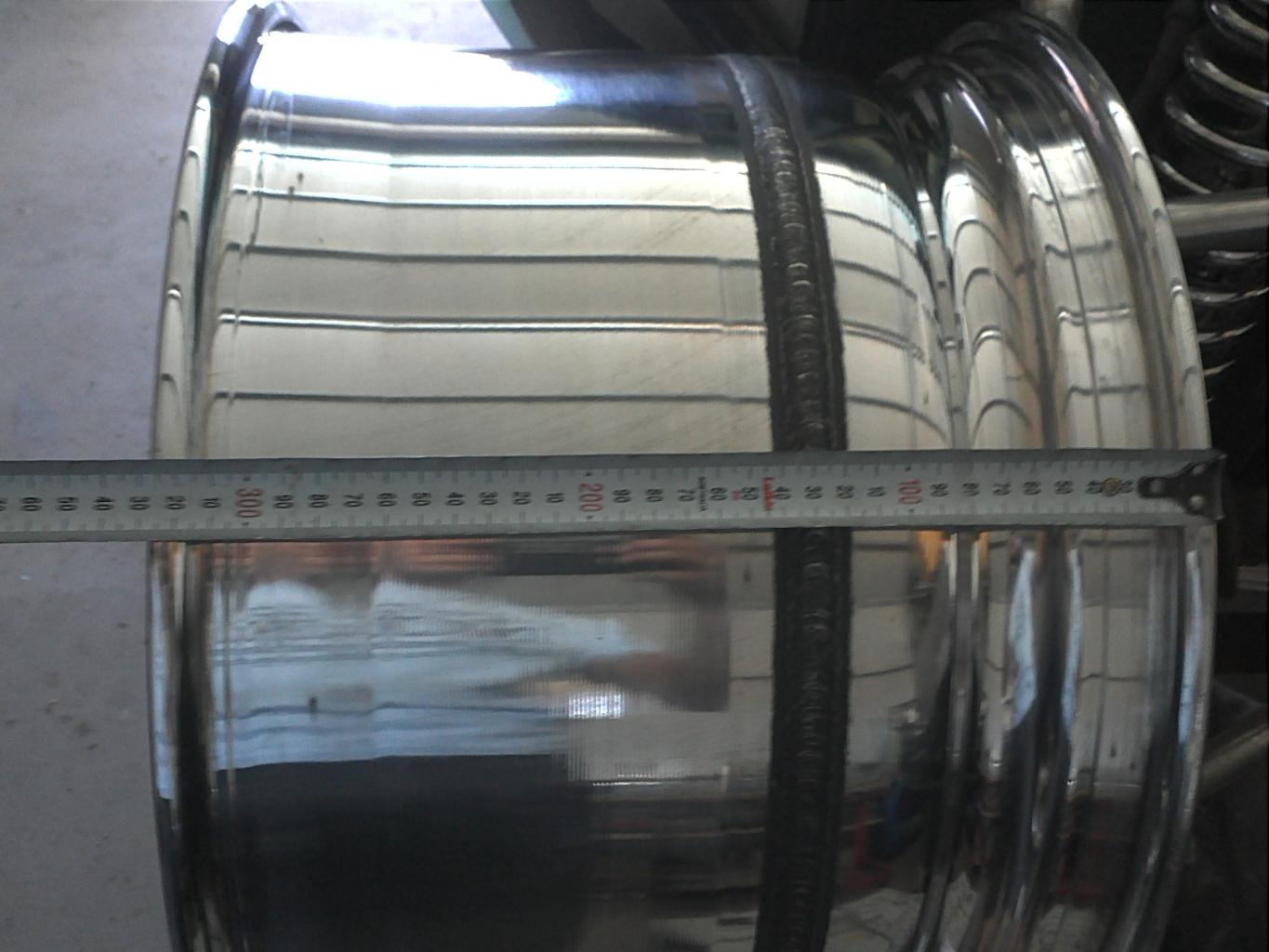

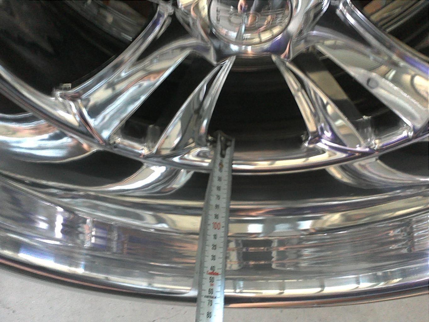

Also my wheels arrived Foose Knuckle 18x8 and 18x12 got to love the wide body.

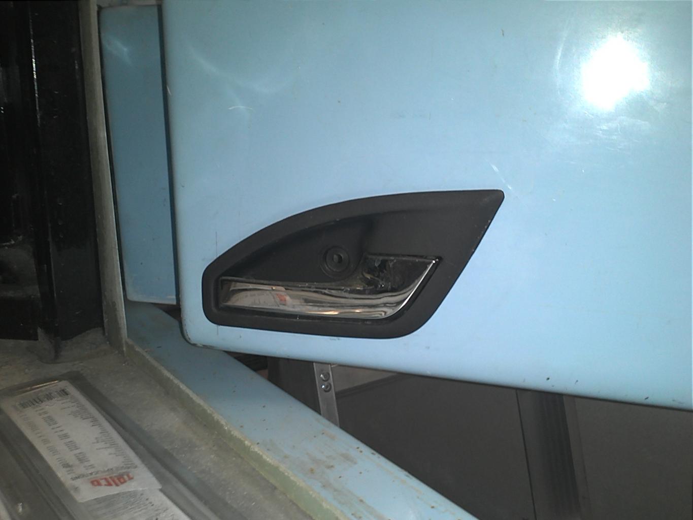

More pictures inner door handles, pedal assembly and on a side note the trip up to Isa
