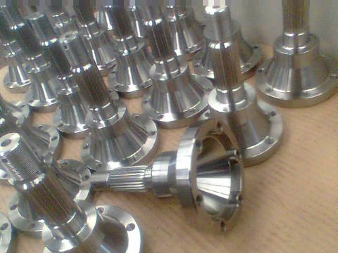

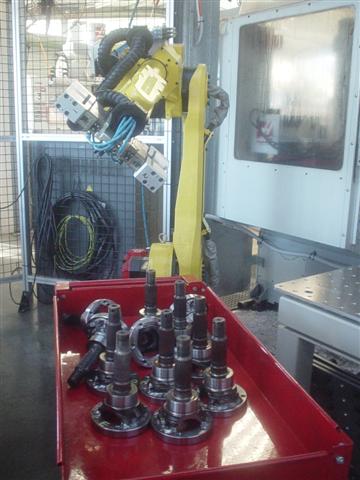

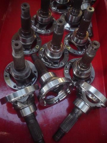

Many years ago I created these nice C5 billet stub shafts to take CV shafts instead of the universal joint sliders.--- unfortunately we also offered a modified C5 stub to CV for half the price-- that our bretheren Titus :laugh: seem to prefer .
