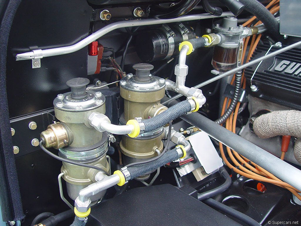

Planning to use my SW240 pumps I have seen pics of them used in what appears to be in parallel, not in series, I am running tanks that use a crossover tubing instead of a pump for each tank, any thoughts
-Steve
I suppose you've found some good fuelproof switches, the achilles heel of these pumps. I'm personnaly looking for a good one for years...
Here is a pic of 1074 engine bay. I've been said that one single pump has sufficient capacity to feed a good hot/street 347 SBF, but if you check the figures, it seems being too short, half the capacity of a blue holley pump. Regarding me, as soon as I can find a good switch, I'll put 2 of them in series

Pierre and Steve,
just to clarify;
Two pumps in series give same capacity but twice the pressure.
Two pumps in parallel give twice capacity but same pressure.
the picture in post 2 shows two pumps in parallel.
Dave

Pierre and Steve,
just to clarify;
Dave
Right ! That was I intended to say, one single should theorically not have sufficient capacity, thus the plumbing on the pic I posted (which I will use, as soon as I could). Typed the wrong word, sorry !
