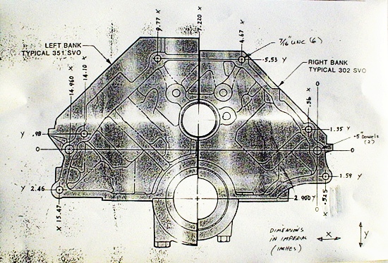

Hi, looking for a DXF of the bellhousing of a sbf to make a new sandewge plate for the ZF
any drawings would be great even if its for a different trans, its only the ford side I need.

You'll find a engineering drawing for the Renault transaxle if you look around. In the last two months or so. It'll have what you need to go into DXF.
flatchat(Chris)
not a real good pic ---but ....they are usually easy enough to find

Darnel A.
Here is a Audi to Ford coordinates.
Darnel
  • Ford plate coordinates[1].doc
John,
Got the file at work.
Will email it in about 13 hours.
Set up for a Renault, and with r/h starter.
Discovered that the Renault bellhousing is too small for the standard Ford flywheel/swashplate, so seeking a smaller flywheel, and I will modify the starter position to suit.
