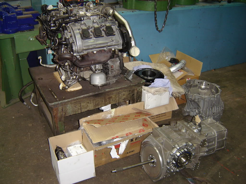

Just starting another thread on the subject of ERT's transmissions (since the last thread disappeared).
The TXL300 6 speed sequential, and the TXL250 6 speed sequential transmissions are great gearboxes. Very experienced engineers, significant production facilities, great support - I only have good things to say about them.
By the way, I know of a gentleman running the TXL300 in the UK in a car similar to an Ultima, with a twin turbo Audi V8 that puts out 750NM of torque.
Please feel free to add you experiences and thoughts with these gearboxes. I will try to help out as a current owner of a TXL300.

I'd like to learn everything about TLX Elite trannys before I get one. How much are you running trough it and in what application, your V10?
