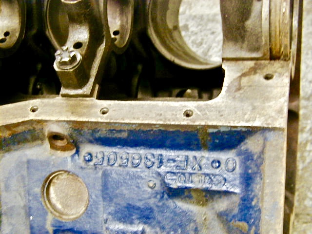

This is how I see it.
I would be be looking for the following engine block casting numbers.
C6FE-6015-B 289 installed on earlier GT40s similar to a beefed up HiPo 289
0-XF-136505 which is a 289 used in late 1966 GT40 through to the end of the JWA campaign using Copper seals. Later bored out to 305.

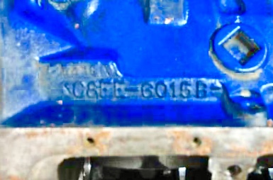

C8FE-6015-B - not strictly GT40 however a late 1968 302 block used in TransAms and some early 1969 Boss engines. (same4-bolt mains casting as the 0-XF above)
Later race transmissions from 1966 onward came from a batch of thirty uprated ZF-1 with stronger casings than the previous ZF-0s.
Cars used for racing in the UK had hard stamps applied by the RAC on the machined block register.
Privateer engine builders also had their own hard stamps indicating works order number on the blocks.
(my block has these stampings from Mathwall Engineering and I have a copy of the corresponding order build sheet)

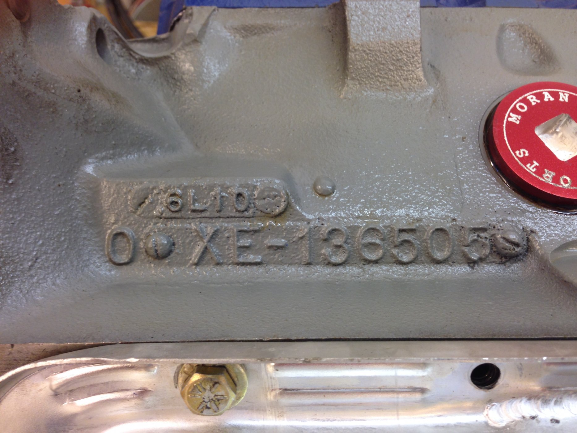

I don't know what's up with me today, please read 0 XE
One of our 4-bolt 289 engines cast 10th November, 1966.
The screw freeze plugs were added by me for racing.
