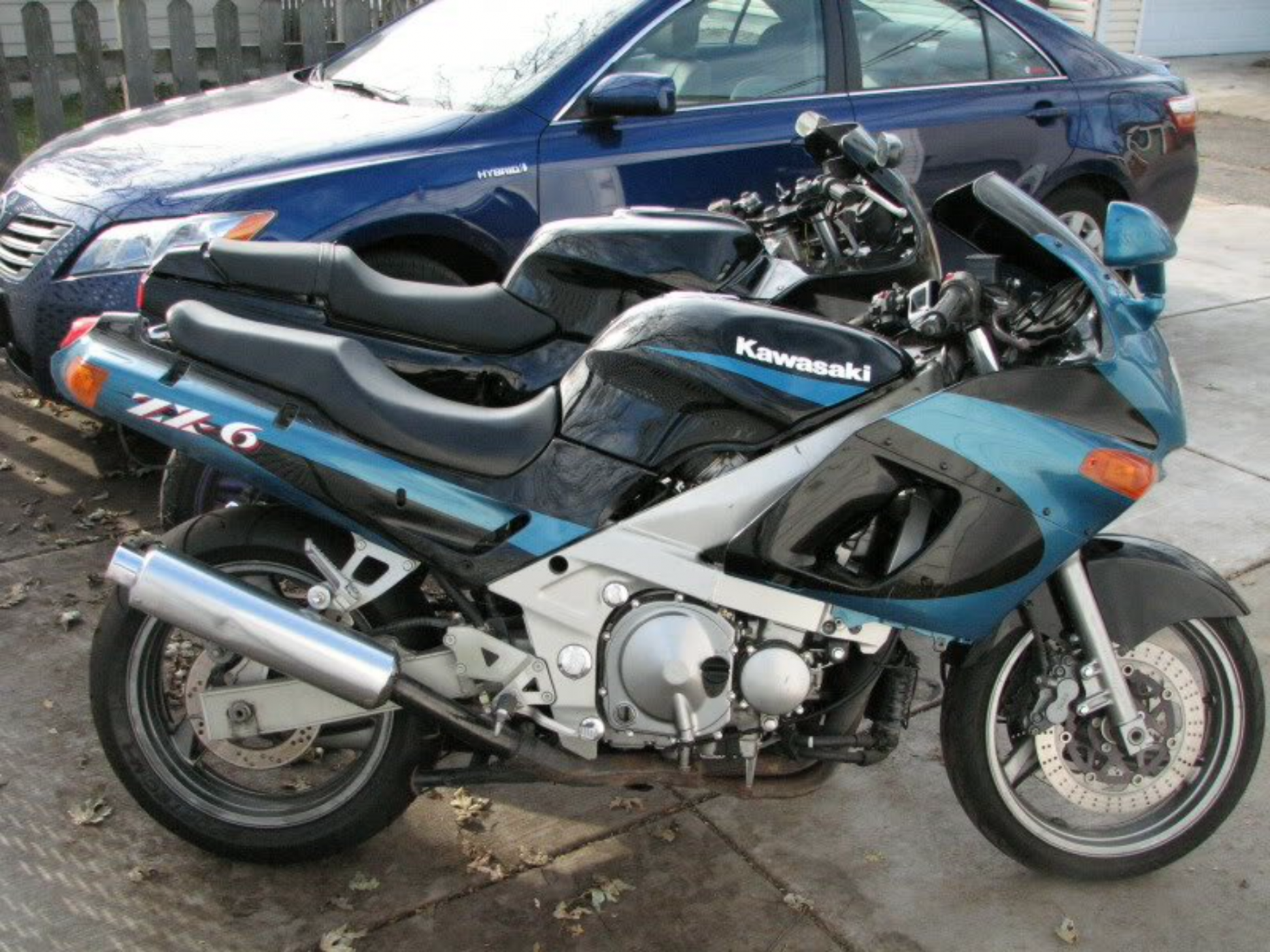

72 volt DC, no transmission as it’s direct drive, it would do zero to 60 in under 4 seconds with a 190ish pound pilot...
Oh, and thats when I programmed the controller to allow 450 amps at WOT...

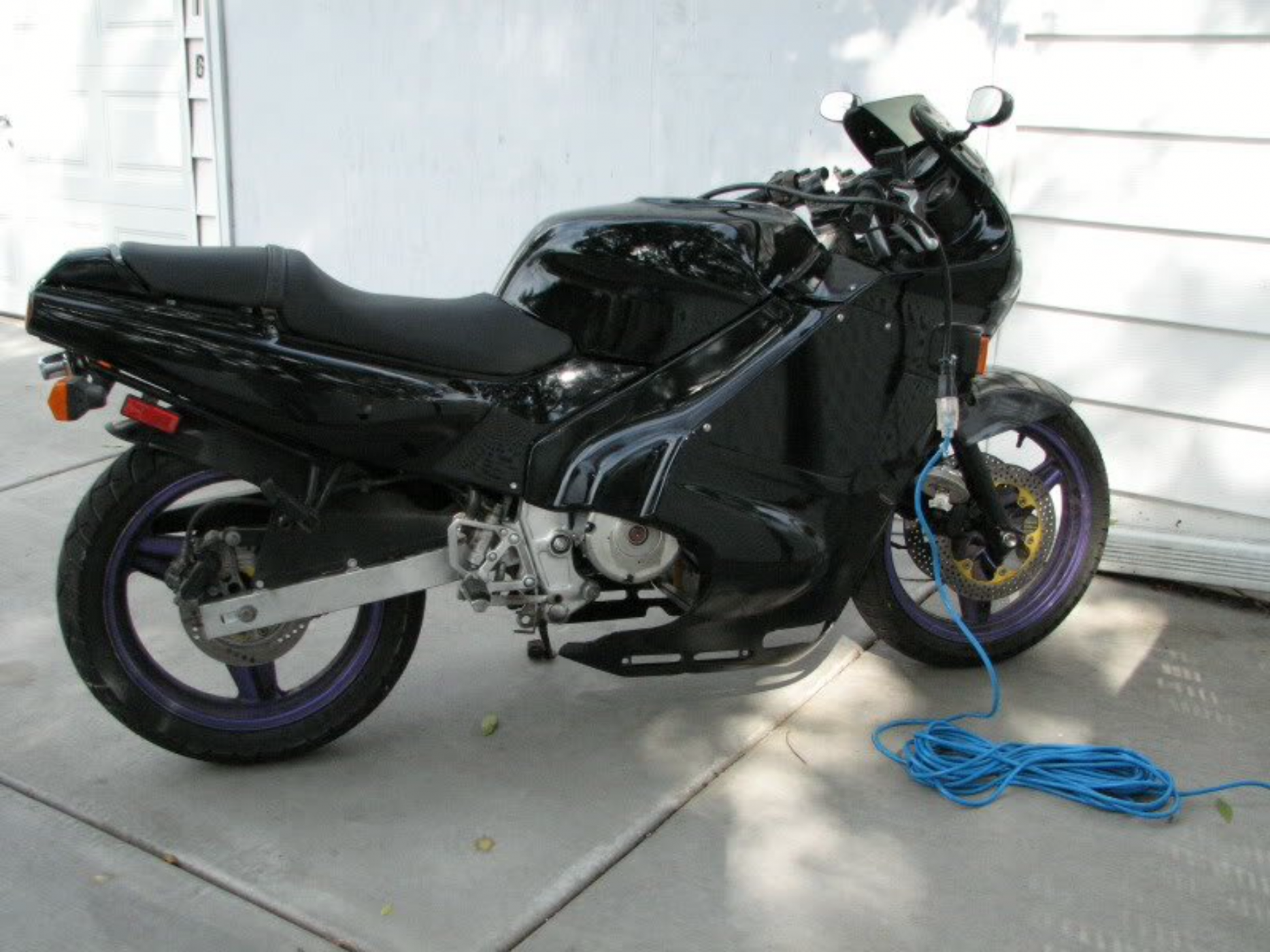

The Ninja in the second picture is much lighter (~70#) and will host the drivetrain from the Hurricane chassis.
That is, if I ever get my life back in order again...
