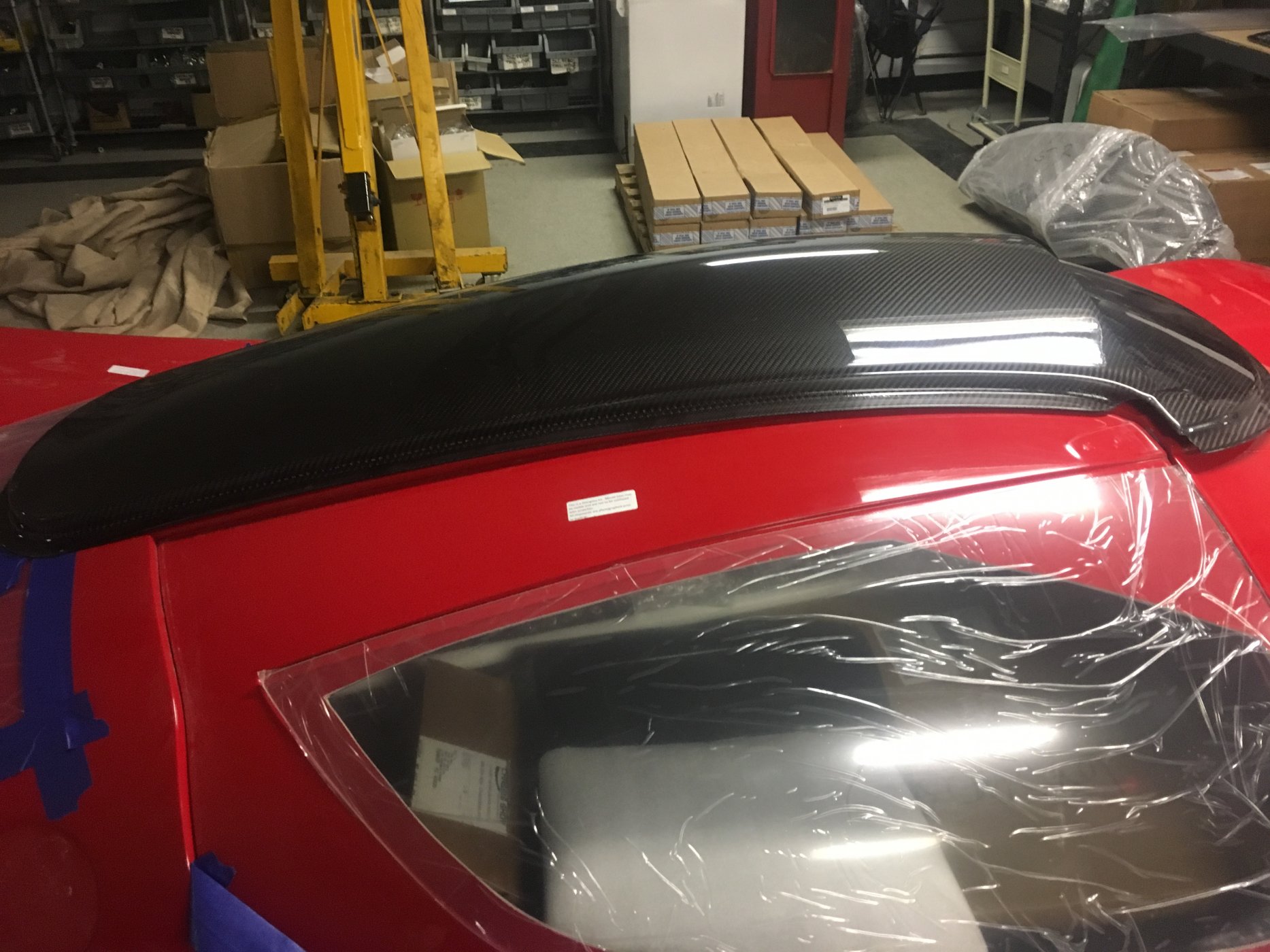

Hi all - another option that isn't listed but available is the Carbon fiber Roof. Joel reminded me to add that one as well. Thanks Joel for the picture...

  5. Carbon Fiber roof (pictured Above)
