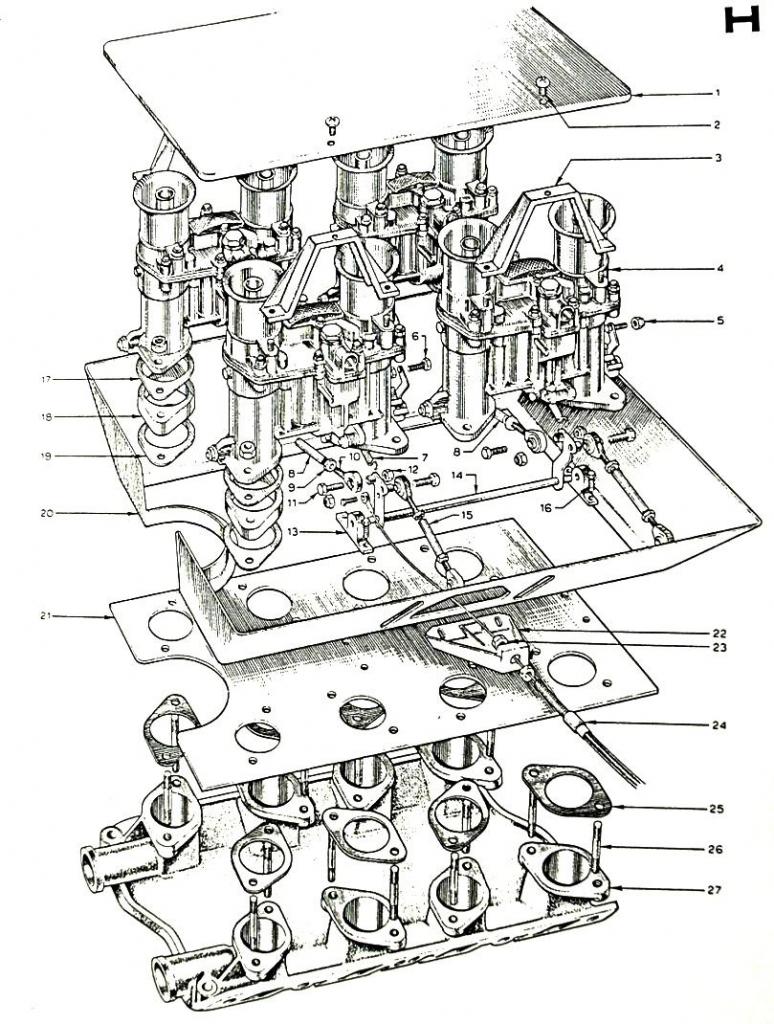

The local guy, possibly at the behest of the regional manager, said that if I could show that the GTs came with webers, I may be able to keep those...we shall see. I have the SAAC registry, with nice diagrams of the car, including webers without PCVs and air injection.

Regarding the weber carb issue, if you could show that at least one GT40 Mk I was registered or was registerable in CA in the day, then a page from the FAV parts book should suffice, eg
Howard Jones

I'll have a hard time proving that a car was actually registered here, but I can show that the cars were supplied with webers...vie the parts diagram from JWE that is in the SAAC Registry.
