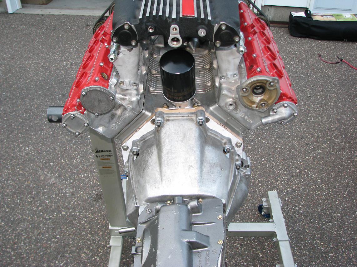

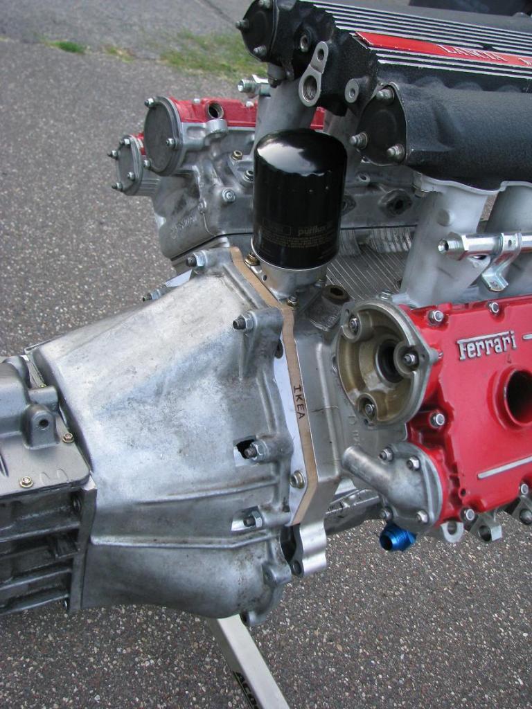

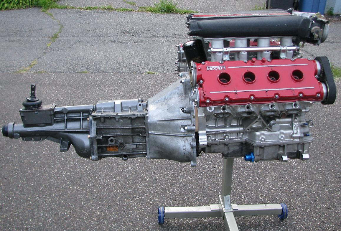

I am building a 348 motor to work in a front engine /rear wheel drive application.
Adapting a Ford bell housing and a Borg-Warner T5 transmission.
With the help of a friend (with a large CMM unit) I was able to measure the block and bell. I have created the CAD file for the adapter plate and I am sending that off for machining.

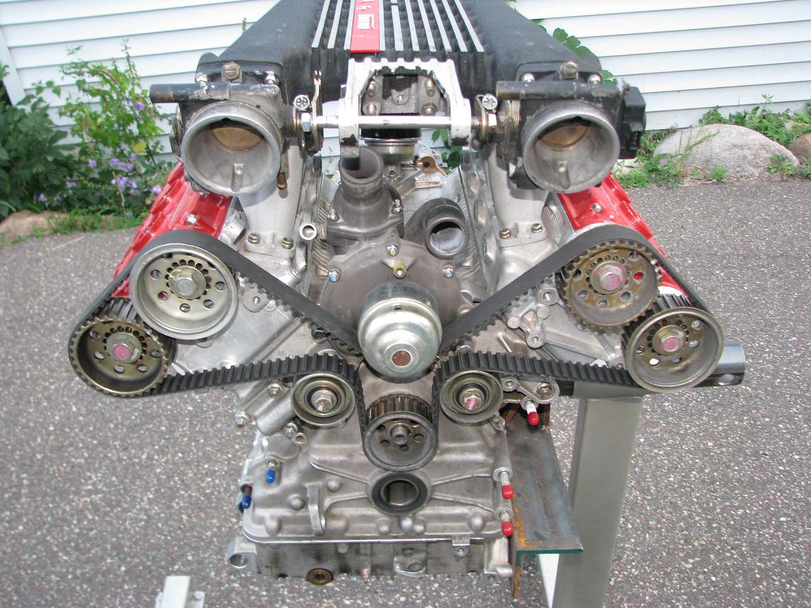

I see you know someone with a water jet. :) Thanks for the pictures of the front of the 348, I just bought all the parts to do a major on my 348 (acquired last year), brought them in from the UK for about $850 USD, I was surprised how costly the parts where compared to the 308.
When you tore down the motor how did that chain guide look for the dry sump pump? Is it easy to get to? Did you know how many miles where on it?
Pete you can drop the gas tank in the 348 and do the belt and the water pump.
My motor supposedly had 20K miles on it. It came from a car with an upper intake fire.
The dry sump chain guide looks to be in great condition. But the timing chain guide has some grooves in it. I'm going to replace it with the Scuderia Rampante part. Very expensive but very nice.

Mocked up
