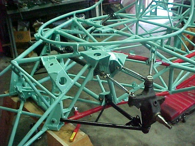

Apologies for thread drift but quick question for Graham: Why did Porsche go with spaceframe for 917 over mono?
My understanding was cost, timing and reparability. Remember the photo from Porsche of 25 917s lined up numbered to 25 for the homologation inspection? I have seen comments that all 25 were not complete and that some shell games were played with switching out numbered body panels to fool the inspectors.
As Porsche did not have experience with mono construction save for the unitized street cars, it was quicker and cheaper to go tubular. And the 917 chassis had holes in the tubes wherever another tube butted to it. The frame was equipped with a pressure gauge and a Schrader valve so the tubework could be pressurized and a "leak down" test done to identify cracks or failed welds!
Doc Watson
#20
I heard that the drivers were told to immediately pull over if the pressure gauge went to zero. I also heard that some F1 drivers tested the 917 and got out white faced never to be seen in that car again, could be an urban myth but is it defiantly thread drift!!!!
I managed to collect assembly photos of the last original some years ago. The chassis is magnesium and the welds look like chewing gum!!!!!
Porsche were obsessed with weight on this car, the floor was a 'new' honeycomb construction, socket head screws had 50% of the heads removed. Did they put Steve McQueen on a diet before filming Le Mans???
