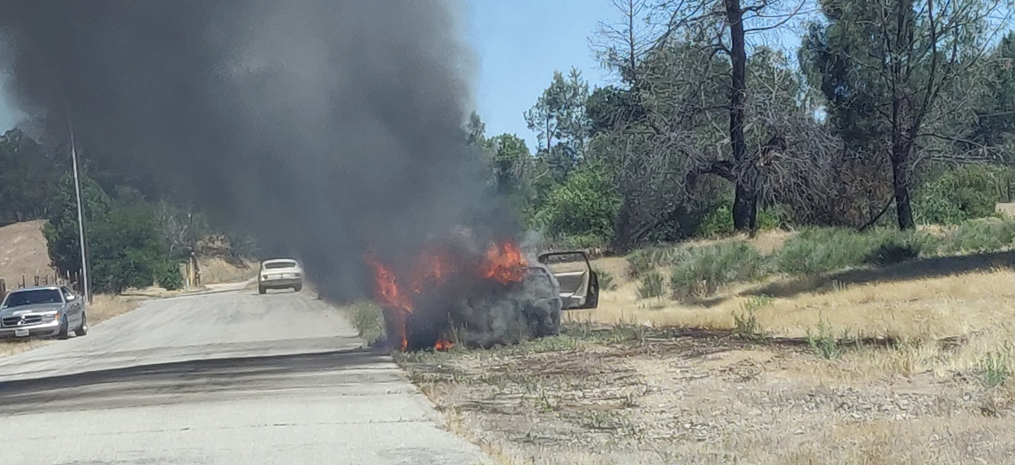

A Lotus Esprit. Two fire extinguishers were not enough. Timing really is critical. Nobody was hurt. This was during the California Targa this last weekend.

Del, You have asked the most important question. Do you open the rear engine cover to put the fire out? If all you have is a little handheld then it will be nearly impossible to put out anything other than a few drops of gas dripping from a low pressure system like a carb motor. Especially since you just have given the fire a huge source of fresh air when you opened the cover.
With a high pressure fuel injection system, man that is going to be a big problem but you can put it out with a fire system IF you don't open the back and flood the engine room with retardant. If you need to add more retardant then fire from ground level up under the rear of the car.
If you open the back you're fucked for sure! Unless you have a water hose handy. Even then spray from under the rear of the car and keep the top closed.
This is EXACTLY why you need a installed system. You can apply fire retardant to the engine room with out adding any more air. That is exactly how to put out a fire in an enclosed space.
