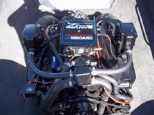

Water pump rotation.....? I know the WP on my Mercruiser marine 5.7ltr engine is handed with vanes that are designed for a certain rotation direction. The stock cam is a standard automotive cam.
Main differences between the marine and non-marine are just the WP impeller (bronze in the marine), flame arrestor in the carb filter, hard lines for fuel downstream of the fuel pump, valve cover venting back into the carb inlet....and the rotation can be different too, but not always as boat props are both LH and RH.
