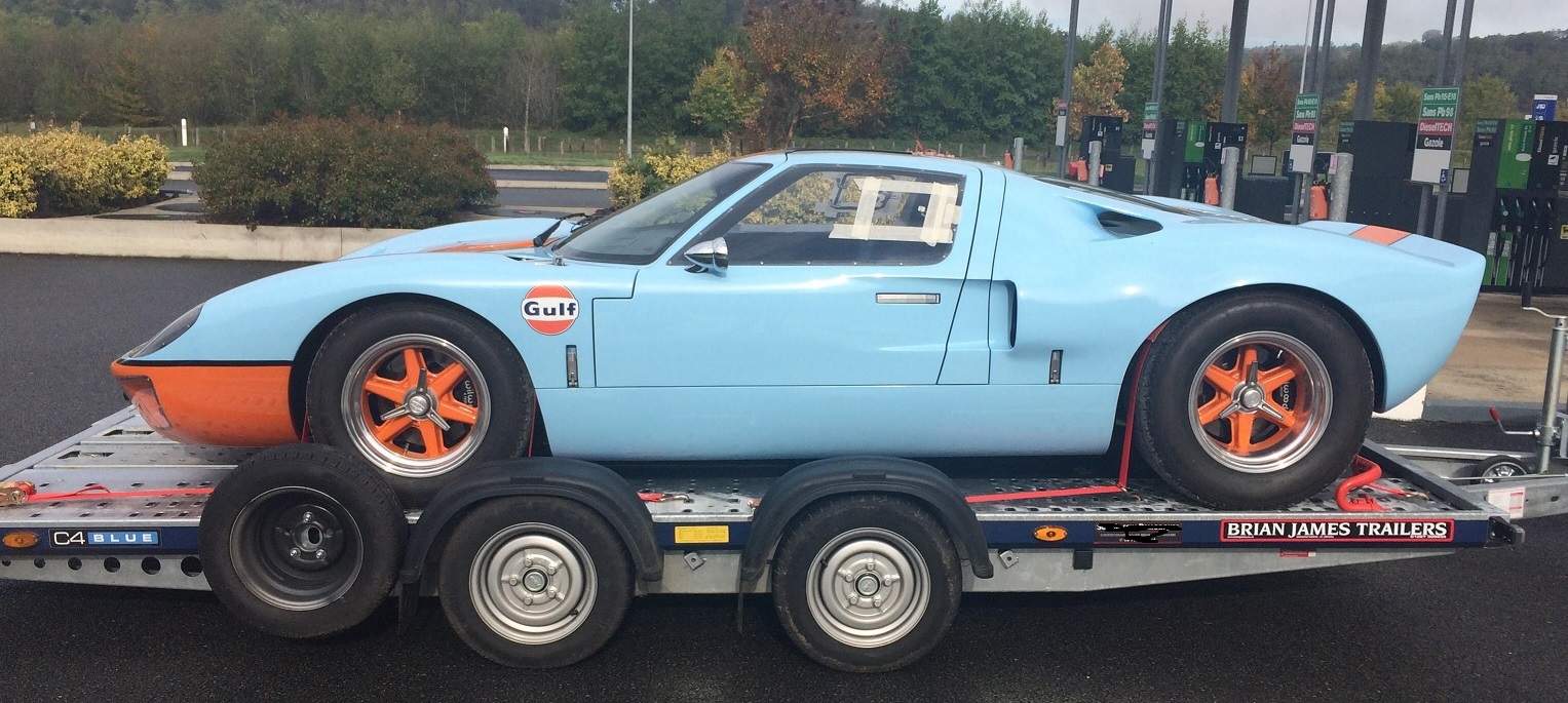

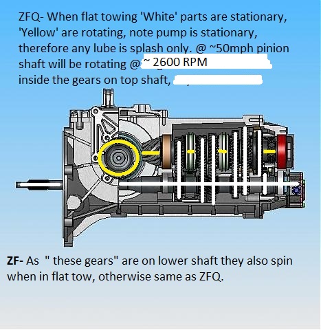

200 mile, yes we used to do that years ago, BUT given the transaxle is one of the single most expensive bits of the car and its not 'normal' for those gears to spin on those stationary shafts while in neutral for that length in time I think I would rather use a light car trailer, probably put the GT on backwards to ensure enough weight on tow bar.
Had an ugly scene at my road gate a week back where tow car got written off plus trailer and car on it damaged simply because of poor loading distribution.

been e-mailing all i could find about RBT/ZF transaxles for info. So far only heard from Dennis Olthoff. Quote "John, no problem doing that. I would use Bungee cord to tie the steering wheel in the straight position to stop any wobble Watch for stone damage. Cheers, Dennis? I will wait for more responses. have time to wait. Willow is not 'till next Mothers day weekend 2018. Thanks for that Dennis.

i asked Lloyd Butfoy" I have SPF GT40 Mk2 with RBT 5 spd. wonder if i can "flat tow"from Willow Springs race track to home,about 200 miles?"
Mr. Butfoys answer? "Yes. thank you"

Compared to the value of these cars, trailer rental is cheap. I hope you have very effective mud flaps. Put your face right behind the rear tires and see how it feels being sand blast with road debris. Yikes!

With all due respect, I think you're nuts for even considering this. Trailers are cheap, repairs to your GT40 most definitely are not.

well, considering that Lloyd Butfoy of RBT transaxles himself and Dennis Olthoff of Olthoff Racing says i can do this safely i feel sure that all will be good. and, i think they know more than you do. but i will go to U Haul and check the distance between fenders of the 2 wheel trailer against width of
the '40s rear fenders i'm thinking that the angle of the car backwards on the trailer the chin of the '40 will be dragging on the ground. just guessin, mind you. and dragging a full size trailer up there in case the car does breakdown just does'nt seem practical. i'll let all know. thanks, all for your concerns. really.

Again.....U Haul rents open trailers. Break the '40, go rent one, drop off when home. Problem solved.
