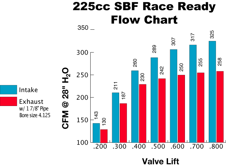

Interesting, not as much flow as a good aftermarket head. But, that is to be expected given all the input into recent designs and that this one is quite old, so, for the time really good. Attached are SB flow numbers for an AFR 225 style head - I'd say the today's comparison for a hot street/race head.

How many people are running these AFR heads with a 4.125 bore or a 17" extension? Most people dont realize these flow ratings mean very little in the real world. A stock 351c 4v head will flow big numbers and make very little real world HP. Air flow has to be balnced with air speed or velocity to give a real idea as to how much power a head will make over a broad power band. There are alot of better heads out there today than a Gurney-Weslake but most are of the Yates type. With the verticle intake runner these heads have a very high velocity rate which makes alot of power over a broad range. After all they did finish 2nd at Indy 2 years in a row and win Lemans and even a Can Am race. No doubt we have very good stuff available today and plenty of options for everybody.

I'll be running 4.125" here in a few months, with AFR heads. I know that the bench numbers don't translate into instant hp or real world results, but, we're comparing two sets of bench numbers here as far as I know and although conditions are slightly different you can get a ballpark idea. As you mentioned, there are a lot better heads out there these days than the Gurney-Weslake heads.
The head comparison ran over a series of articles in Mustle Mustangs and Fast Fords address flow numbers and HP figures for a range of heads. The AFR heads do fairly well against the comp. I do have a set of AFR 225's running on a 4.125 bore Dart block. See my site for info.
