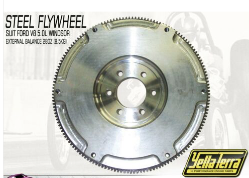

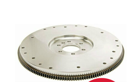

For reference a lightweight flywheel is about 8.5Kg. Pics attached show how mass is positioned affects rotational inertia.

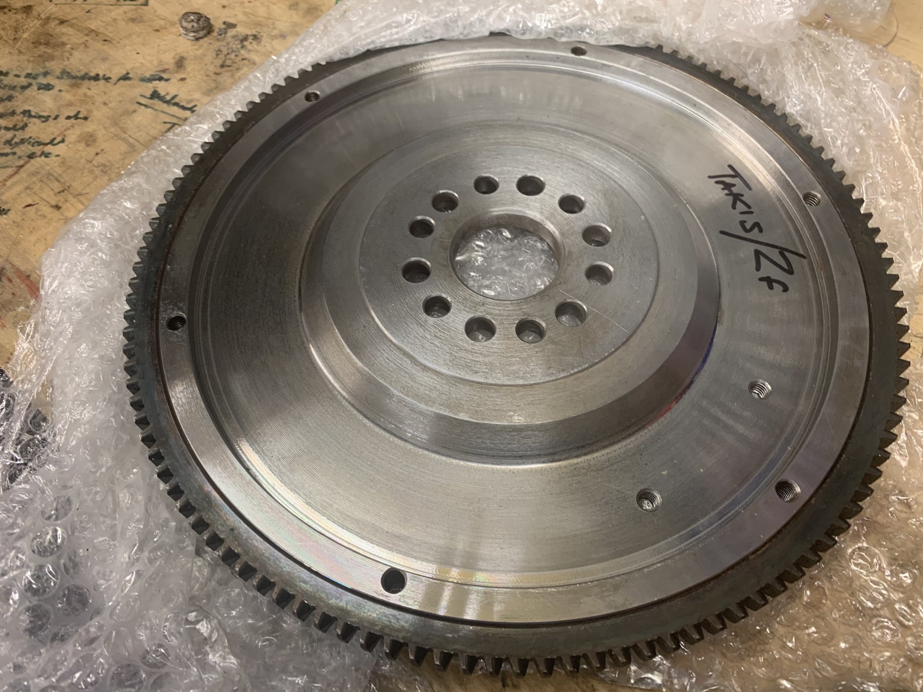

I have this flywheel for a ZFQ transaxle. It’s 8.5kg. Sound about right?

Thanks Mike.
I got it from a very trusted source. The query was only made last night when a buddy of mine who builds hot rodded Mustangs stopped by last night and commented that it was quite a bit heavier than the flywheels he uses on his 900+ hp monsters. I had no reason to doubt my supplier but was curious generally speaking.
Thanks again to all.
