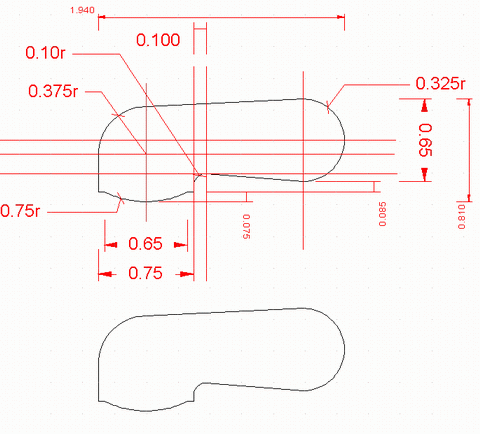

Alan, if you go back a few years, some of the forum members made their own mods to replicate the ones on the racing icons site, here:
You would need to get the wings laser cut, welded in and then replated

Brett -- I remember Lynn Miner went to a lot of trouble to do that. I'm just too lazy! I was hoping to attach my post to his thread but couldn't find it.
