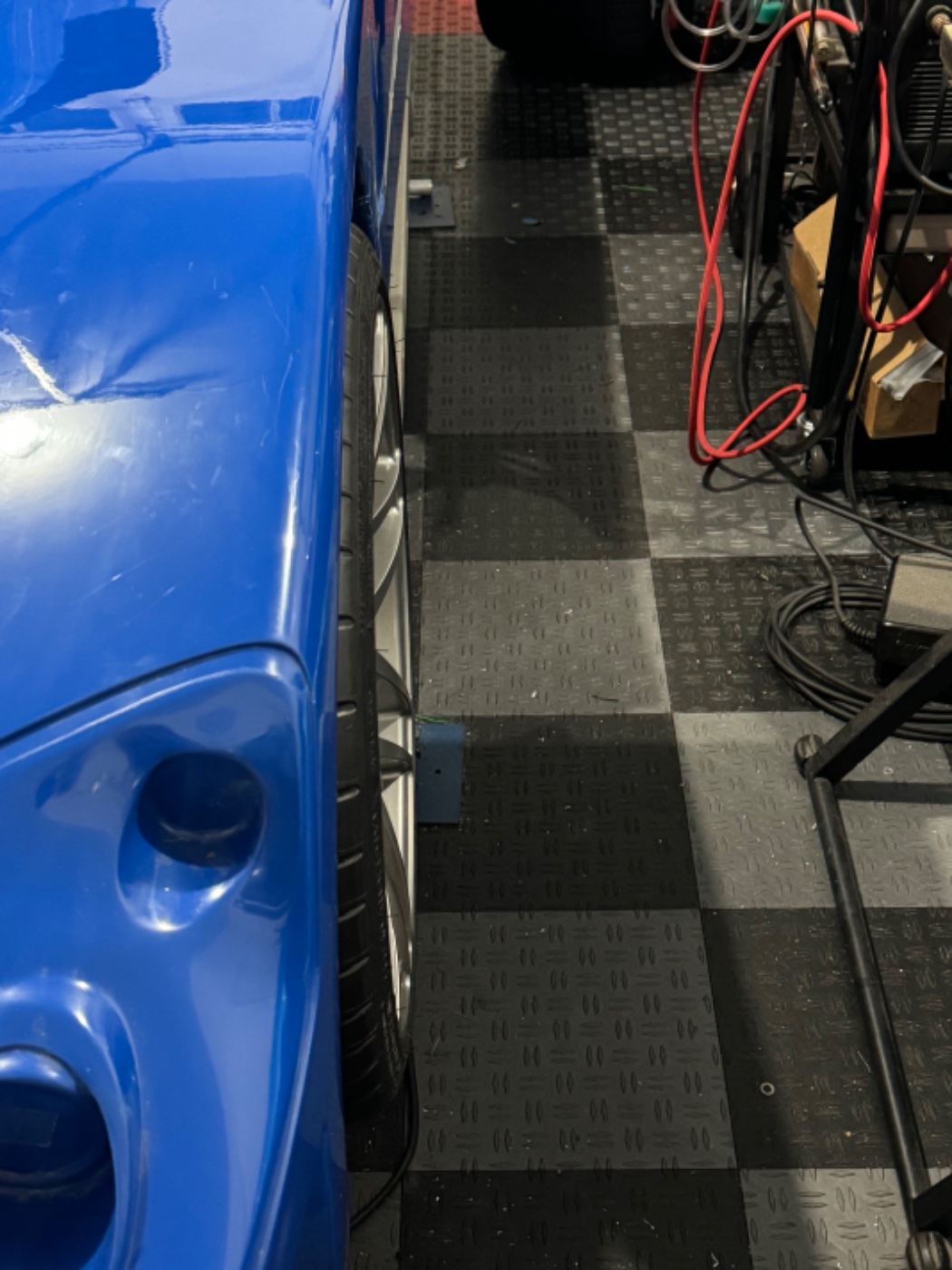

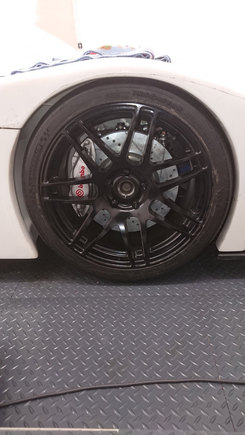

Joel,

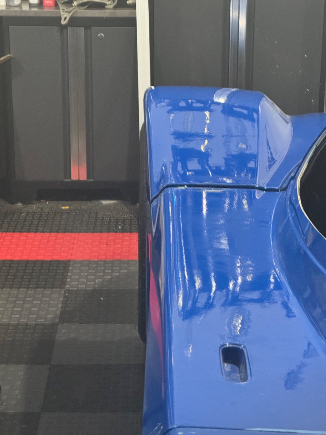

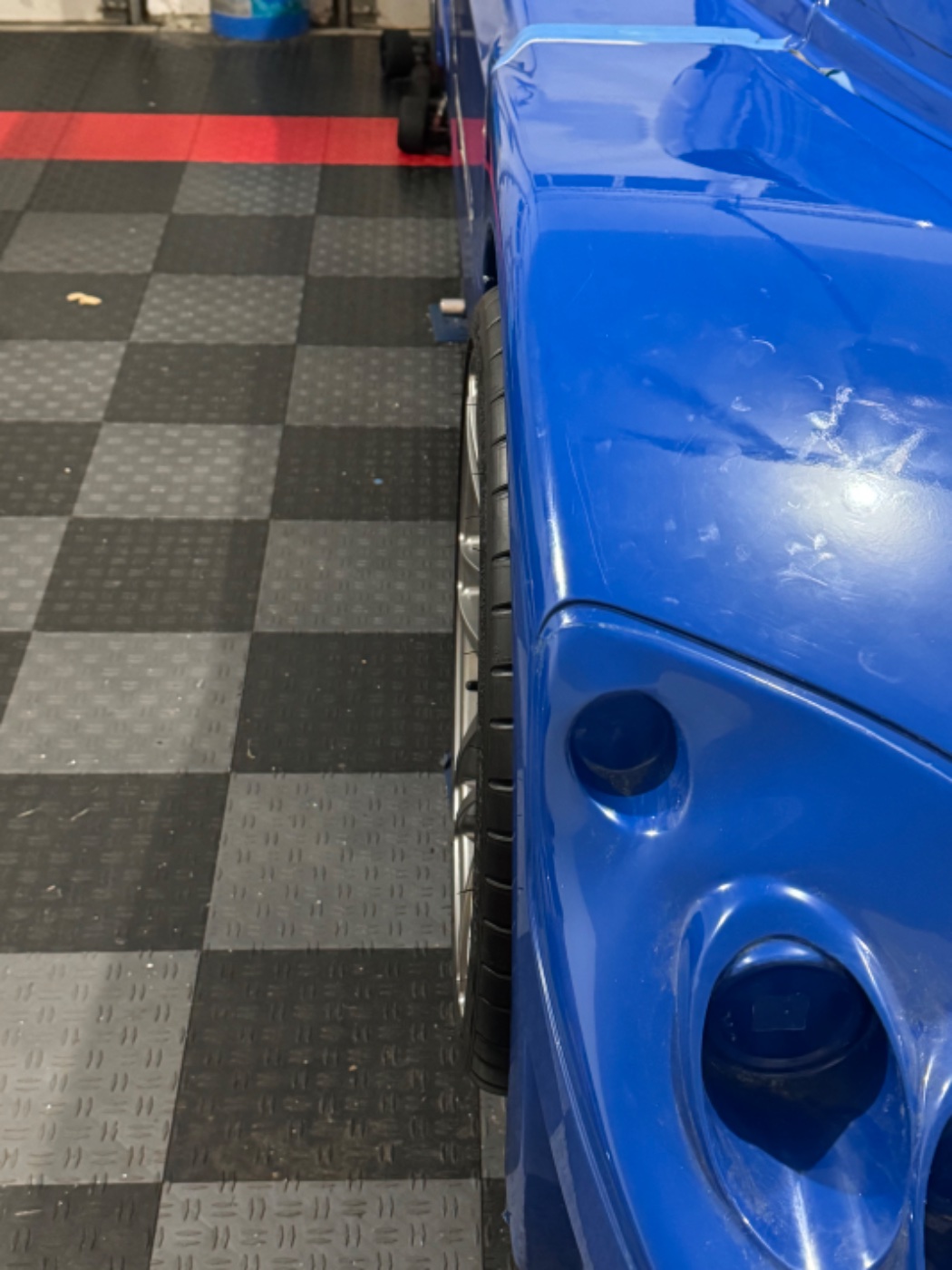

Thank you for those dimensions. Went out to the shop "after work" today and measured. My tires only stick out 1/4" from my rims (front and rear are the same) so I should be good. That is good to know!
This is with the -3 degrees of camber. I'll probably settle on around -1 degrees.

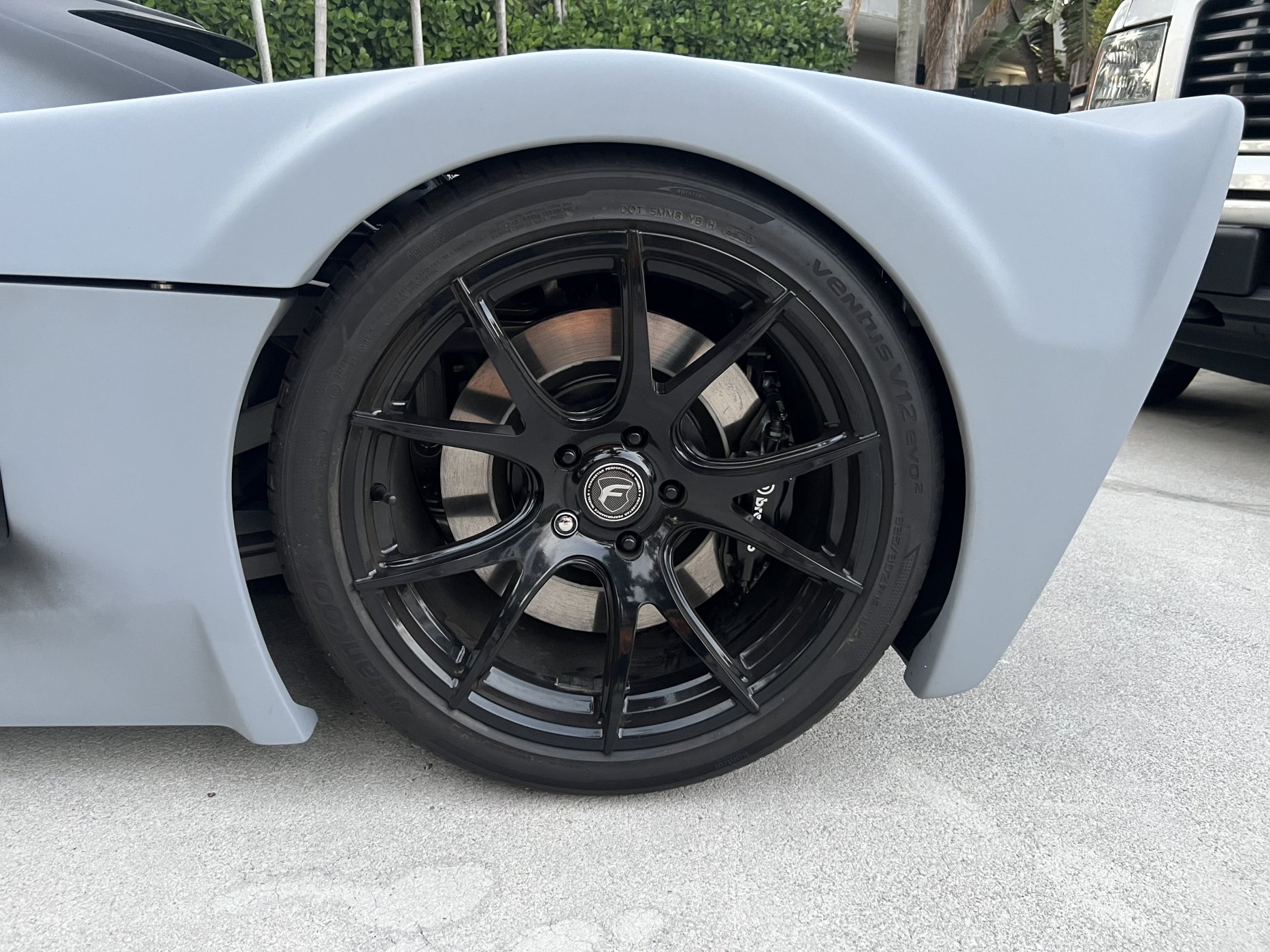

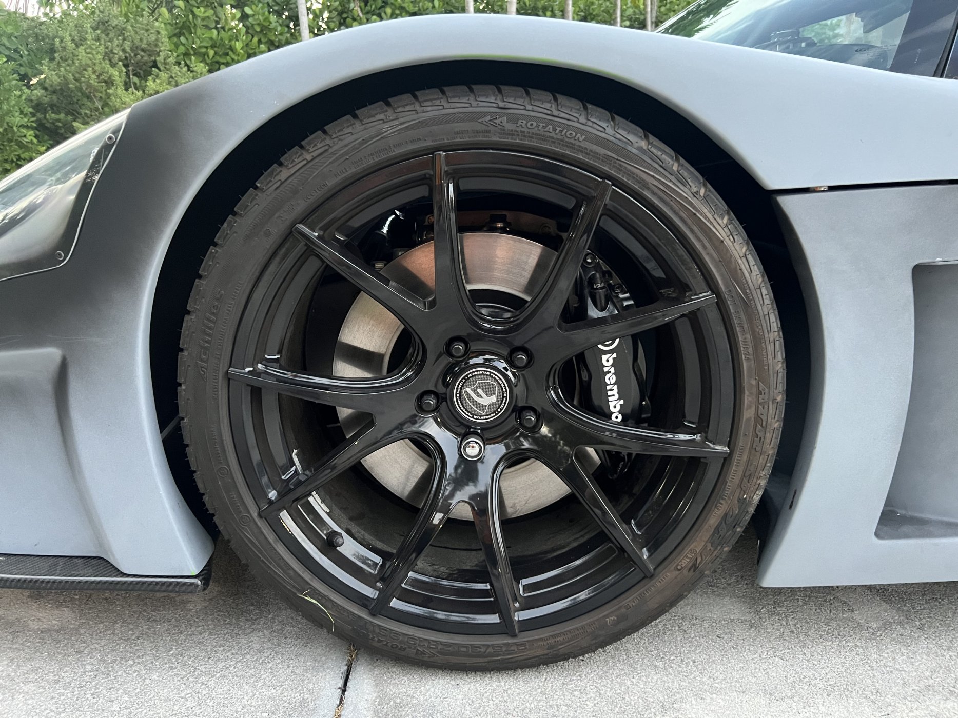

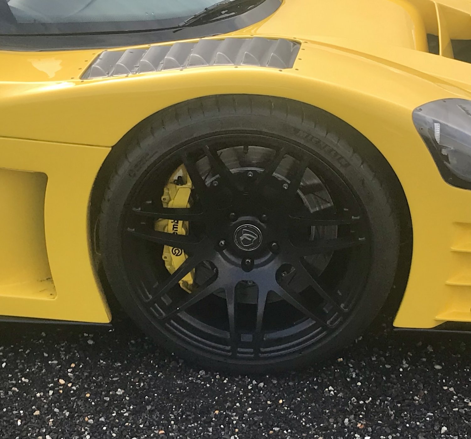

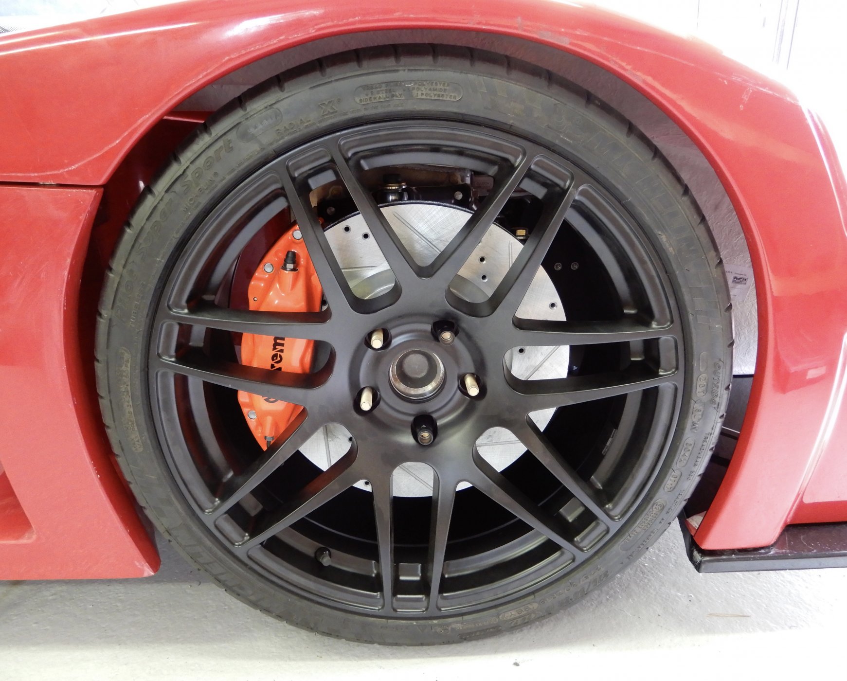

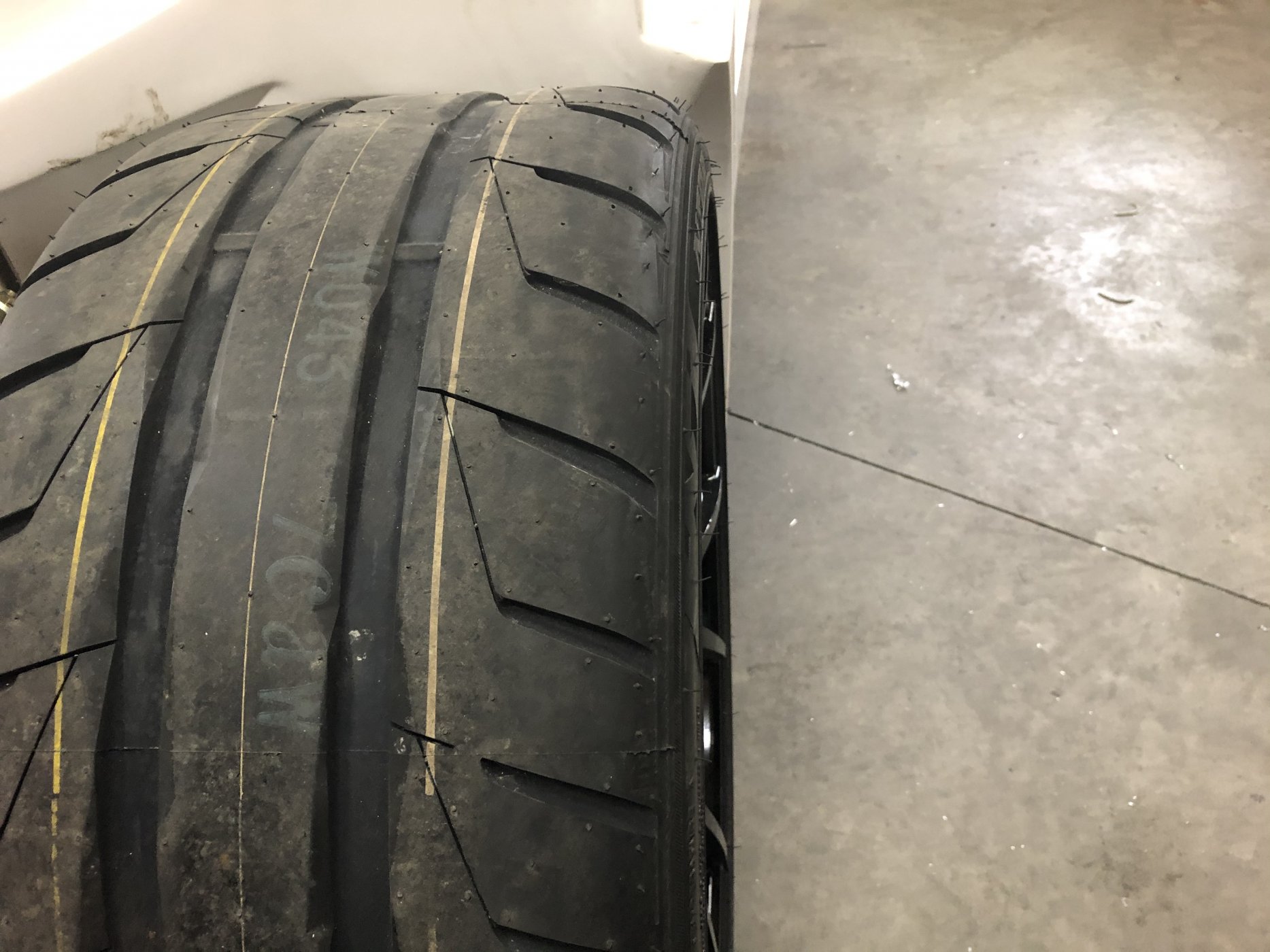

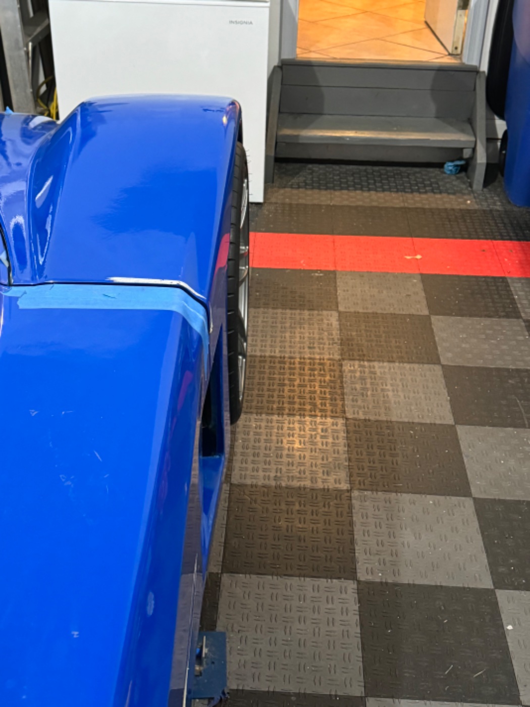

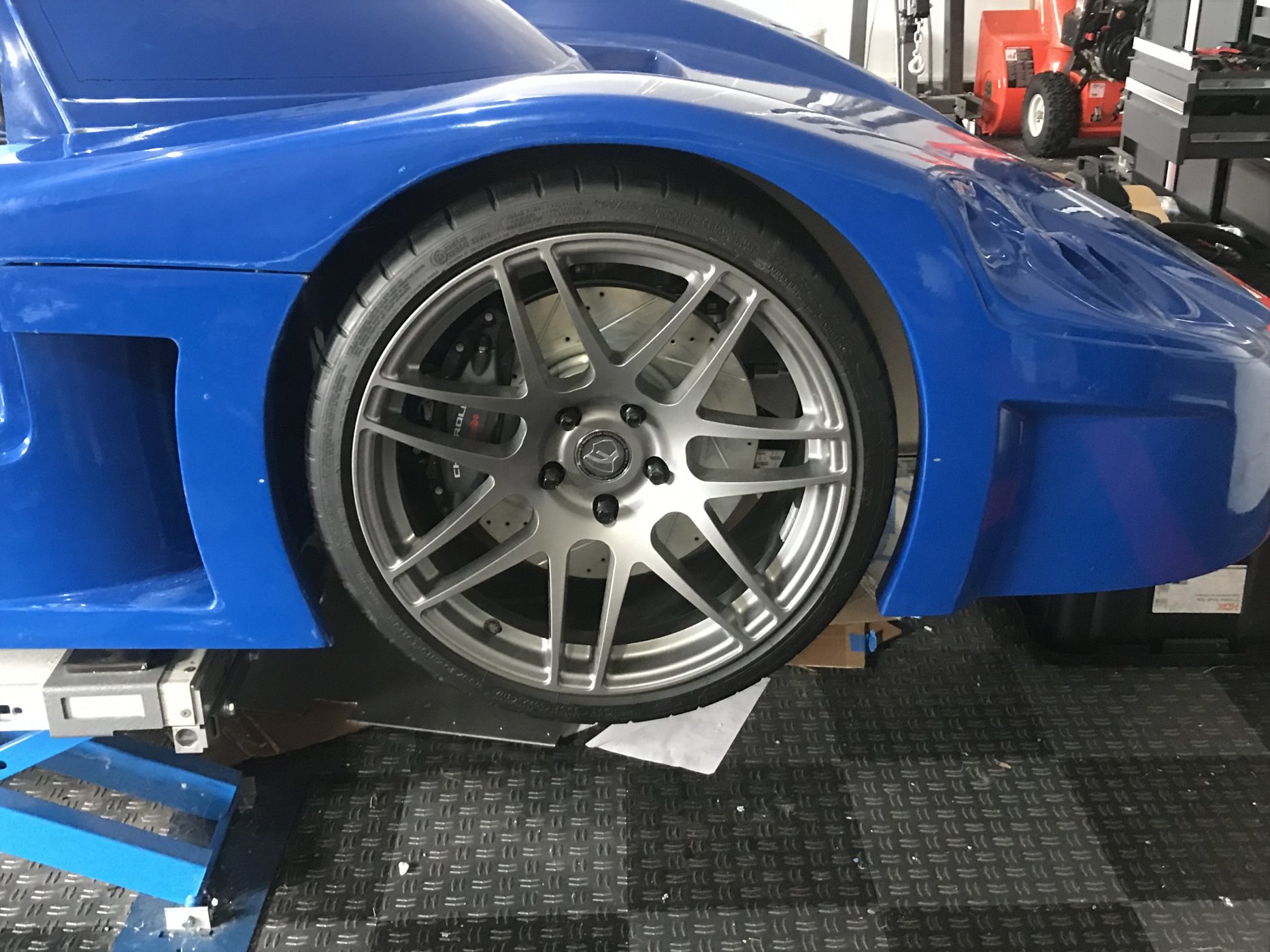

Here are some pics to compare. Turns out the 285s work on 10” wide rims but not on the 9.5 rims. so 265s will be right between mine(blue) and Johan’s car(Red).
275 on what I think are 9.5” rims…
255 on 9.5” rims…
Stephan’s car with 285s on 10” Rims…
Brian
