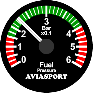

Ian Anderson
Why not run something like this?
so gauge fits inside the cabin and sensor only in fuel line?
