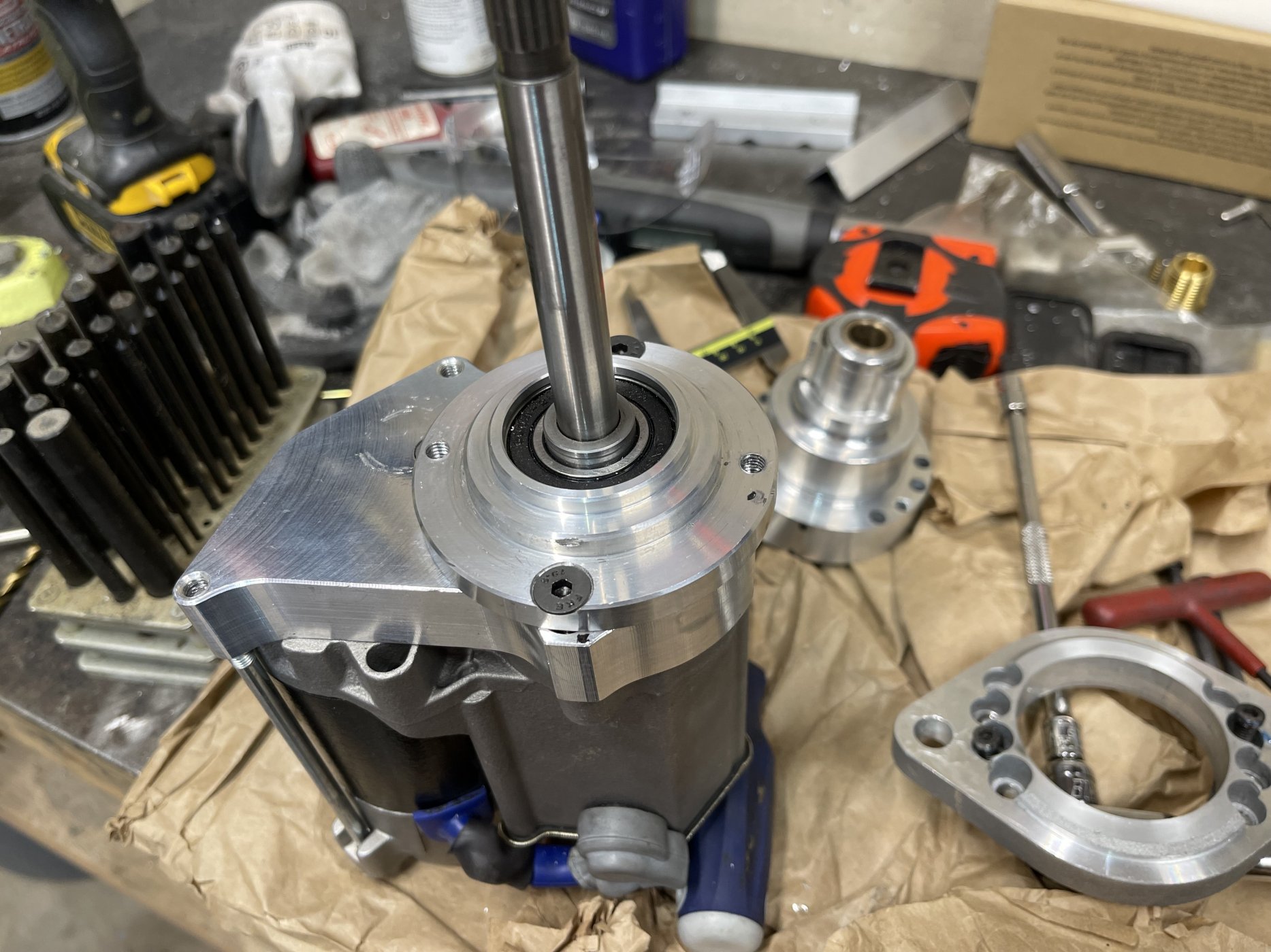

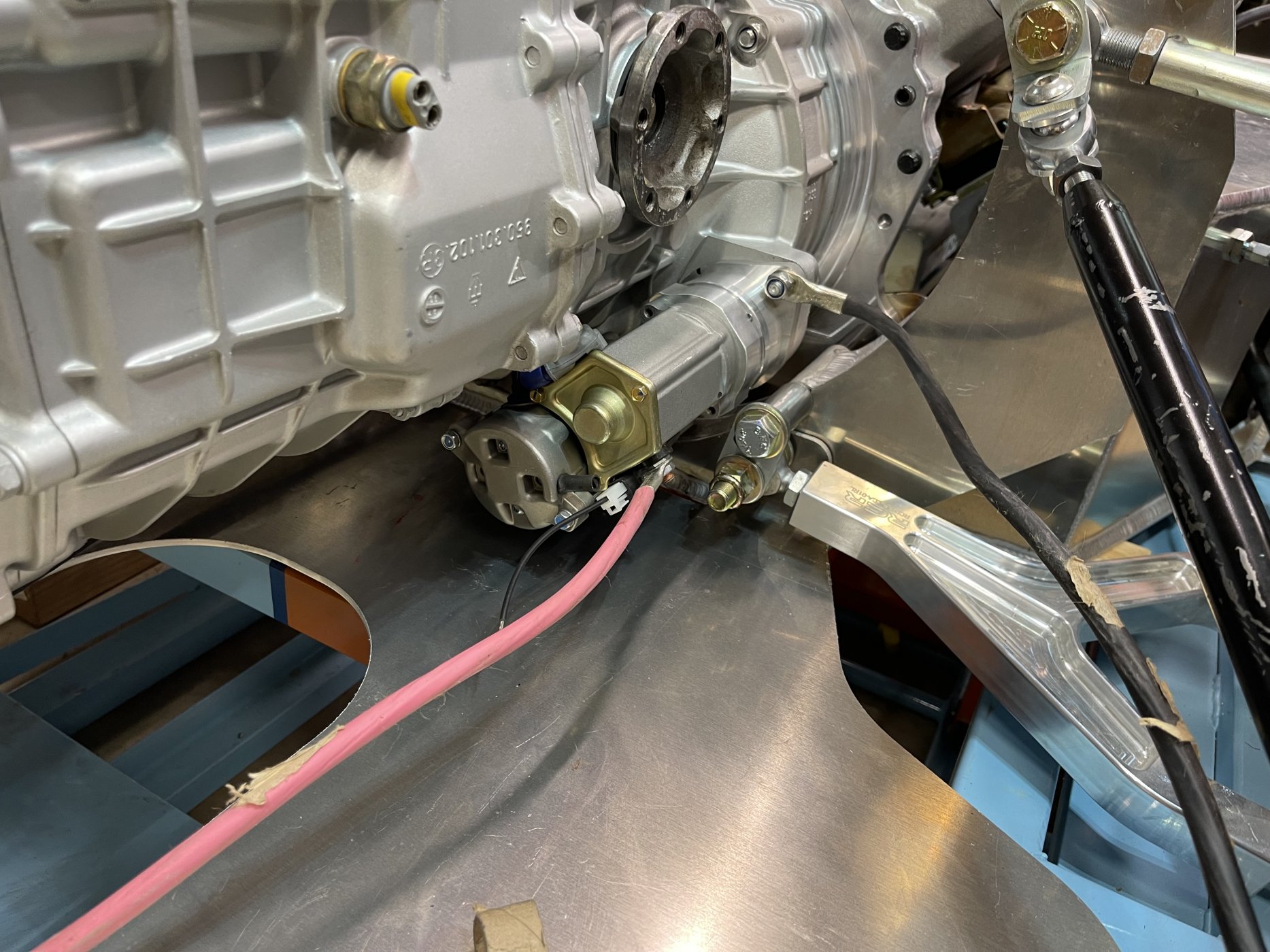

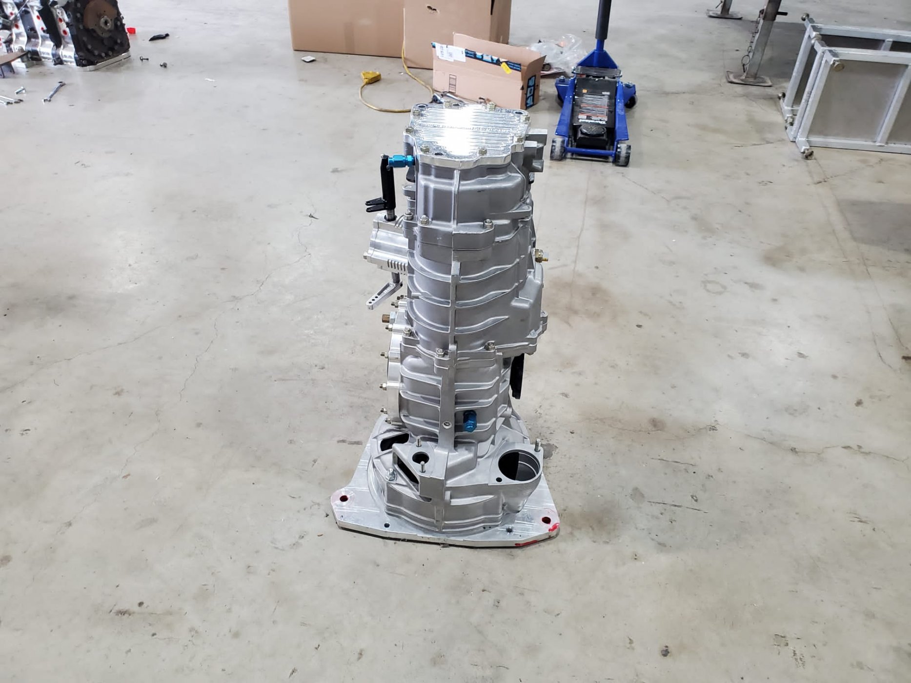

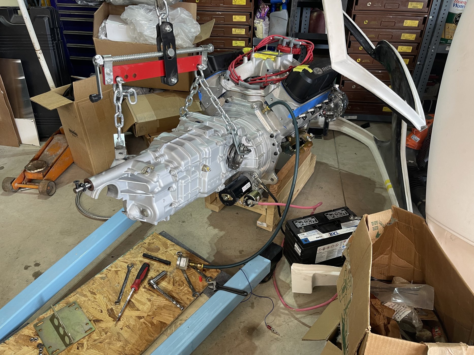

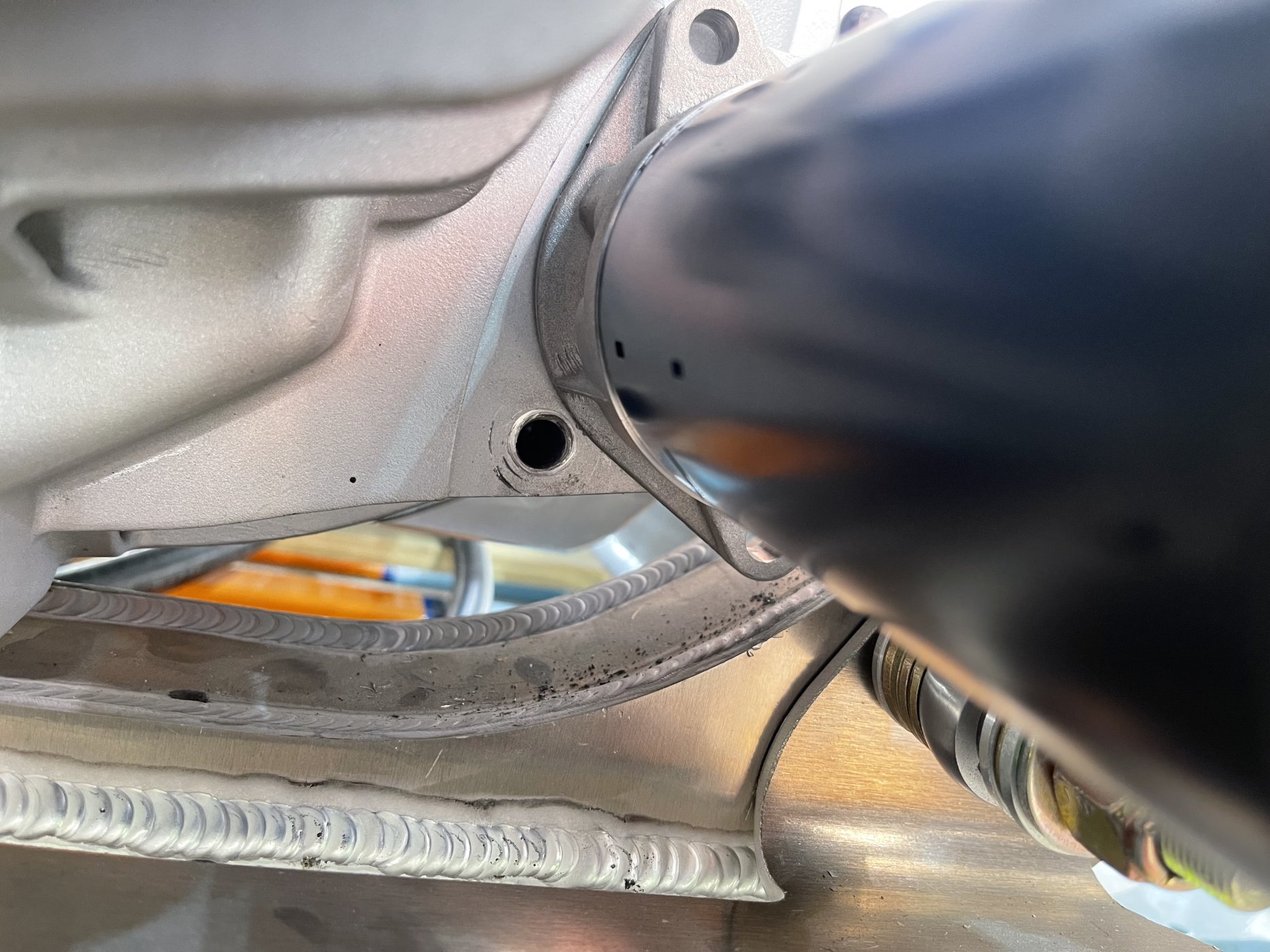

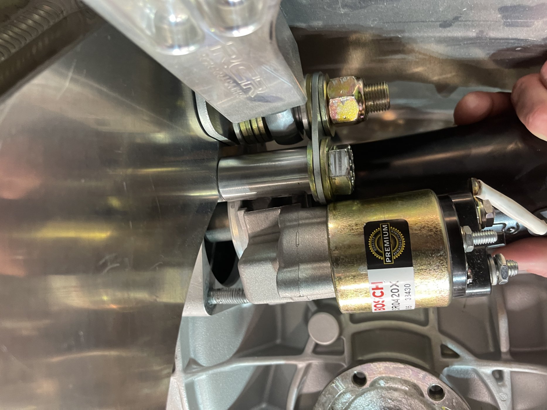

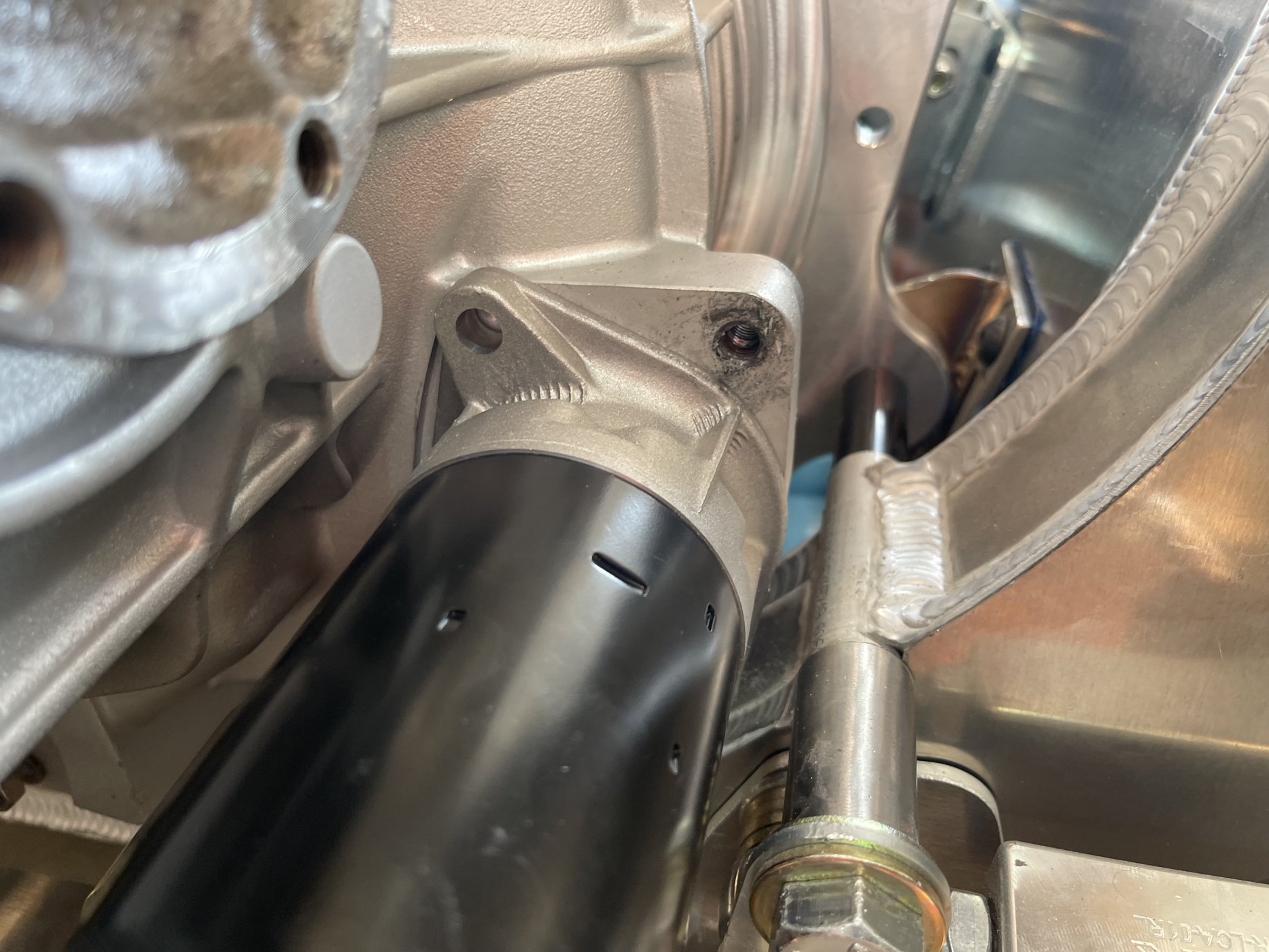

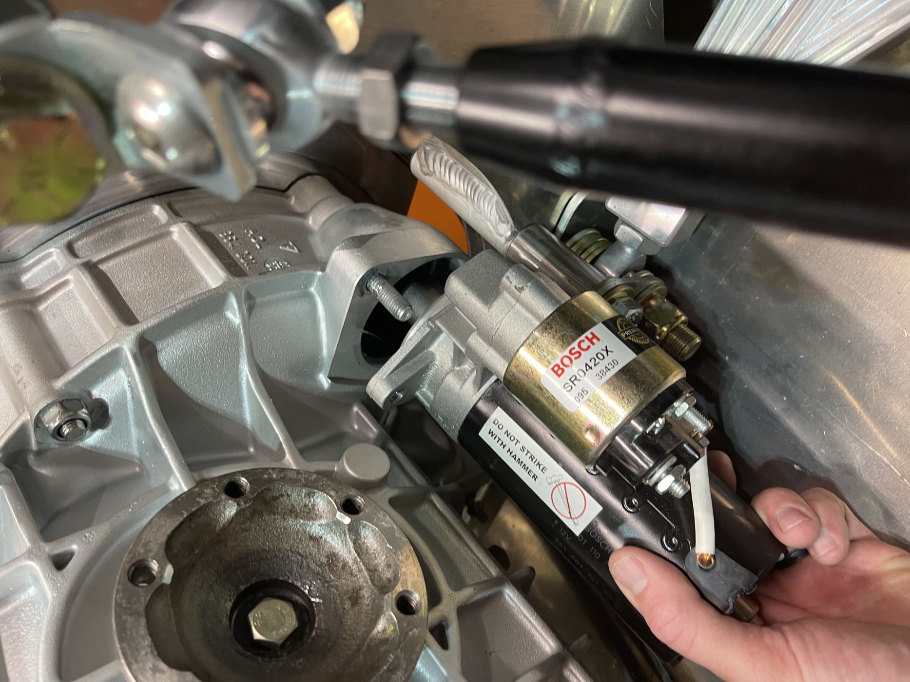

I haven’t installed the starter until this weekend. I had to pull the engine and trans to fit a couple things and install the clutch. While it was out I put in the starter and was happy it turned the engine over quickly in the correct direction.
I then found out while going back in that the solenoid hits the mounting bracket for the lower right wishbone.
I see others have had the same issue, but the starters they had were a lot different from mine and the posts were fairly old.
My question is, what are others running for these transmissions in a RCR-40?
I was told this G50/52 came out of a 91' 911 turbo. Not sure if there are different starters for different year models.
Sean

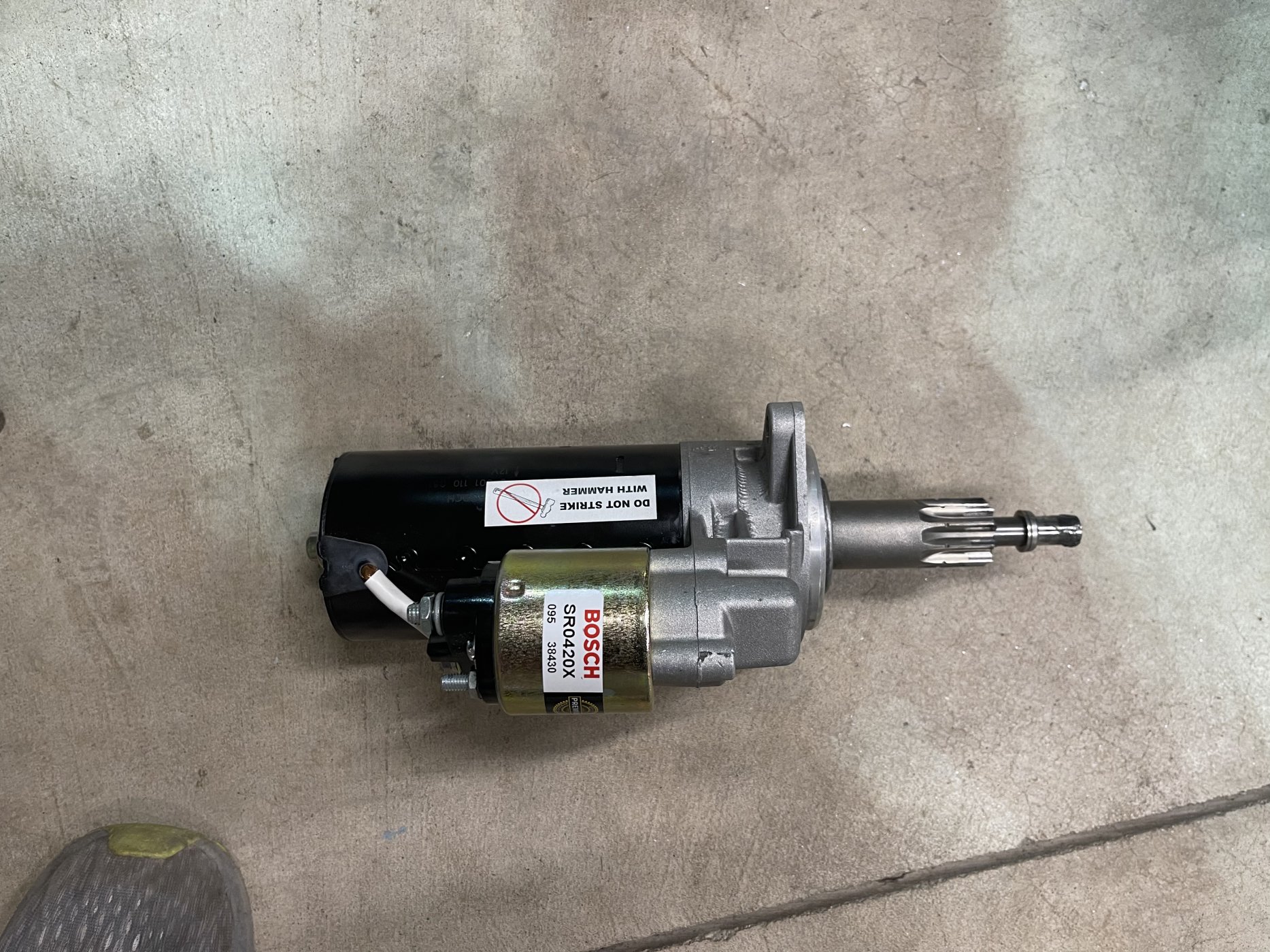

This is what I’m planning on running with my ‘92 g50/52 but it’s not an RCR chassis so probably not overly helpful to you. Looks like it’s the same starter just not Bosch.
Be interested to see what others use myself!

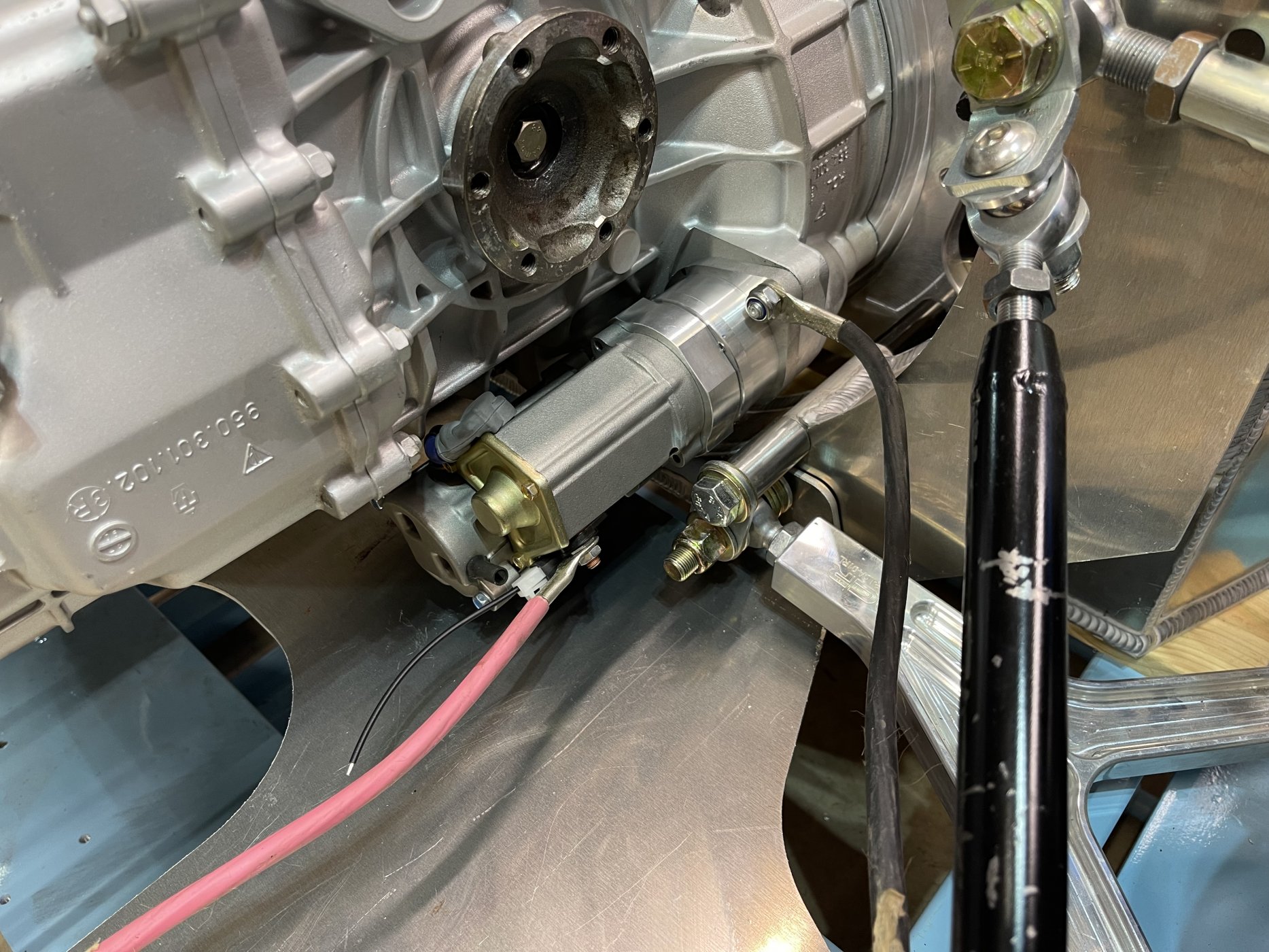

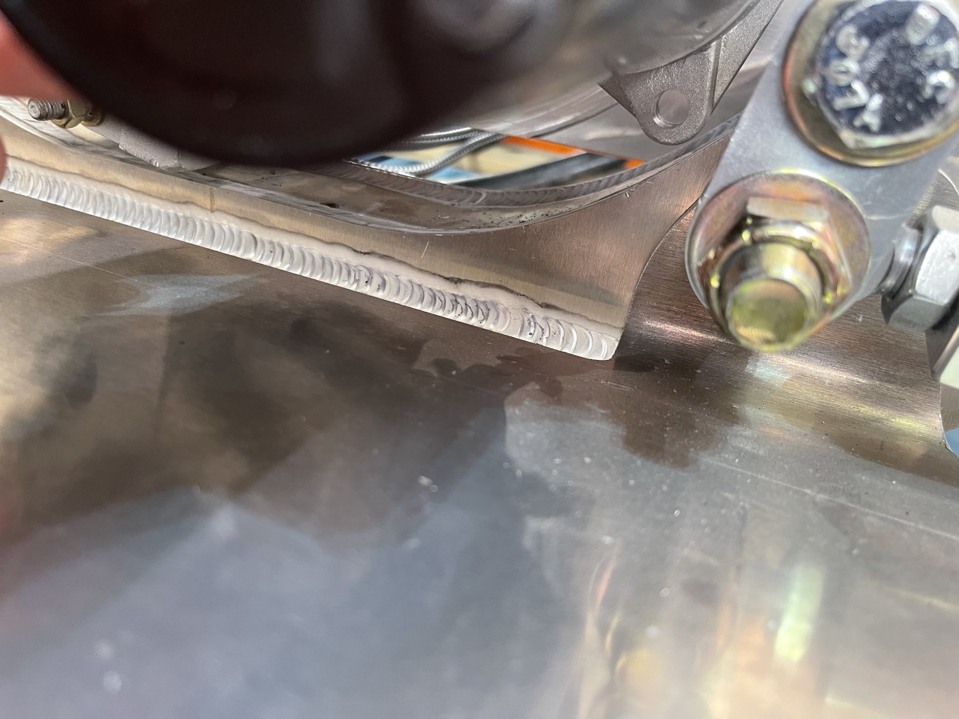

Take a look at my build site and you’ll see how I did it…
As I understand it now, RCR has (or had) starters that could be re-clocked..
I have this in my build site (widebody RCR40), but the HI Torque pn is IMI-101NL. Factory starters are not going to fit inside the RCR horseshoe.

Thanks Randy,
I did read about how you did this, very good design in my opinion. I think I could do it with a stock starter. Just curious what other options there are.

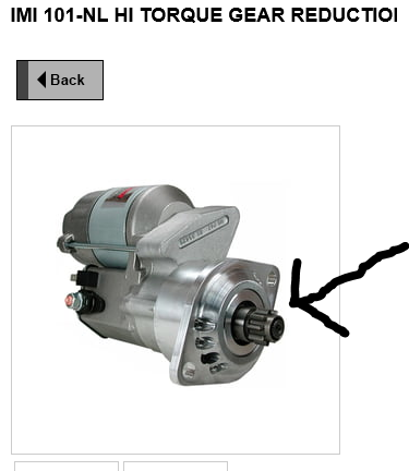

Hi Adam,
I read your build thread on this as well.

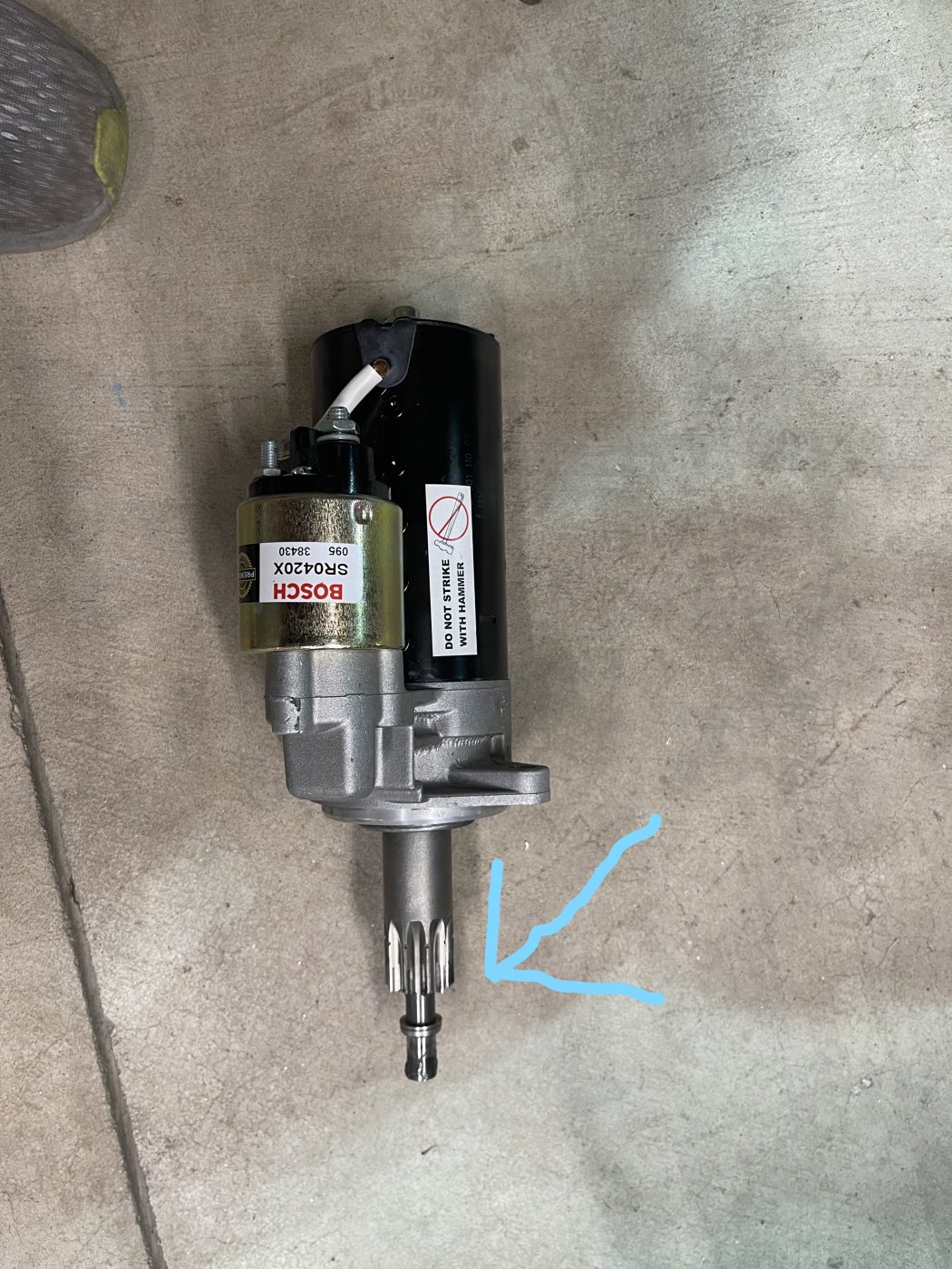

I'm curious if your starter (IMI-101NL) actually looks like the picture all the websites have for it.
Mine has a very long pinion that fits into a bushing on the bell housing. Im thinking that starter might not work for me, but I am unsure.
Thanks,
Sean

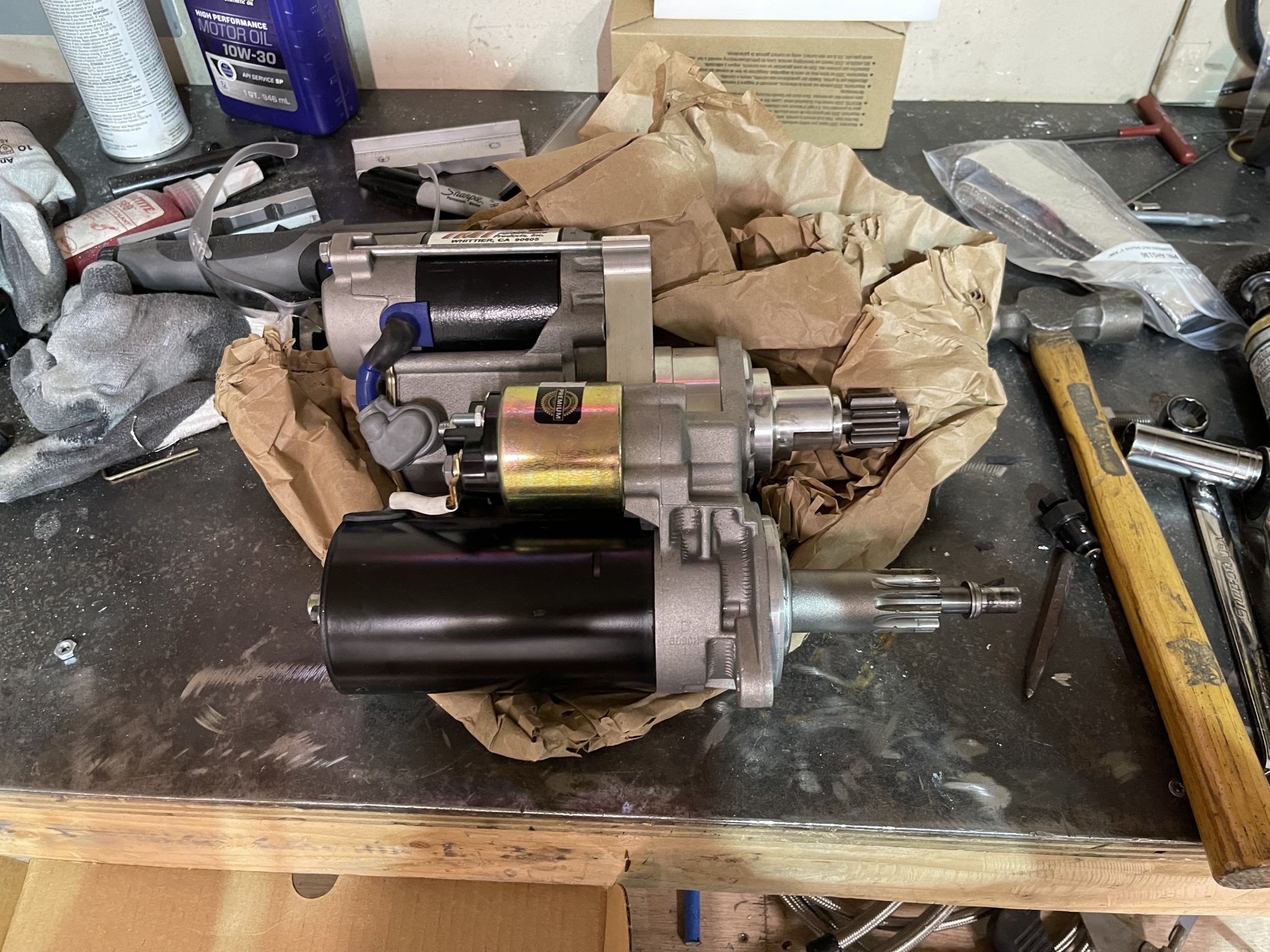

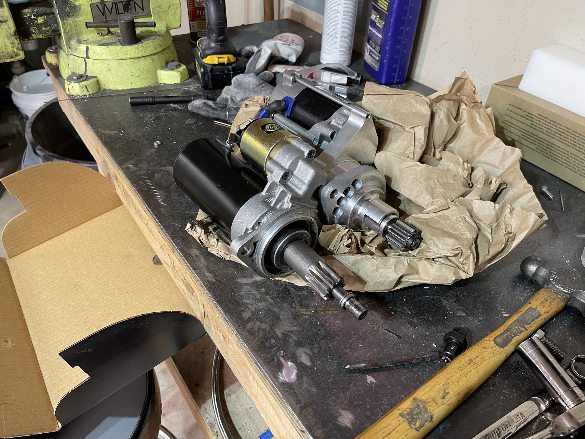

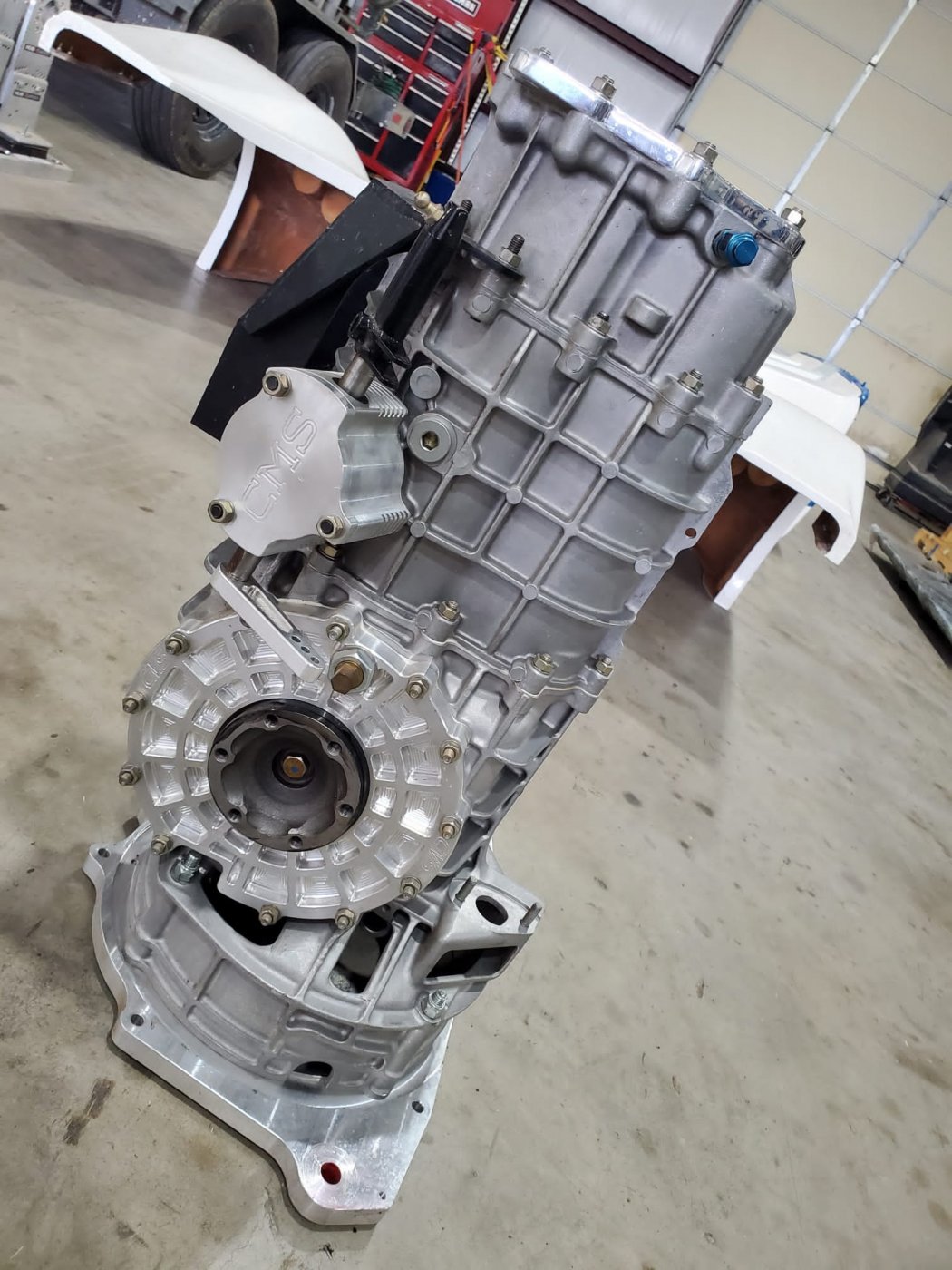

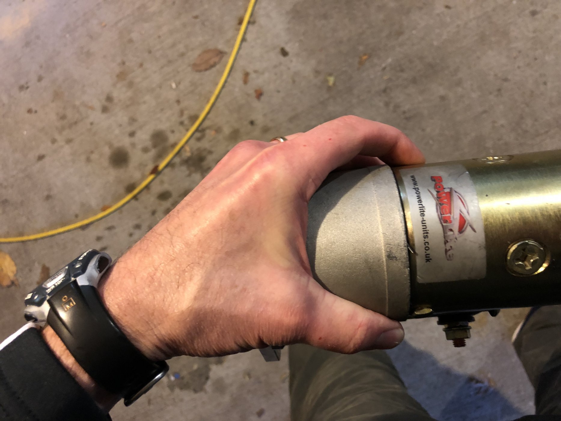

no idea if this piece will work in yours, but space is tight in my chassis and the clocking is crucial. It's a Powerlite starter, but the guts are Nippon Denso heavy duty. I have a g96-97, which is similar to a G50/52

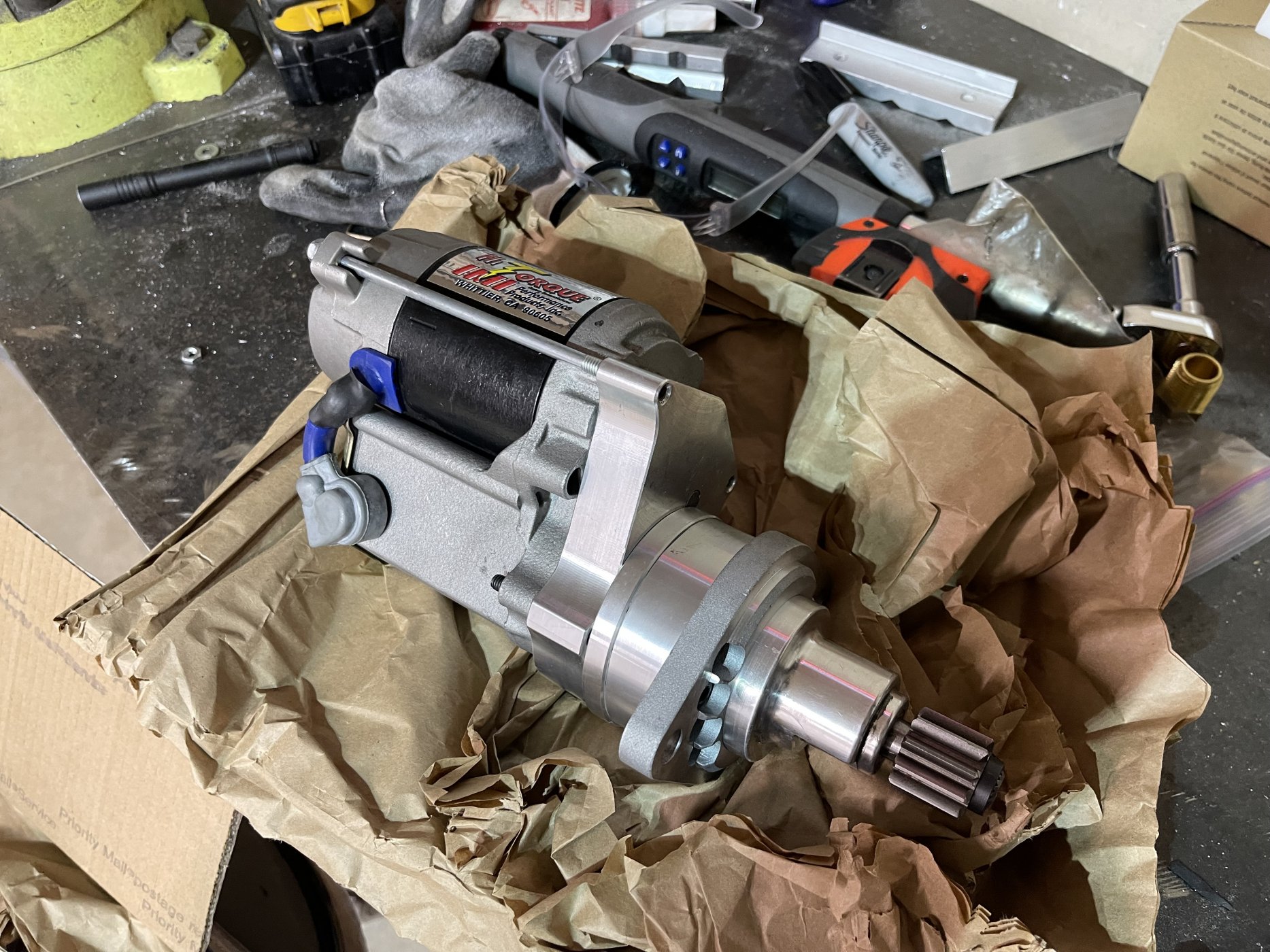

Sean S.

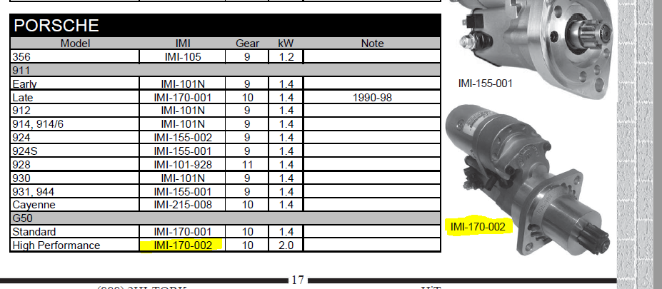

After hours of searching. I might have come up with some options. It seems IMI (HiTorque) has a couple to choose from, I am awaiting confirmation as to fit and availability.
I am also waiting to hear back from RCR and Kennedy.

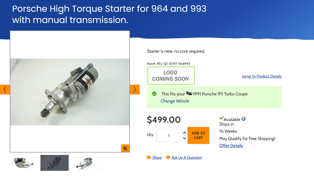

The IMI-170-002 looks to be correct with the long nose. But I cant find anyone that has them to check pricing.
Pelican has one that should fit this car and it looks pretty close to the imi-170-001 which should work, but they are proud of it.
  • IMI Performacne Catalog (1).pdf
Sean S.

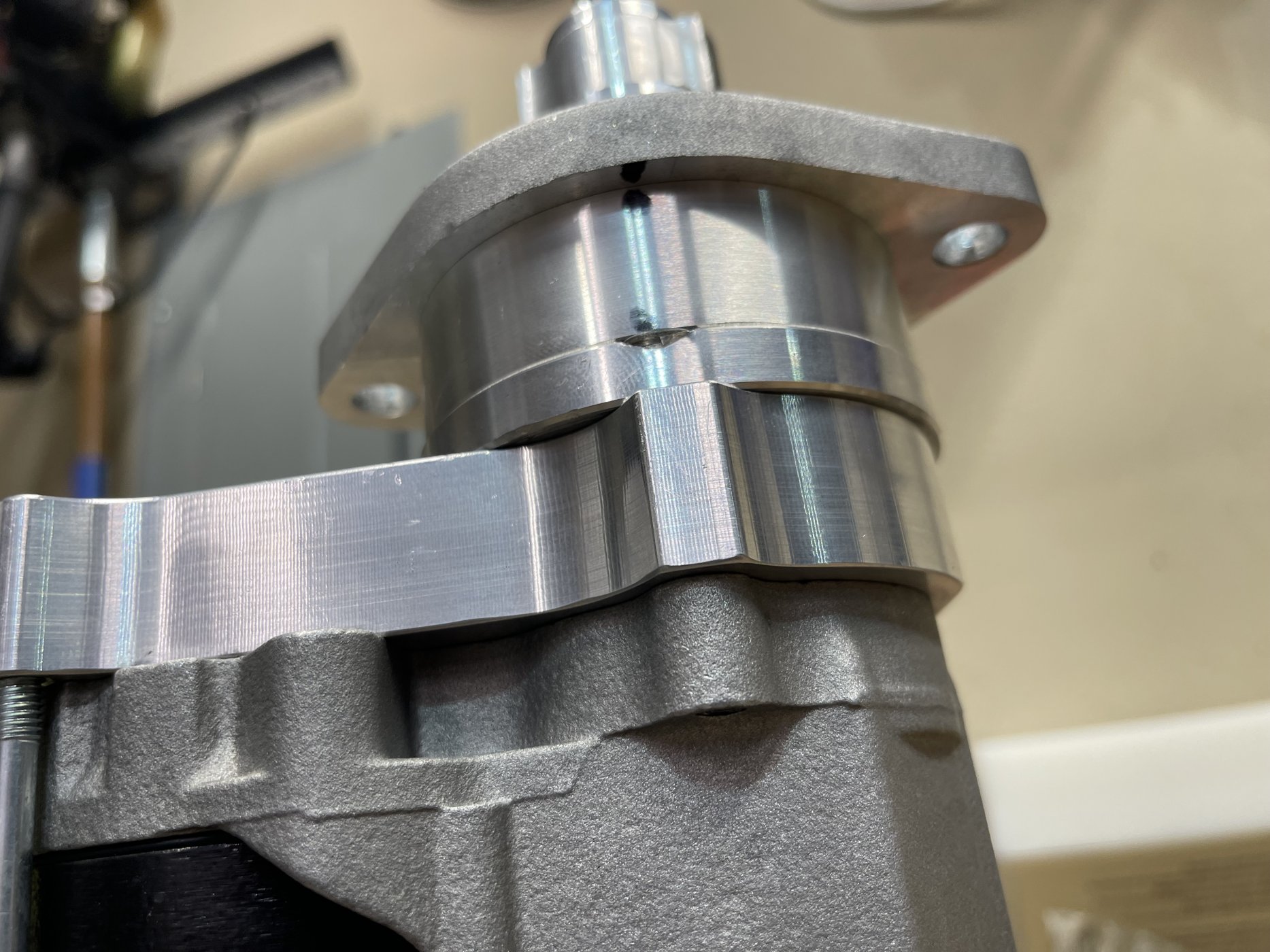

I finally got a starter that works.

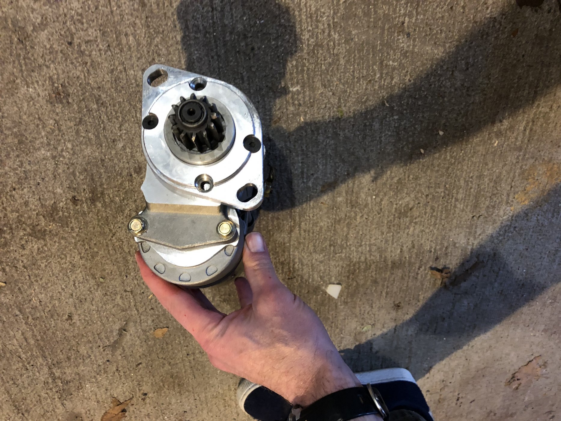

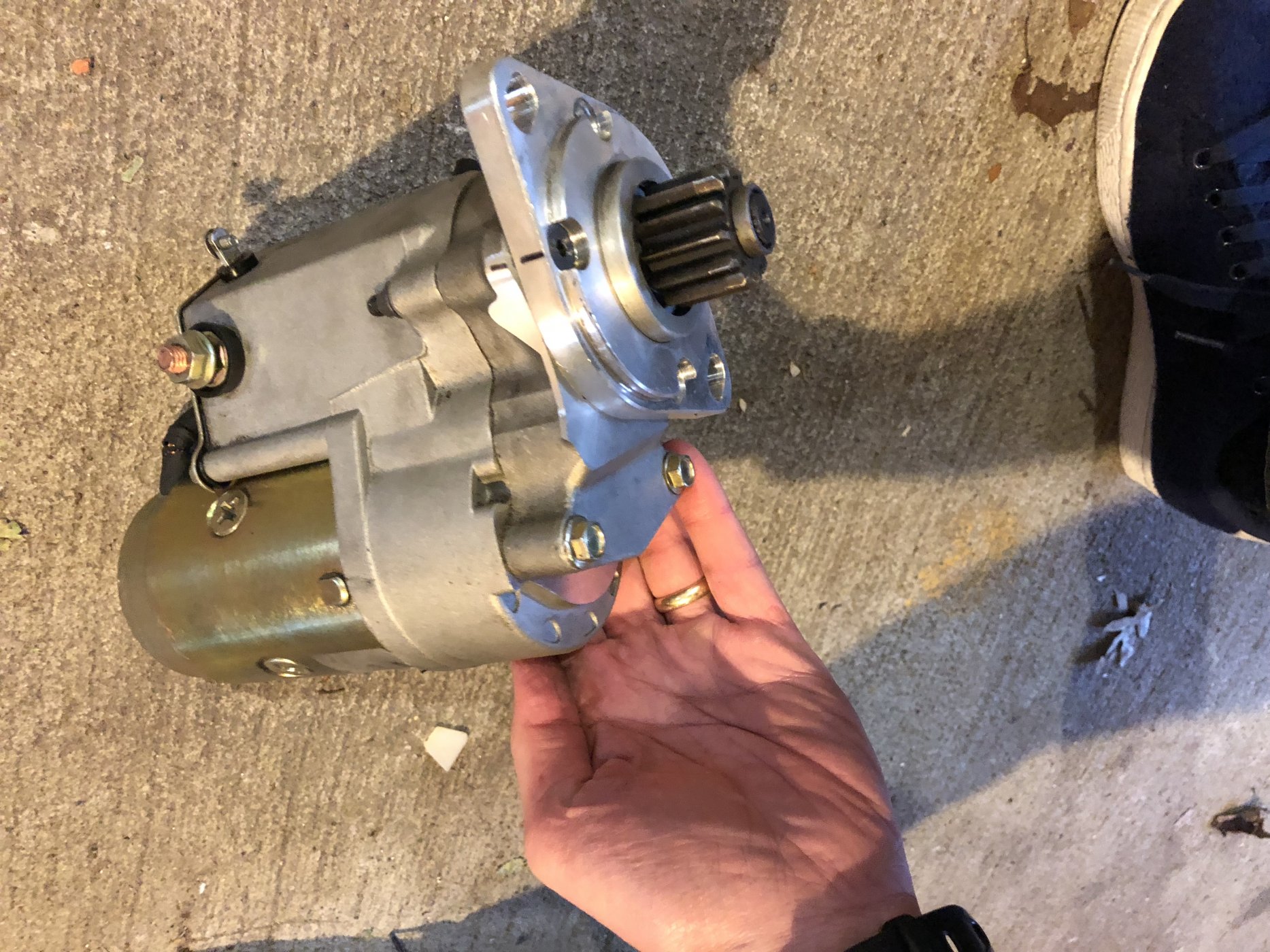

I ordered Hi Torque's 170-001 after talking a bit with Chris from Hi Torque we determined it will fit on my transmission. Unfortunately when I received it, I found it could only be indexed to 4 positions. Those positions didn't help me much. The good news is that it gave me something I could work with.
I changed how the nose cone mounted by counter sinking the original holes that mount the spacer to the starter motor. Then I rotated the nose cone and mounts to a position that worked for me. I drilled and tapped new holes, now it fits and works perfectly.

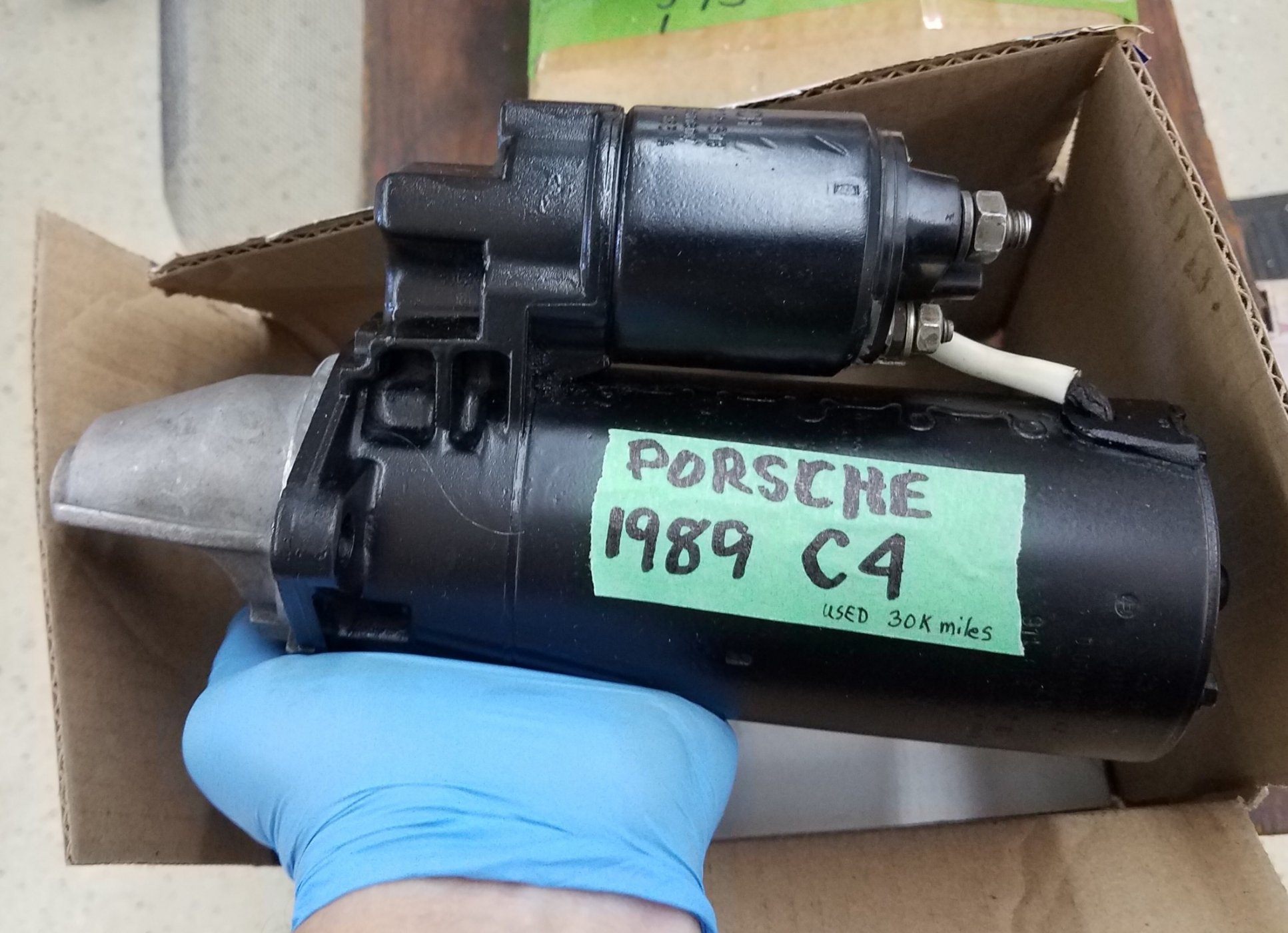

Nice looking starter Sean! I wish that option would’ve been available when I built my car. Unfortunately, no one gave a heads up that the Factory Porsche starter would not work! I still have a very low mileage 1989 Porsche C4 starter in one of my spare parts bins. It was not cheap to buy as I gave more than $200 for it…
Make sure you test it for engagement before you get too far Along!
